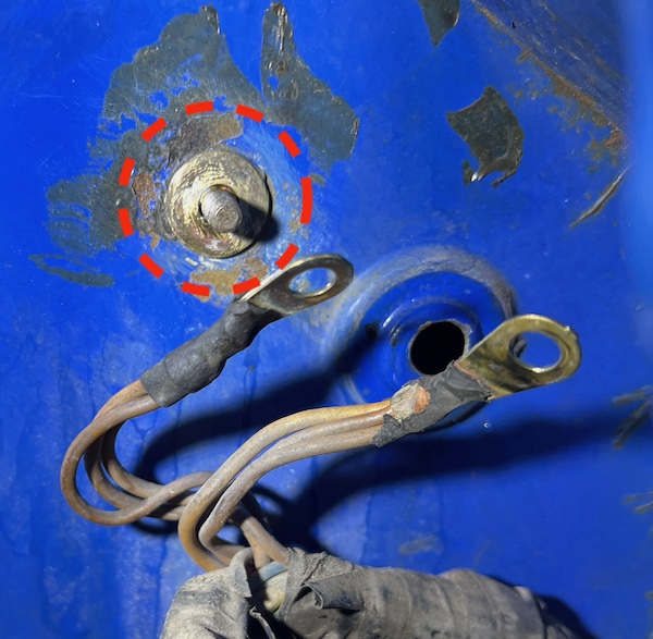

Would I be correct in thinking that the metal disk where ground studs are located should be bare metal?
The one in this photo is above the relay board in the engine bay. It was painted body color and I stripped it with a wire brush. I just can't imagine that thick disk behind the stud was meant to be covered in paint if that is a ground location.
P.S. After tightening these connections, is it good practice to coat them in dielectric grease?

Yes they need bare metal. The grease can't hurt
