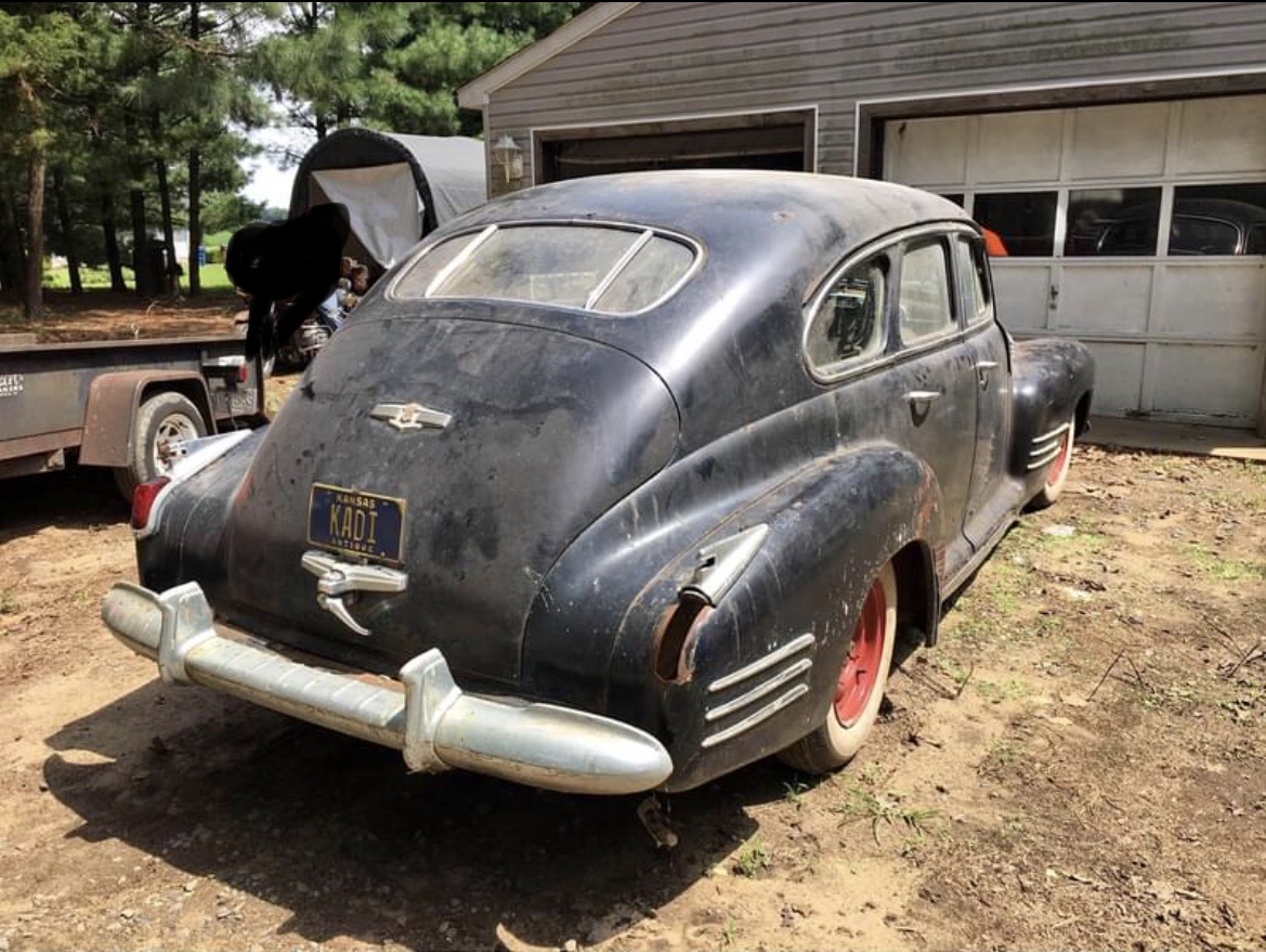

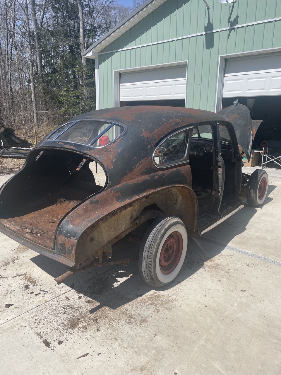

So here’s my next project now that the Safari 914 is done. I don’t anticipate getting into it until fall/winter, but I now have the base for the project. It’s a 1941 Cadillac series 61 that I plan to put on a modern Escalade platform.
If there’s interest I’ll update this as a project thread. I realize this is far from the intended scope of this forum, and if there’s no interest I’ll not fudge up the forum with this non-914 project. But if there’s interest, I’ll post progress once I dig in.

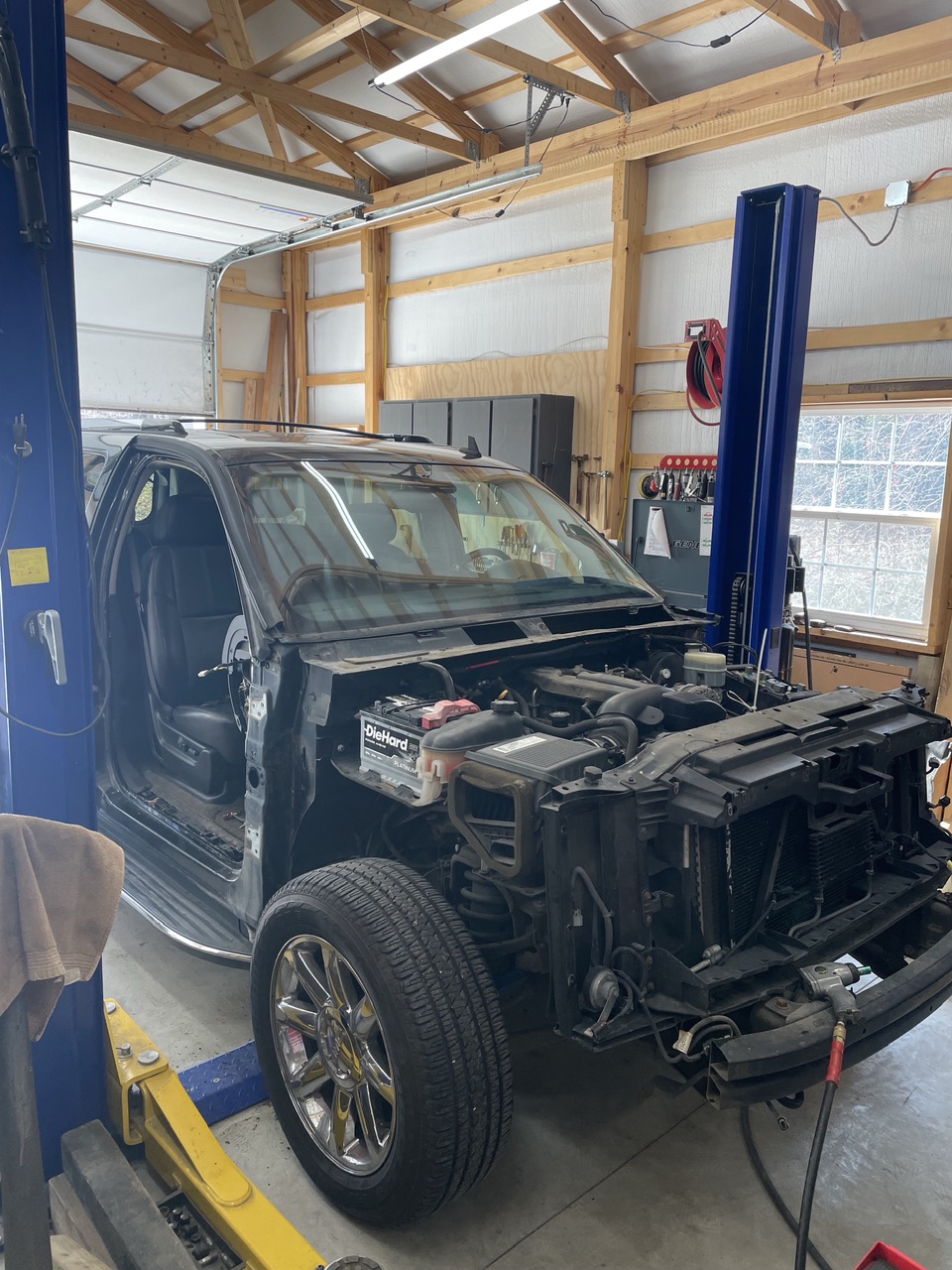

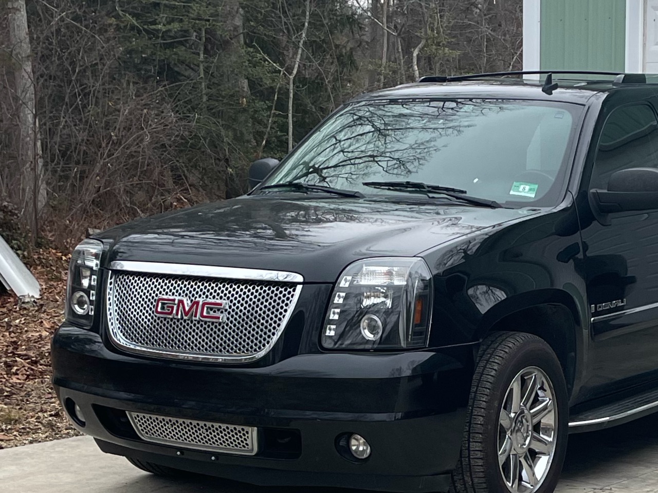

I picked up the “donor” for this project. It’s a 2008 GMC Yukon Denali. It’s got a good drivetrain, with a 6.2 non-DOD engine and AWD transfer case. I’m going to use the floor pan and firewall from the Yukon and graft the Cadillac body onto it. The Yukon is in decent shape and I drove it quite a bit until it’s 30 day temp tag expired.
That doesn’t sound too difficult but there will be many challenges!
Here’s my donor:

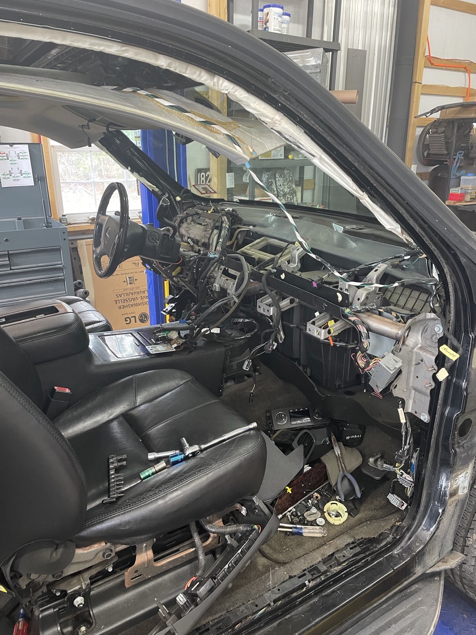

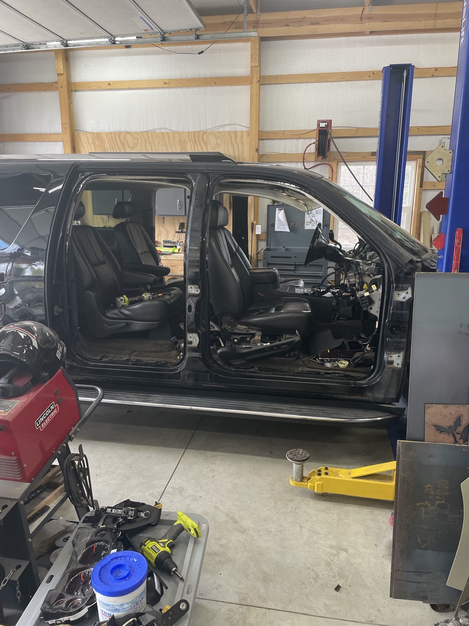

The last couple days I’ve been deconstructing the Yukon. After removing 5 gazillion screws, bolts, nuts, clips, and bloodying all 10 knuckles it’s starting to get down to its bones.
Click to view attachment Click to view attachmentClick to view attachment

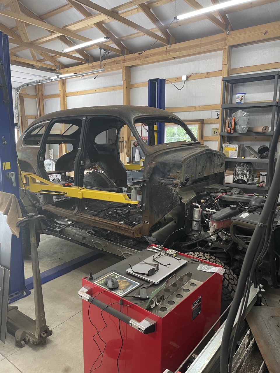

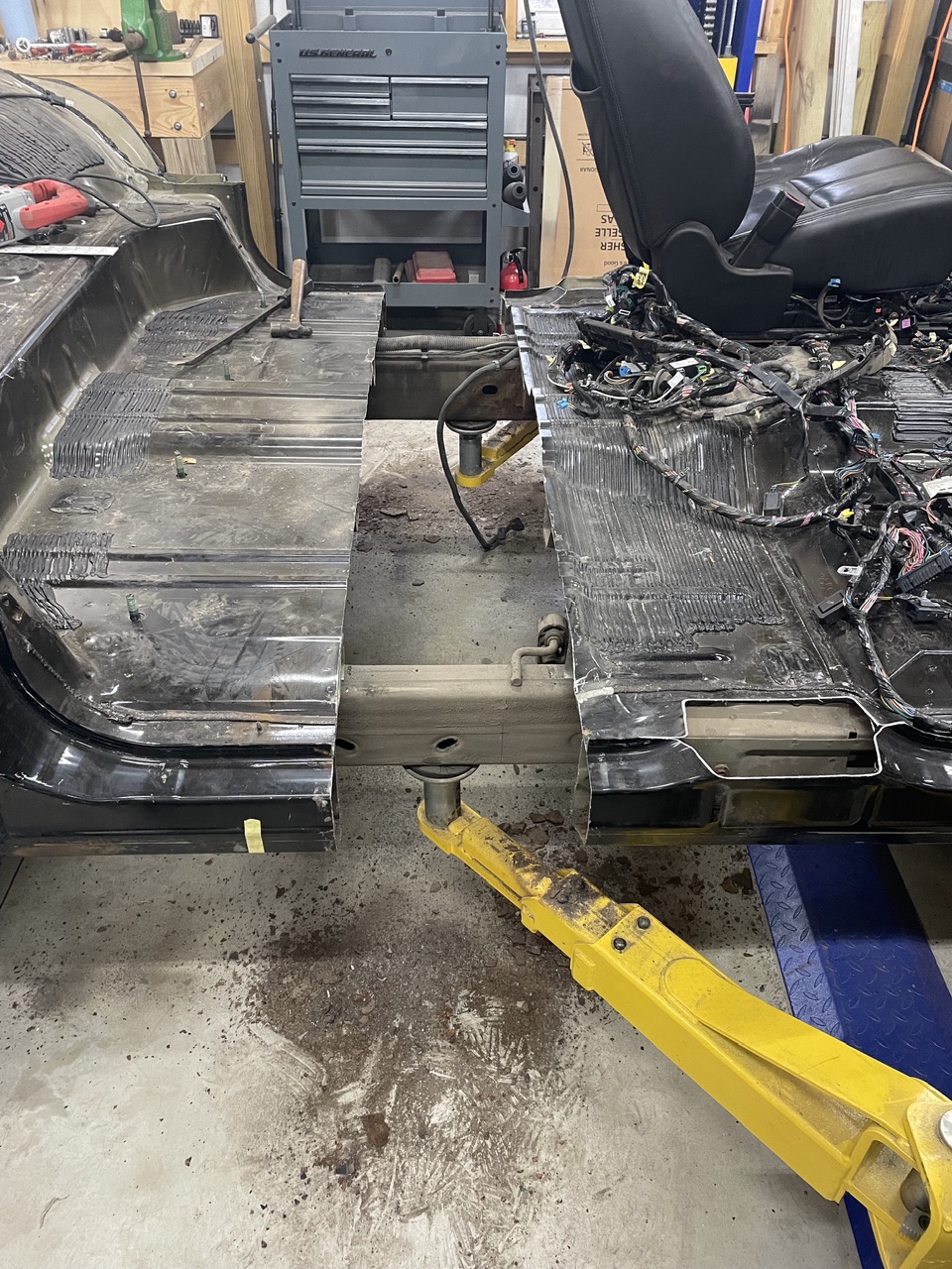

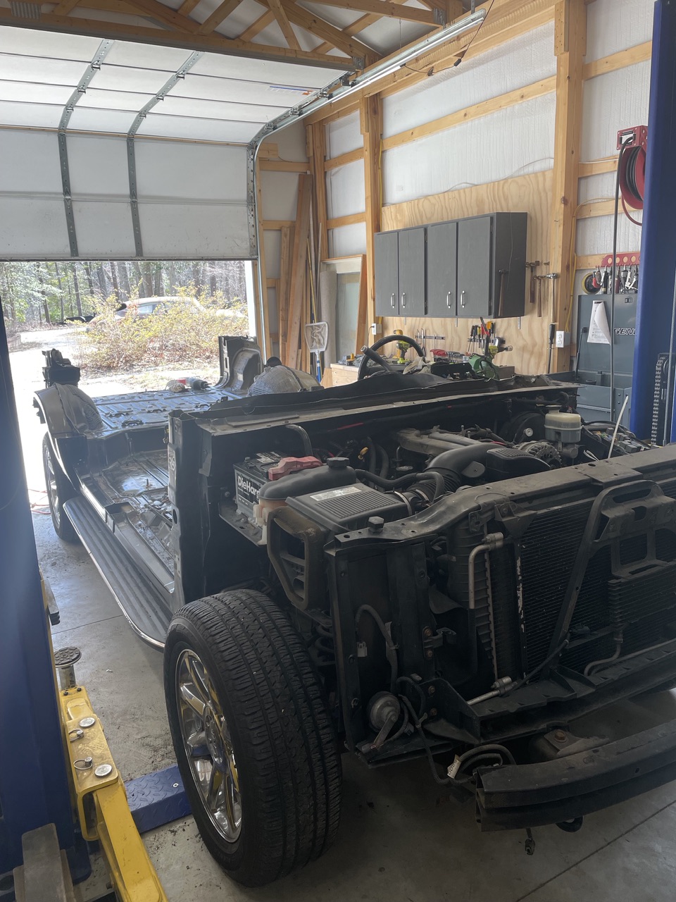

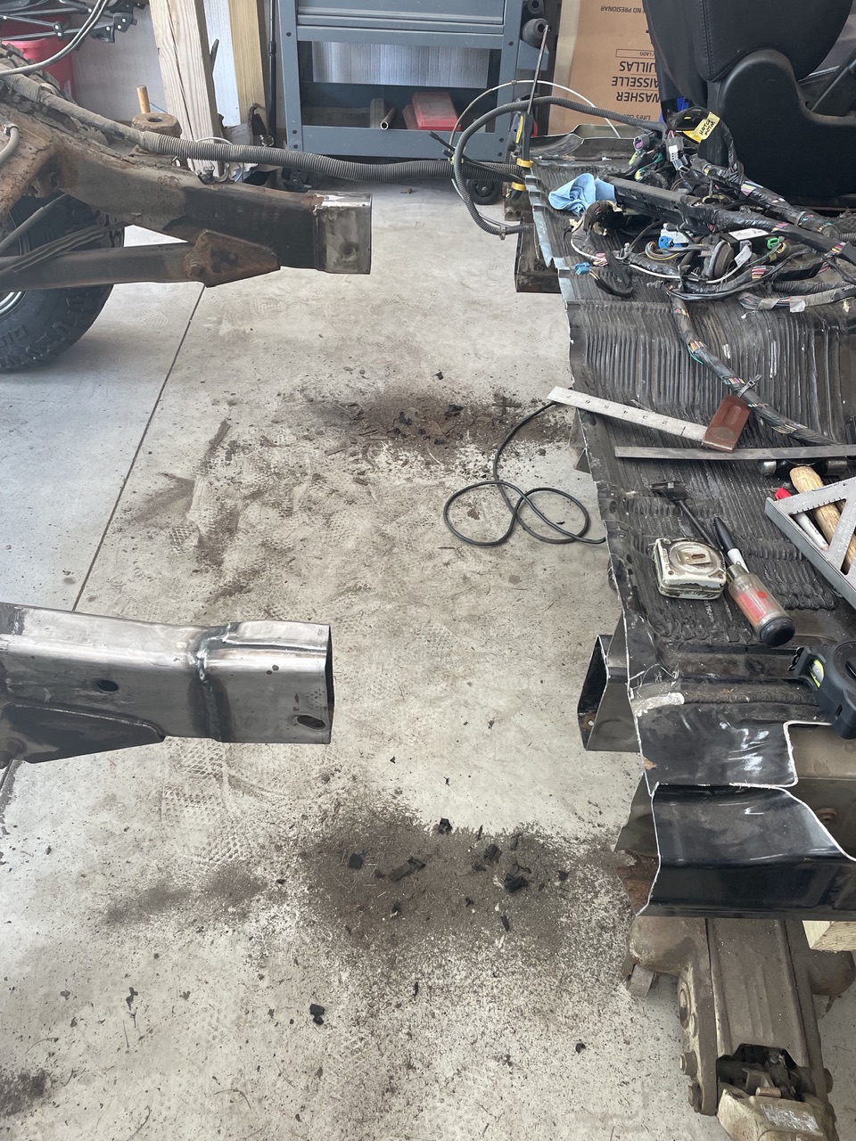

Got the Yukon down to bare bones and getting ready to take 12” out of the frame to make things “fit”.
Here’s the trimmed down body and the floor with 12” sectioned out, frame cut is next.
I also narrowed the firewall to match the Caddy. I’ll have to use a hydro boost brake setup when putting it back together because the narrowed firewall won’t allow for the vacuum brake booster. Also got the Caddy stripped down a bit…..fun stuff!

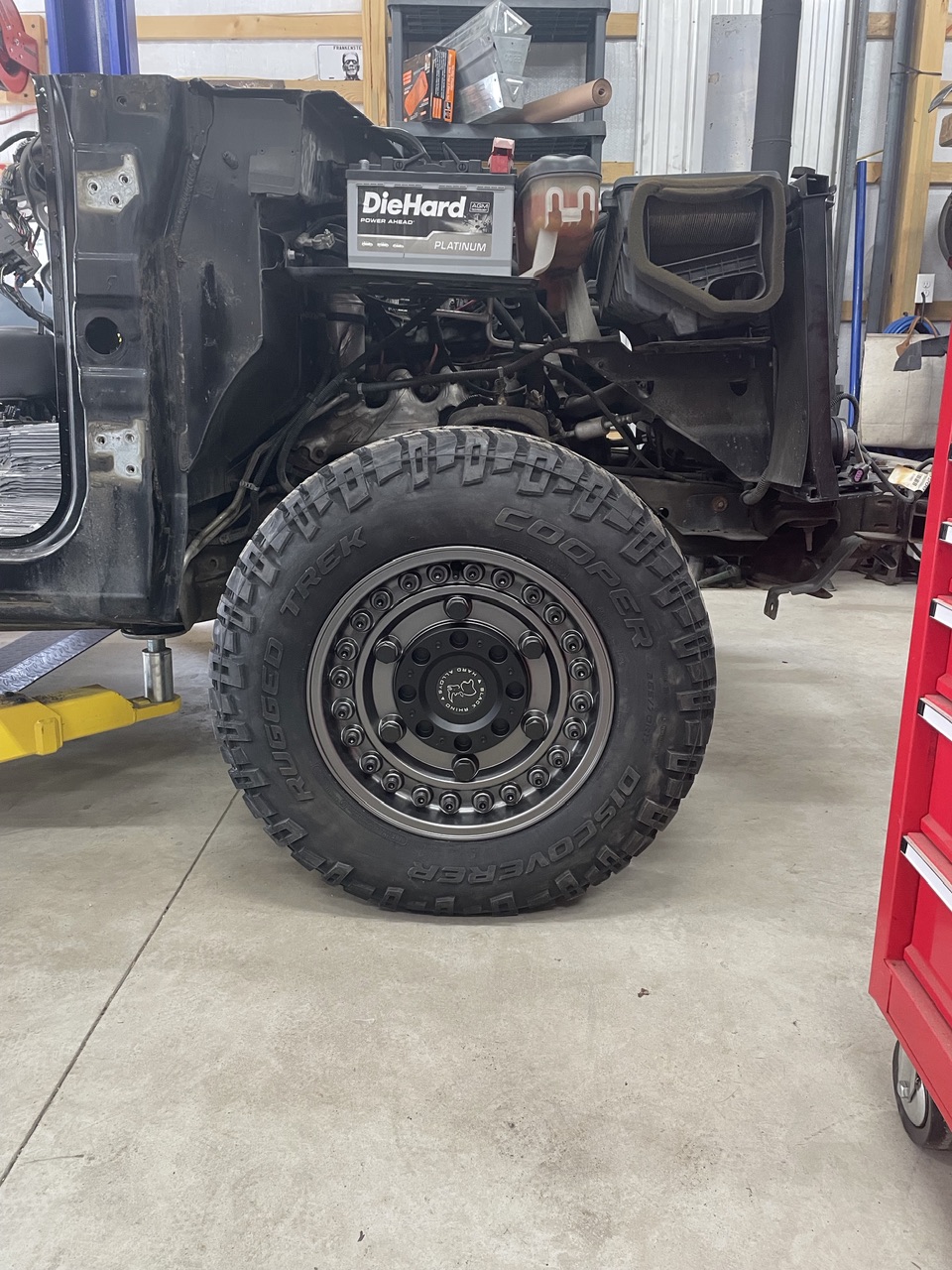

East coaster
Apr 17 2025, 05:33 PM
Oh yeah……and got new shoes for the project. I wanted something industrial looking and these nailed it!

Apr 17 2025, 06:40 PM
You may want to "Z" cut those rails rather than chopping a vertical cut
This will make a way stronger butt joint. Then a plug welded plate

I’m still debating that in my mind…..research is showing straight cut for a fully boxed frame and “Z” cut or step cut for C-channel (unboxed frame). This is a boxed frame, but I still may Z cut it. Either way, it will be plated on both sides after welding.

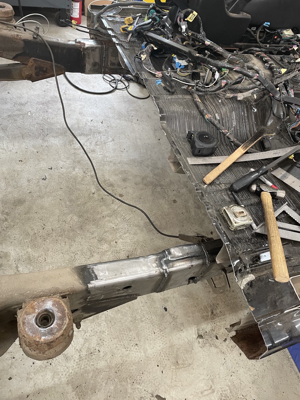

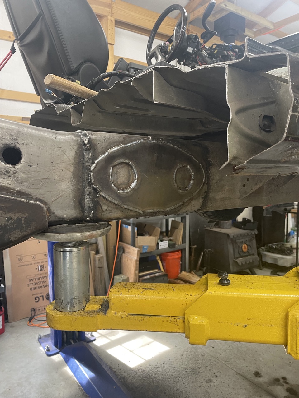

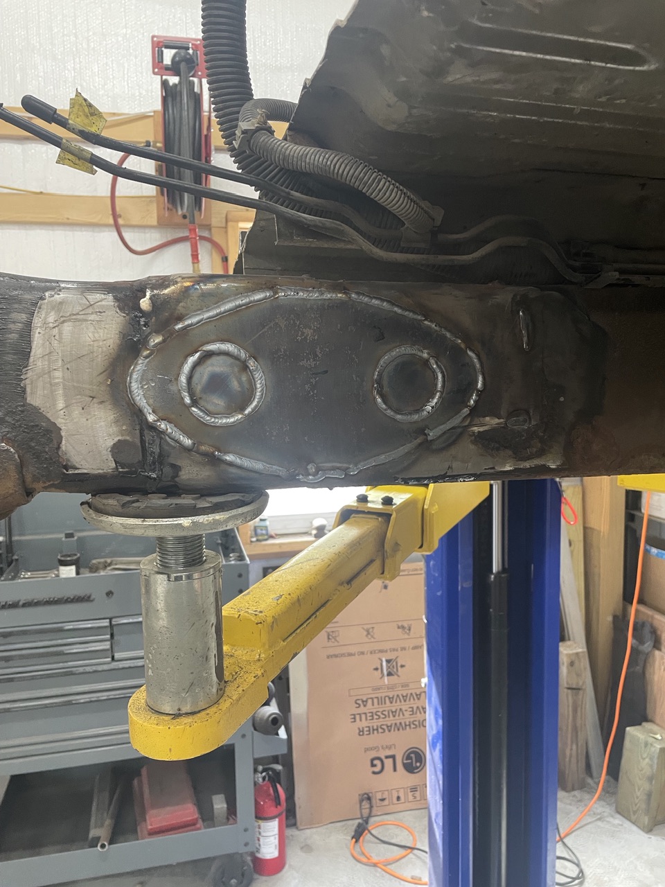

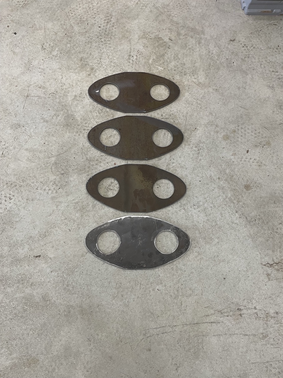

Big step completed…..had to shorten the frame 12” to make it work for the Caddy. I cut a 12” section out of a straight section of the frame and welded it back together. I also made “fish plates” that I’ll be adding to the splices.
Cut
Click to view attachmentPaste
Click to view attachmentFish plates I cut on the plasma table
KELTY360
Apr 24 2025, 08:22 AM
Must really trust your welding skills.
East coaster
Apr 24 2025, 09:12 PM
Welded in the fish plates. If this frame ever breaks, it won’t be here

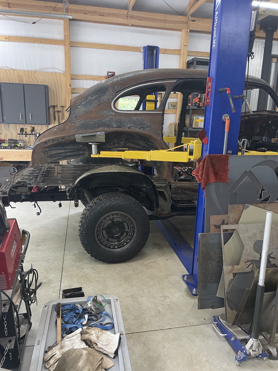

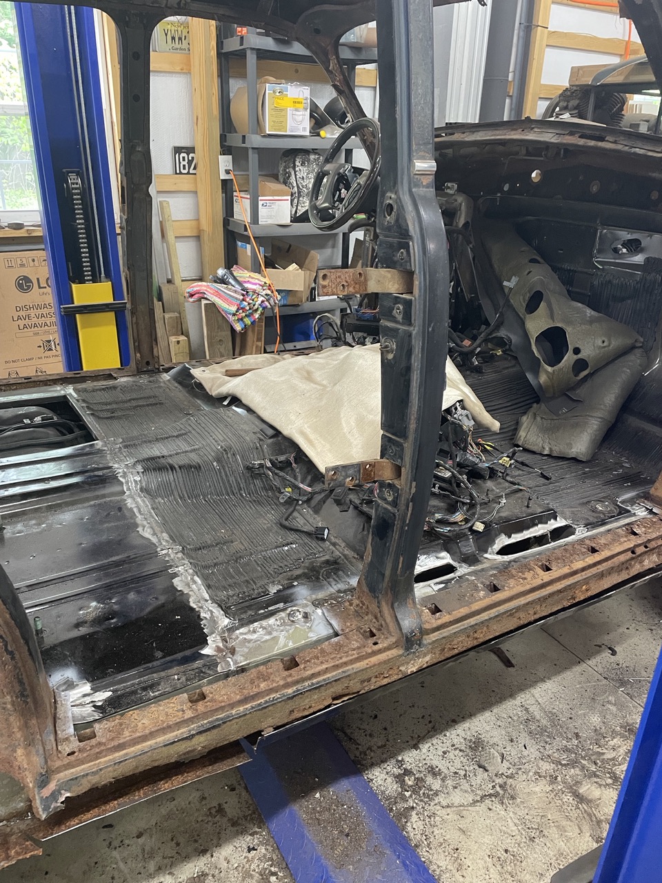

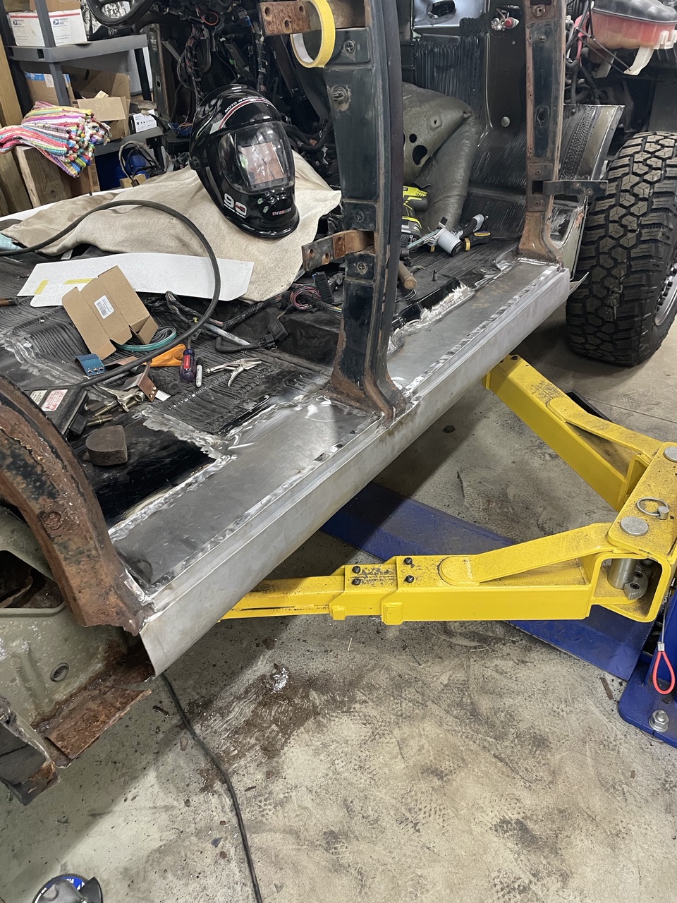

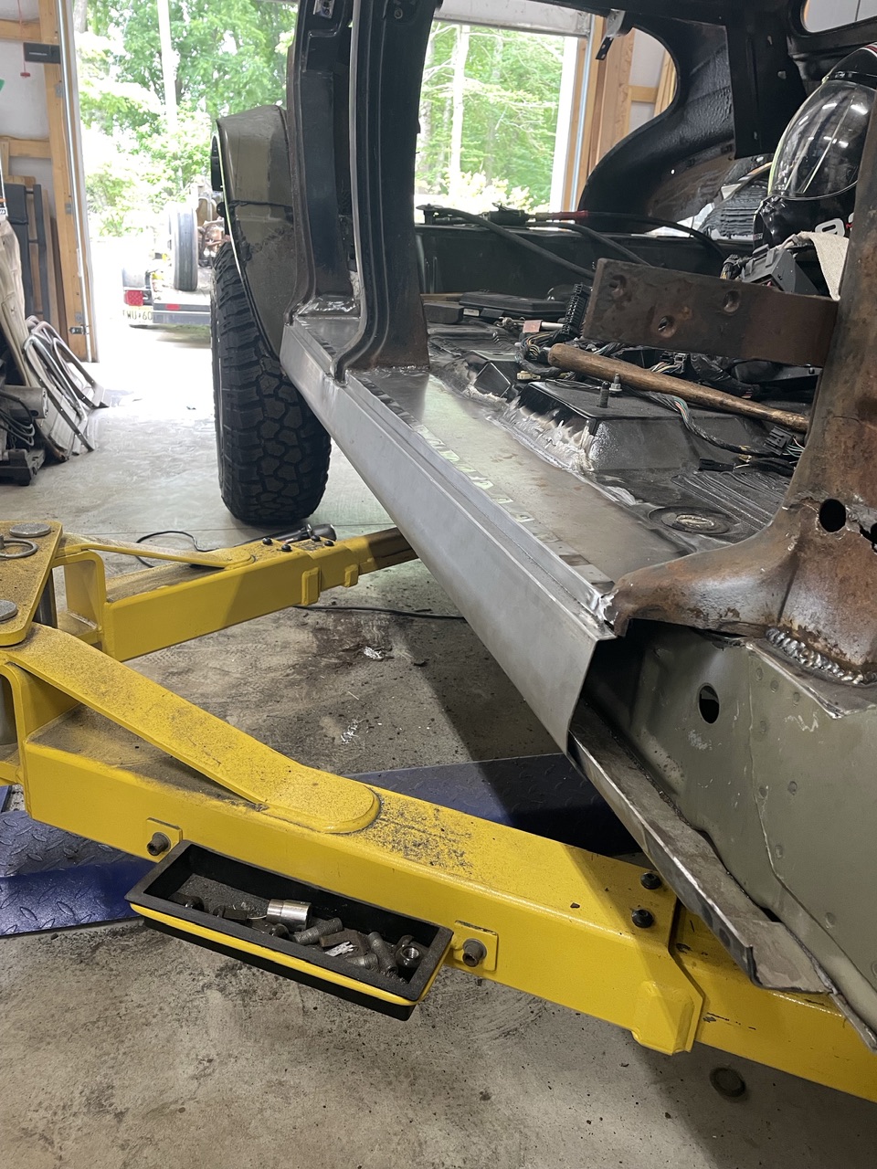

I’ve got the body on the chassis and it’s working out well so far. I welded the floor pan back together and started welding the body to the floor pan. Yesterday I made new sill plates to tie the 41 body to 08 floor pan, and made new rocker boxes…..it’s coming along.

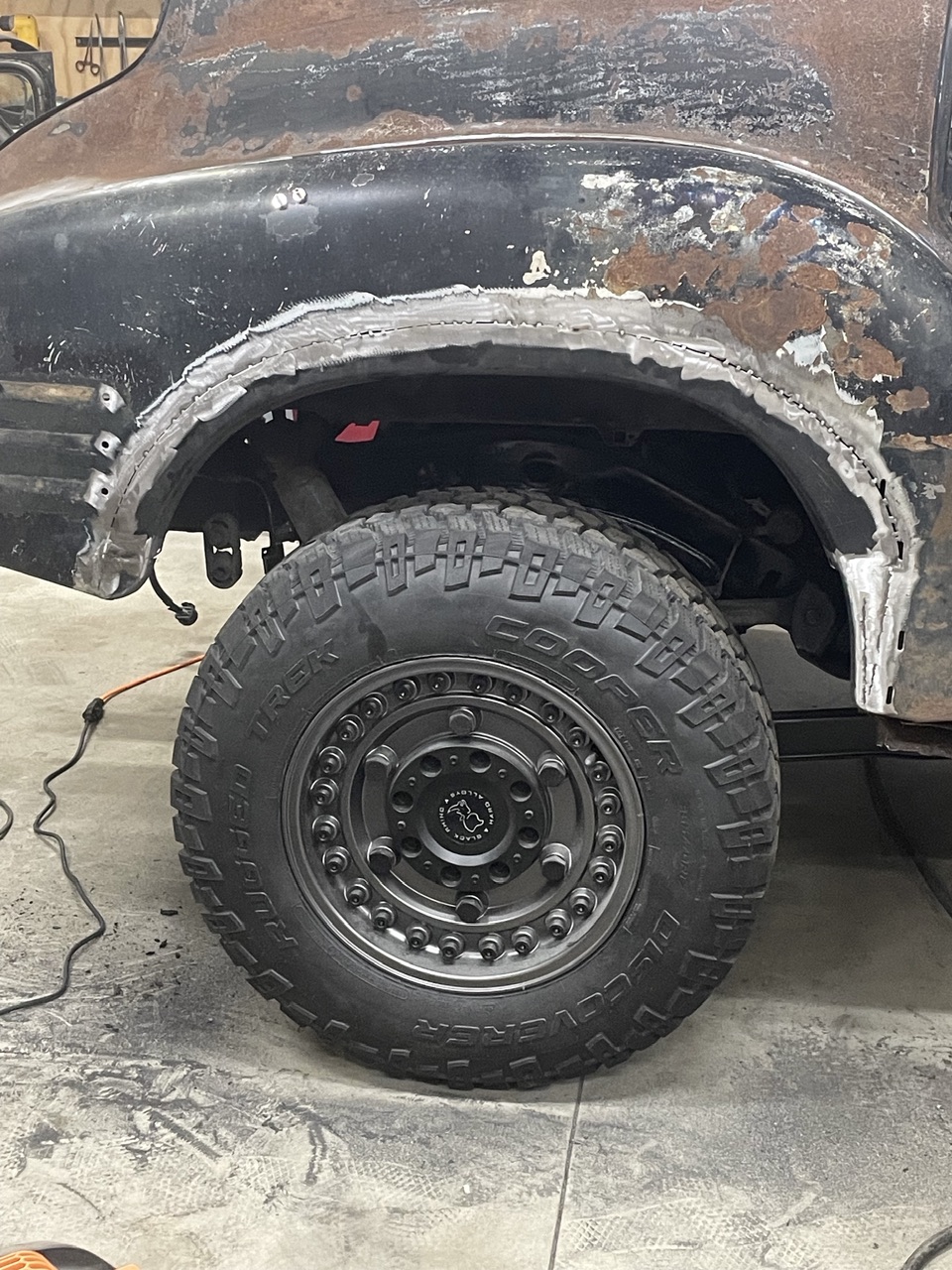

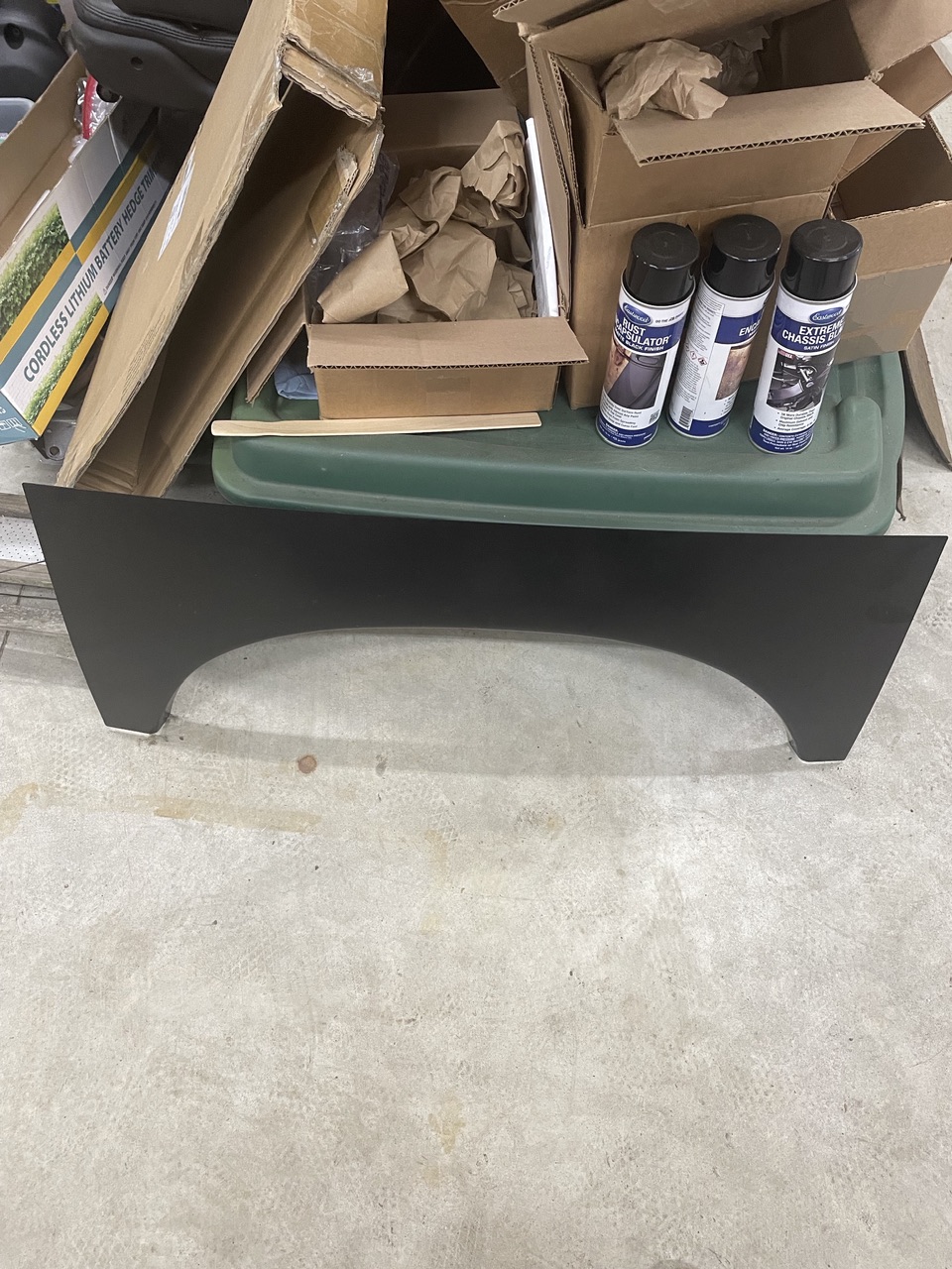

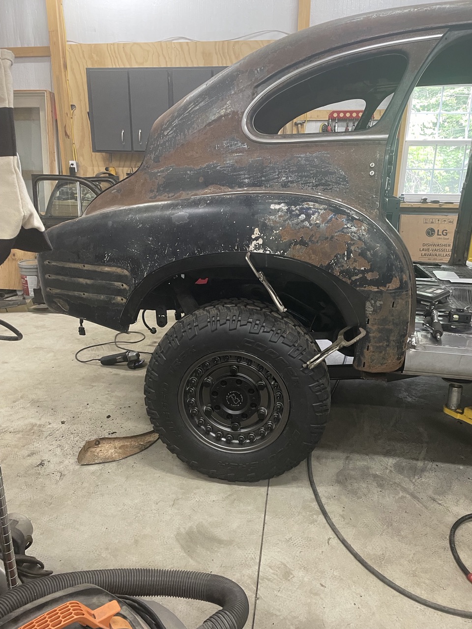

Made some rear fender mods. I had to make the opening larger and move it back a couple inches. I got fender repair panels for a 2004 Dodge pickup and used the lip to create the arch I wanted, then re-blended the lower fender from the Caddy. I need to finish weld them but think they’re going to look good.

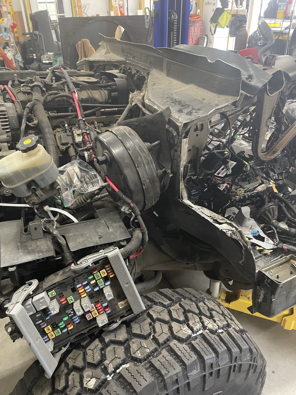

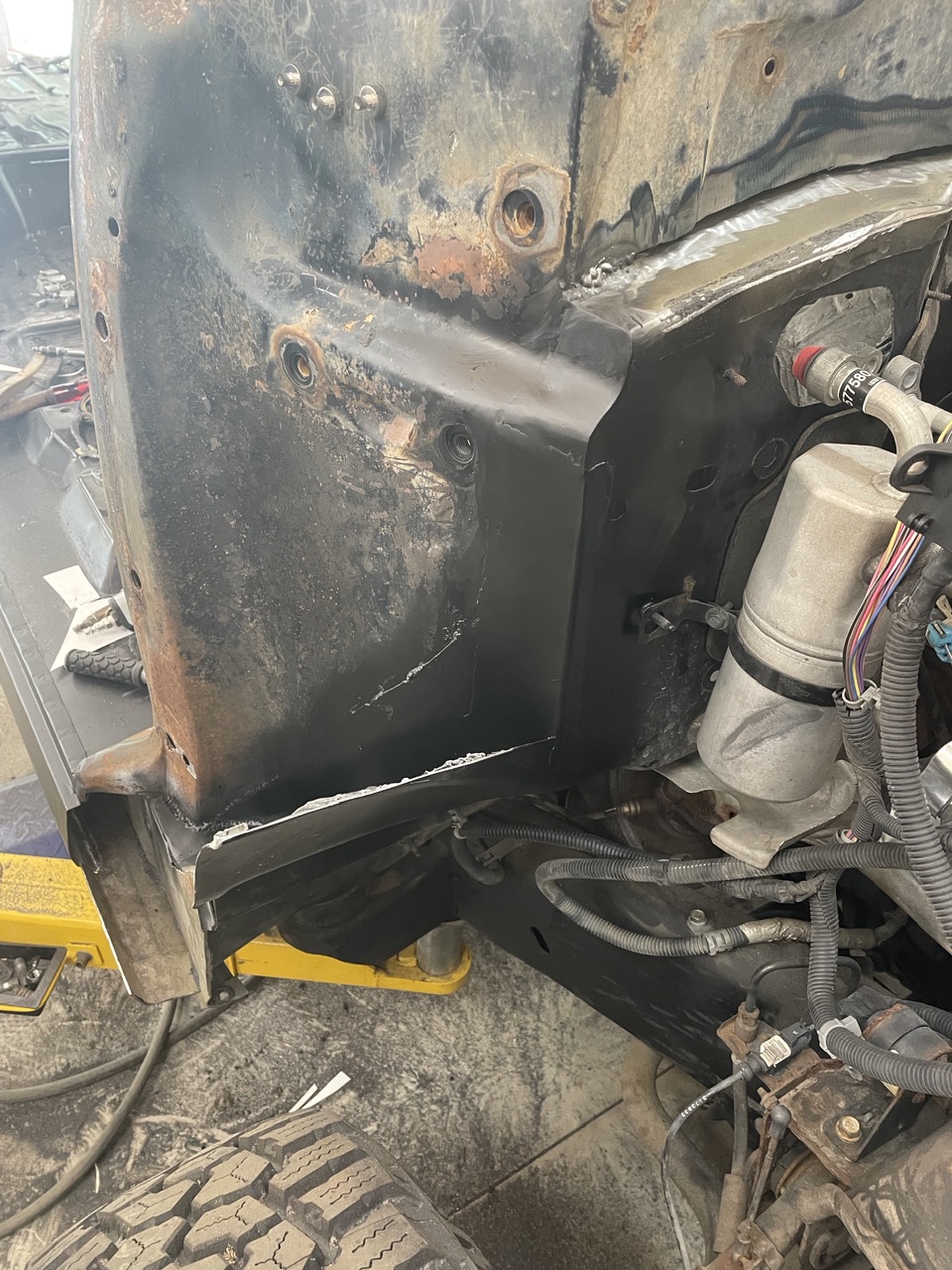

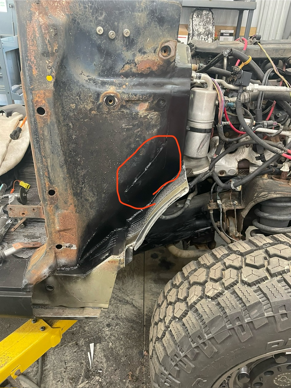

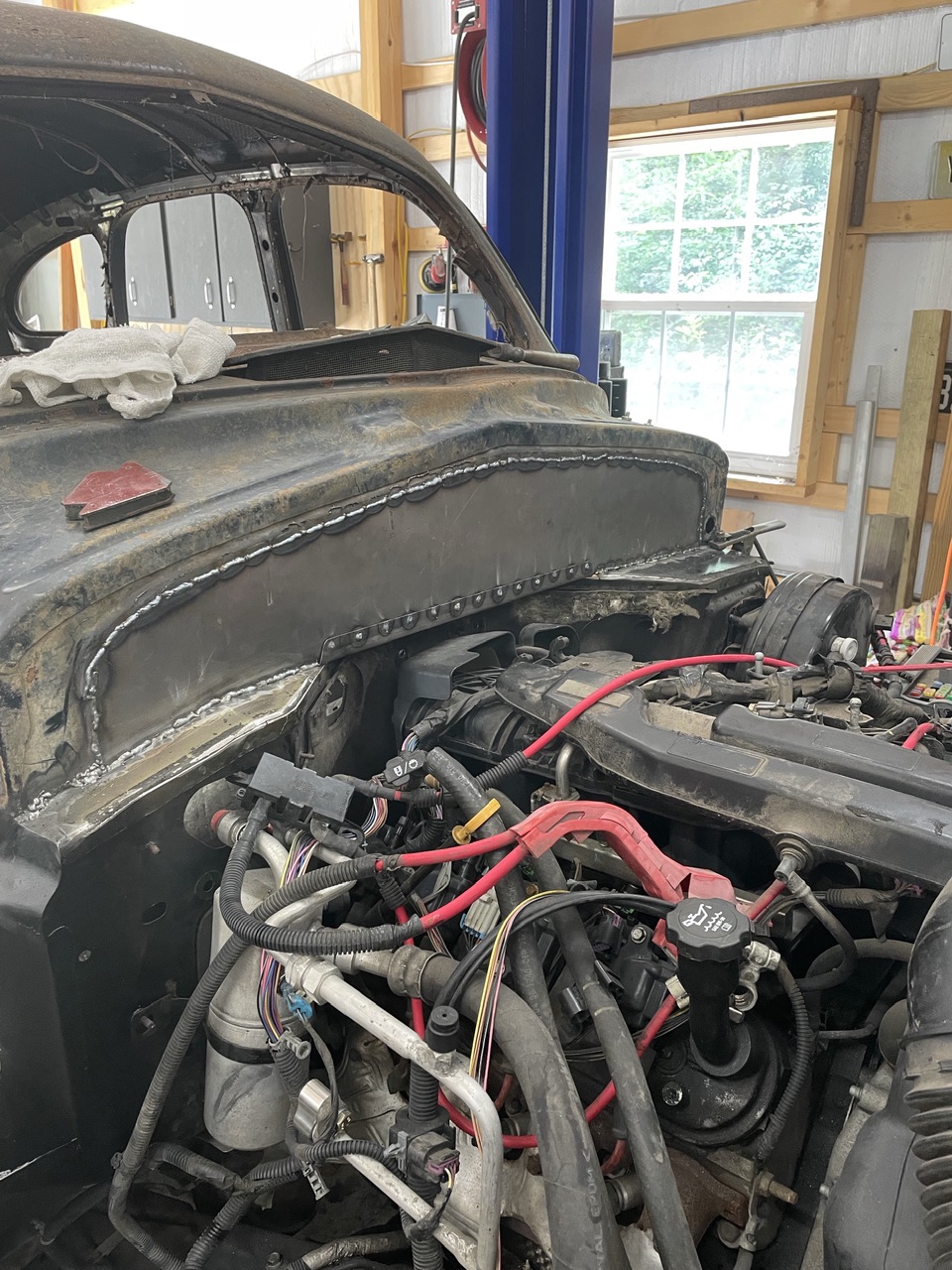

Moved on to the front fender well and firewall area.
Here’s tying the caddy body to the Yukon floor pan at the front wheel well. The ugly seam and welds (circled in red) is factory Cadillac workmanship

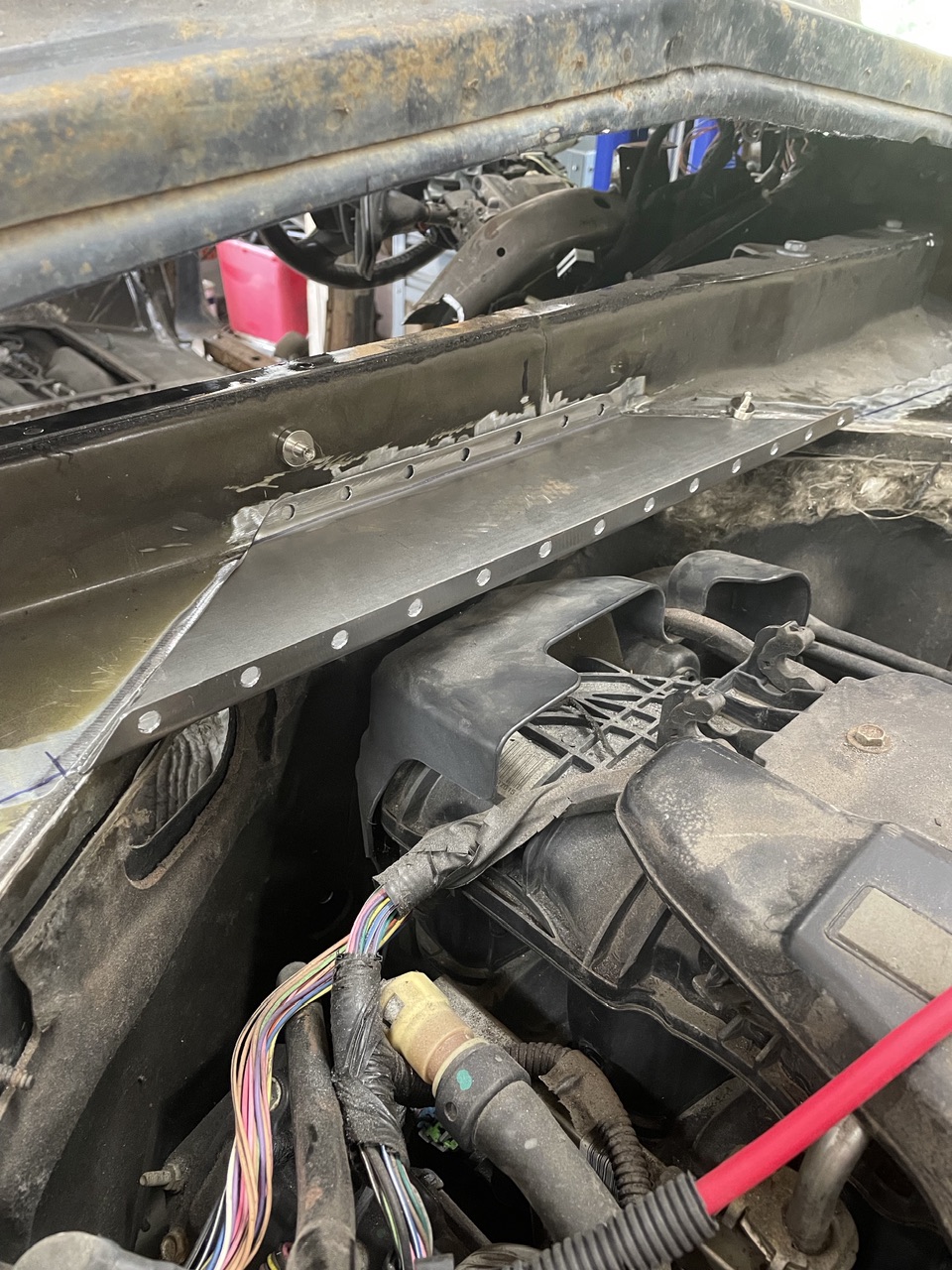

East coaster
Jul 7 2025, 03:04 PM

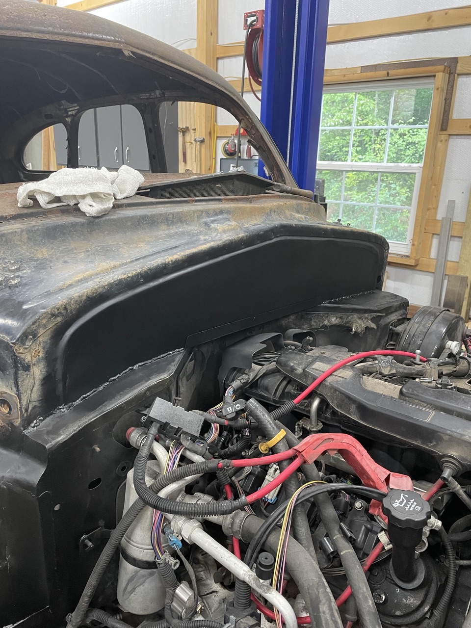

Next was the firewall. I had to make a small triangular part to transition from the shape of the Yukon firewall to the Caddy shape (flat).
Click to view attachment Click to view attachmentClick to view attachmentClick to view attachment

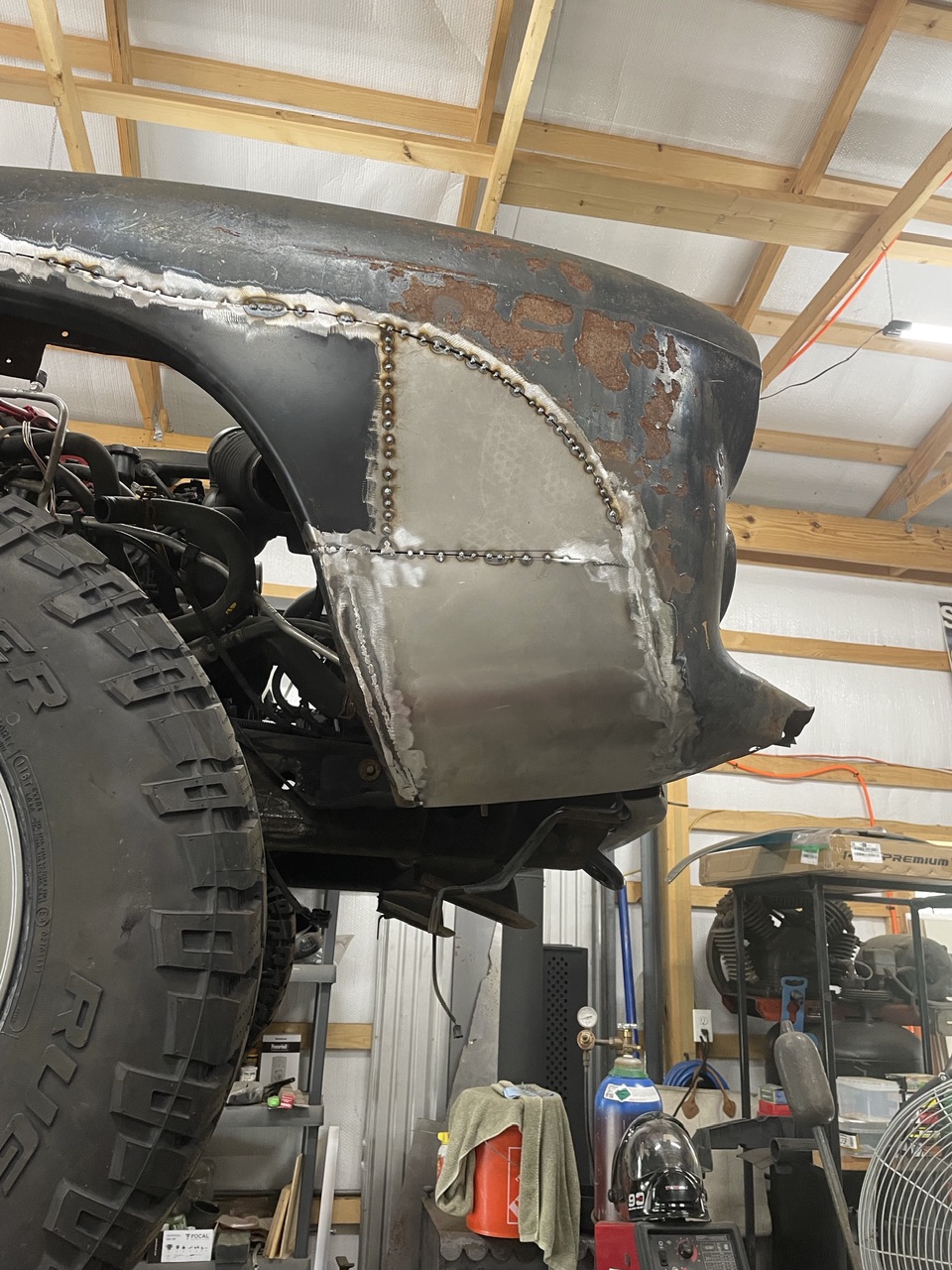

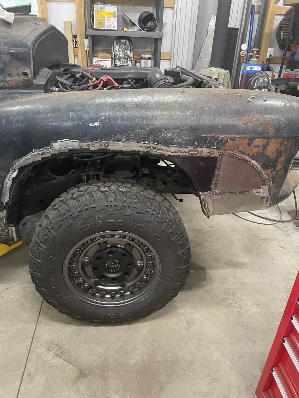

Jul 10 2025, 05:52 AM

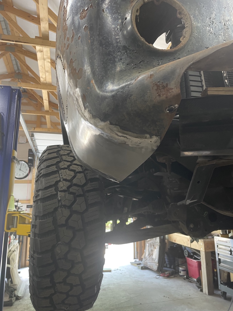

Decided to attack the front fender next. I had to relocate the fender opening 11.5” rearward and was really worried how this would look. I used the same fender lip as the rear fender (dodge pickup repair panel) but had to fab the area in front of the opening to blend with the curvature of the fender. I’m happy with the results and it looks pretty good. Minimal filler and it will look like it was made this way.

jd74914
Jul 10 2025, 06:16 AM
That fender looks great! Can you take a zoomed out picture just to get an idea of the overall look?
East coaster
Jul 10 2025, 06:59 AM
QUOTE(jd74914 @ Jul 10 2025, 05:16 AM)
I can’t wait to do that! I want to roll it outside and get a full pic but I have a trailer blocking it at the moment. I can’t really get a full pic in the shop.
