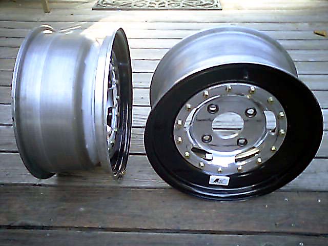

GaroldShaffer
Aug 24 2005, 07:55 PM
| QUOTE (flesburg @ Aug 24 2005, 01:32 PM) |
| How much clearance do you have on the inside at the rear? If you have good clearance between the tire and the inner fender, take out the rear spacers, and you will gain the clearance you need at the rear fender lip. |
without the spacer on the rear the rim rubs the brake caliper

grantsfo
Aug 24 2005, 08:01 PM
| QUOTE (itsa914 @ Aug 24 2005, 05:55 PM) |
| QUOTE (flesburg @ Aug 24 2005, 01:32 PM) | | How much clearance do you have on the inside at the rear? If you have good clearance between the tire and the inner fender, take out the rear spacers, and you will gain the clearance you need at the rear fender lip. |
without the spacer on the rear the rim rubs the brake caliper |
Yep, Kiezer fixed that with the inserts they used on my wheels. We worked on clearences etc and they finally found an insert that would clear the brake calipers. So I dont have to use spacers.
My wheels have 5 inch back spacing and are 8" wide. They fit like a glove.
You can see the difference in the new insert here:

GaroldShaffer
Aug 24 2005, 08:48 PM
| QUOTE (grantsfo @ Aug 24 2005, 06:01 PM) |
[Yep, Kiezer fixed that with the inserts they used on my wheels. We worked on clearences etc and they finally found an insert that would clear the brake calipers. So I dont have to use spacers.
Is there specs / part number or something on that insert?

grantsfo
Aug 24 2005, 09:33 PM
| QUOTE (itsa914 @ Aug 24 2005, 06:48 PM) |
| QUOTE (grantsfo @ Aug 24 2005, 06:01 PM) | [Yep, Kiezer fixed that with the inserts they used on my wheels. We worked on clearences etc and they finally found an insert that would clear the brake calipers. So I dont have to use spacers.
Is there specs / part number or something on that insert? |
My sense is they dont have part numbers - but I'm sure Wade Huisman at Keizer will know the blank. I worked with him over the phone for quite a while. I'm sure he will remember. Its not their magnesium insert - its an aluminum insert.
