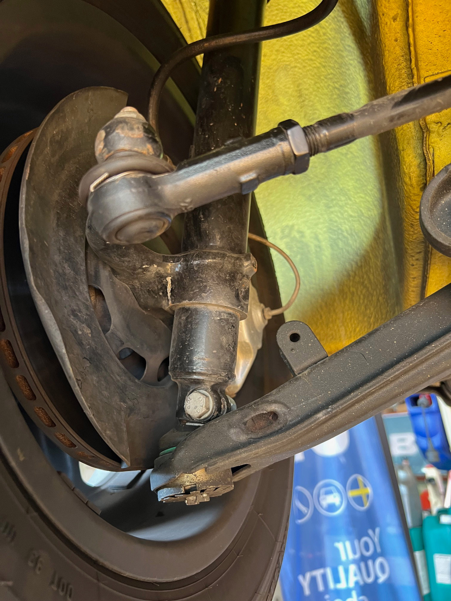

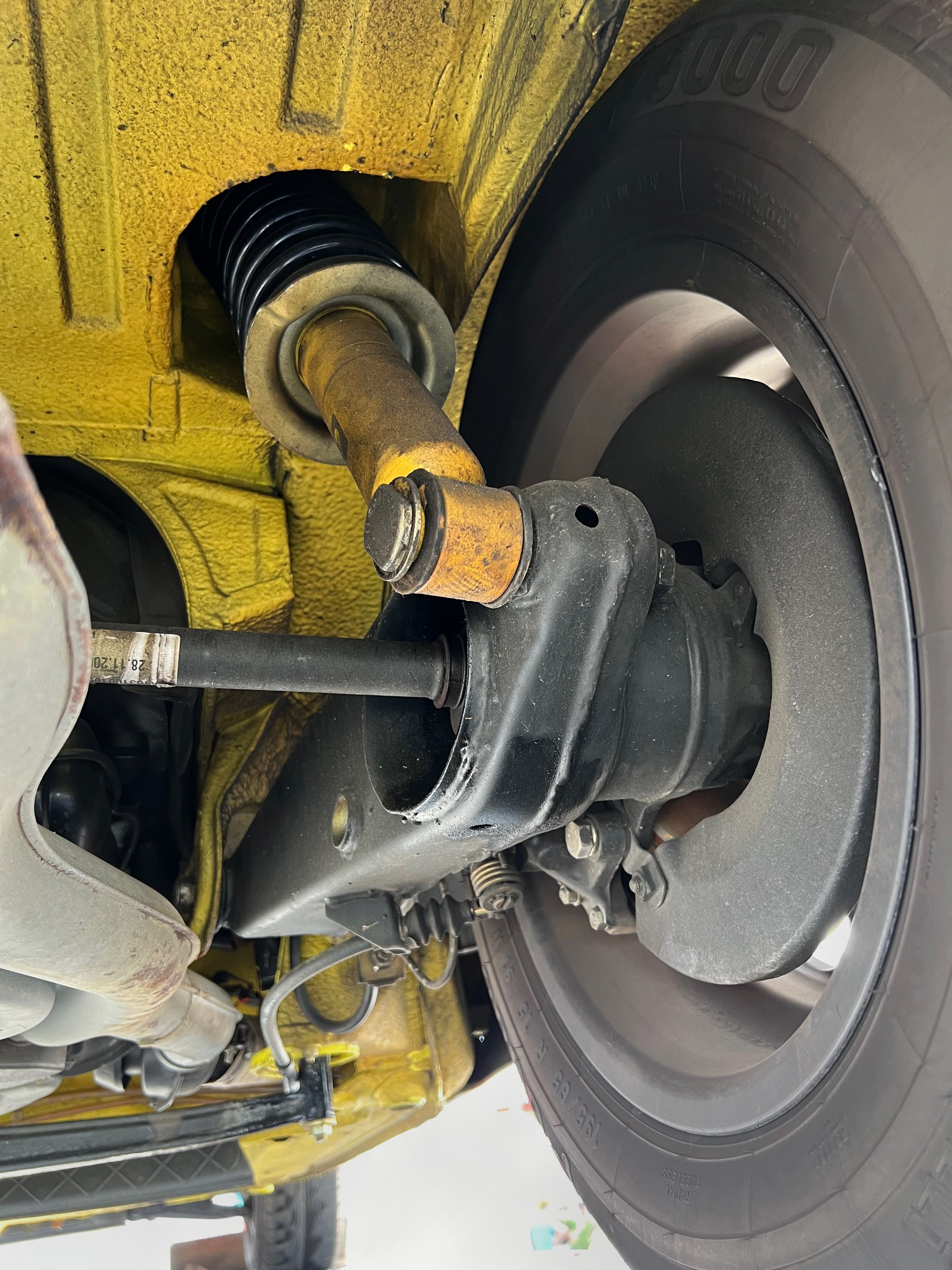

With the 5 lug wheel upgrade, you probably have 911 A-arms which is why you might have the tab and not the actual sway bar. Like others have stated, you might have larger torsion bars and rear springs resulting in the stiffer ride you seek to soften up.
Adding a stock swaybar is going to further stiffen the ride due to the non adjustable drop links, sitting, the stock sway is under a bit of torsion, which will slightly add to the stiffness of your ride.
Be sure to consider all these aspects when formulating a plan of attack, as for wheels and tires, pending pictures of your car, id leave them alone, concentrate on spring rates.

Isn't it possible to verify 914 vs 911 torsion bars by exposing the splines at the T-bar adjuster?
Can this be done without serious disassembly?
I believe it can and if it does have the 911 bars EVERYONE has said "Pretty stiff, most people won't like them" and I'd change back to 914 stuff first before changing up my tires.
If the spring rates are too high for your taste nothing else will tame them down.

This is an EU car, it was originally delivered in France, and imported into Switzerland sometime in 2013. According to the body number - 4449600, if I figured out how to correctly interpret the numbers, it was the 100th car manufactured on the first of November, 1973 - but I assume it was sold as a 1974 - the first registration is dated January 1974, although that could be a fictitious date. There were no "bumperettes" or side blinker lights on European models (thank goodness). There is also no P O R S C H E lettering on the engine lid like the US models had, and the tail badge is 914-VW-Porsche 2.0 (US models only said "914 2.0" IIRC).
I don't have any records of what was done in France, it was there that the body was restored and repainted and they did a very good job. I do have records of what was done in Switzerland subsequently. The 5-lug conversion was done in 2014. There is no mention of changing the A-arms, just the hubs, brake calipers etc. Also at that time it got the Bilsteins and the 15 x 7 wheels. No mention of any front torsion bar or rear spring replacement, but something like that could possibly have been done in France before the car got to Switzerland - no idea really.
While the car was on the lift last week for something else, I did take a picture of the front suspension setup:
Unfortunately I did not take any pictures of the rear suspension at the time. I will do some more picture documentation soon.

Here is an image of the rear suspension.
