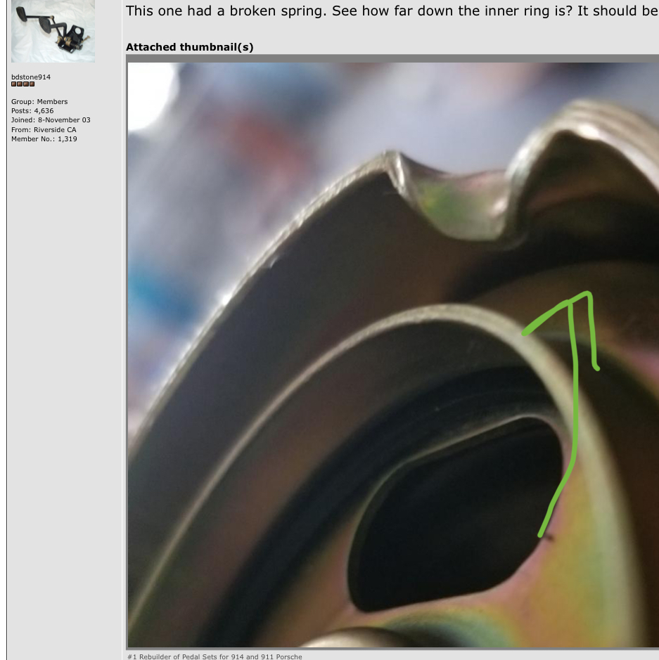

bdstone914
The spring is not visible. Press down on the center of the inside of the cap. It should be under tension.
If it is broken you ned a new cap. Same as a VW Beelte in the 70-74 year range. I dont like the 914 rubber seal either. I make rhem out of a thick fiber material.

bdstone914
This one had a broken spring. See how far down the inner ring is? It should be all the way up.
Mike1981
QUOTE(bdstone914 @ Aug 5 2024, 07:09 PM) *

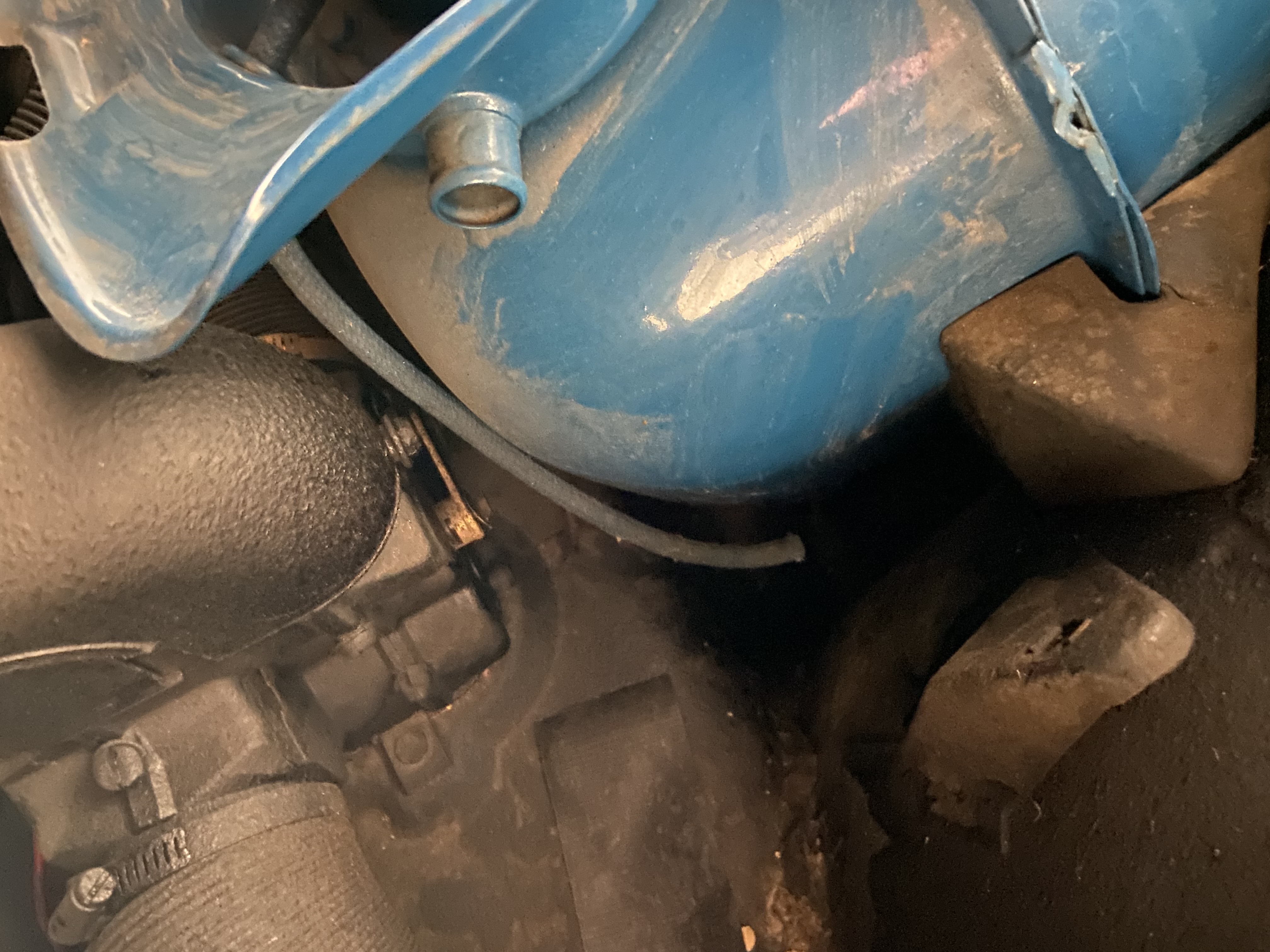

Hello Everyone.
I ordered a new gasket, installed it and it did not solve the gas smell problem.
I then noticed the overflow hose is disconnected. I think the gas is being sloshed upwards and drains through this hose onto the car.
Should this be connected to something?
Also there looks to be a breather and this is not capped off either.
Mike1981
Hello Everyone.
I purchased a new gasket...no improvement.
I did notice this drain hose which is dumping the sloshed fuel onto my car. should this be connected or capped off?

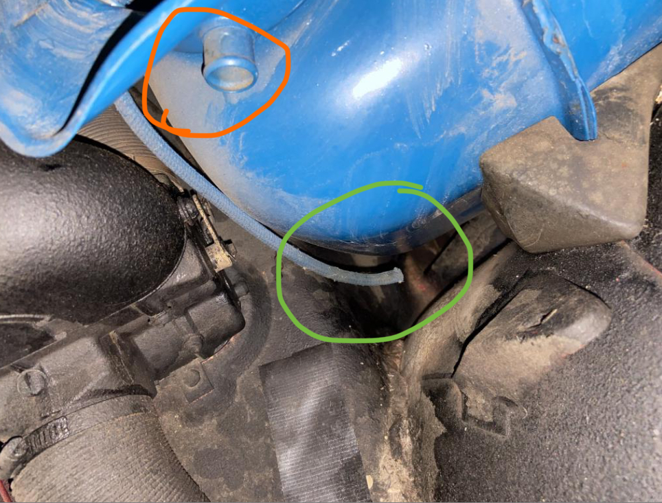

Superhawk996
First - stop overfilling the tank
Second route hoses properly.
Orange is overflow - route out holes below tank to ground
Green is supposed to go to the vapor expansion tank and then to charcoal canister
Looking at your blue tank I can only assume that you no longer have the expansion tank, charcoal canister, and associated plumbing back to the engine.
Route green line same as orange if need be. You will have vapor / smell until you route to a charcoal canister which gets purged at each drive. Click to view attachment

Thanks Superhawk for the advice.
Yes charcoal canister is long gone. So Tie both together and route down to hole below tank?
Superhawk996
I wouldn’t worry about trying to tie together into a common line if that’s what you mean. Just route both under car.
If you park outdoors you’ll be fine.
If you’re parking in a garage you should look into finding the expansion tank and charcoal canister. I had to go this route - like your car, mine came to me “fixed” by DAPO who got rid of the evap system when they installed carbs. chair.gif Full disclosure: I was a DAPO back in the 80s with my first 914 and ditched the evap stuff when I went to carbs . . . And dealt with occasional gas smells.
For what it’s worth, by having tank vented to atmosphere, it’s not great for the environment and over time your most volatile parts of gasoline evaporate off which I’d rather be burning and making power with instead of smelling up the garage.
