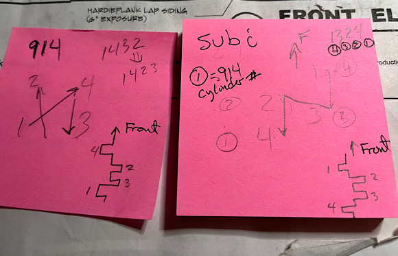

This was bugging me. Looked up Subi cylinder numbering and renumbered to 914 numbering convention.
Subi 1324 = 914 4321 which = 1432 av-943.gif now I get it. I’m slow and not intimately familiar with Subi’s. happy11.gif
