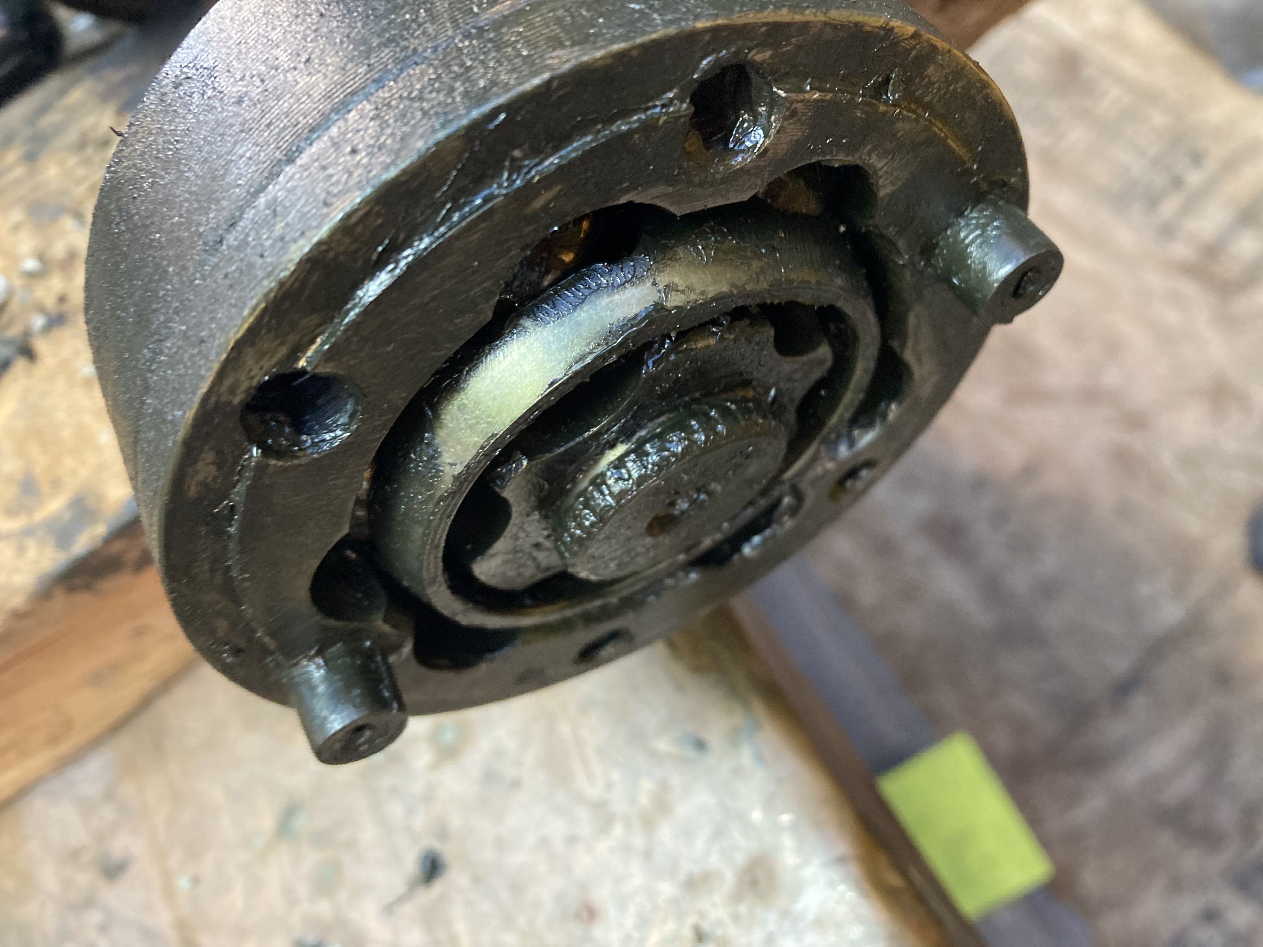

Going to try and clean up these CV joints on my car, but couldn't remove them. Banged on them for a bit, watched a couple of videos (where the people in them just slid them off), and still cant remove my CV joints from the trailing arms.

Do you have a pic of the outside (opposite) end?
rick 918-S
There is a snap ring in this end you have to remove. I didn't get the best photo with my phone but I believe the snap ring has slightly pointed ends they will help hold the snap rings tool as you spread it. It sometimes takes a couple whacks to loosen it from the groove. It's tight.

Have you removed the clip on the other side of the CV?
You you have a press? If so you can support the inner race and press the axle out of the CV.
If not it can be done with a vice with the jaws supporting the inner race. Do not strike the axle directly with a hammer as you can damage the splines. Use either a steel plate or a second ball pean hammer against the axle and strike the second hammer with the first. The round ball of the hammer will center in the axle.

yes, I removed the clip ring smile.gif Here is the front side:
quite the headache

yup remove the snap ring

Ok so I rented a slide hammer and an axle puller from O'Reillys and that did the trick! Thanks for all the help! so glad we got those off
