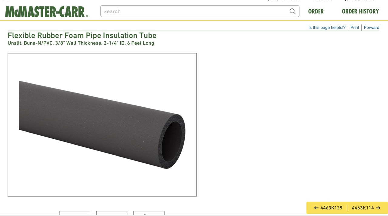

I’ve now put about 500 miles on my car through some of the hottest summer weather I can remember and I have to say I have zero heat transfer in the tunnel. I didn’t do anything to insulate the tunnel itself, but I did insulate the tubes passing through it. I used 1-1/4” alum tubing for the runs and I covered the tubes with a quality pipe insulation from McMaster Carr. I used one piece of insulation and ran both tubes through it. This took up less room in the tunnel vs two individual pieces of insulation and just fit better.
Here’s the insulation I used:

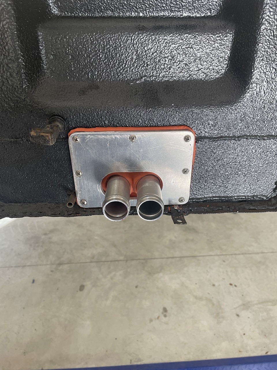

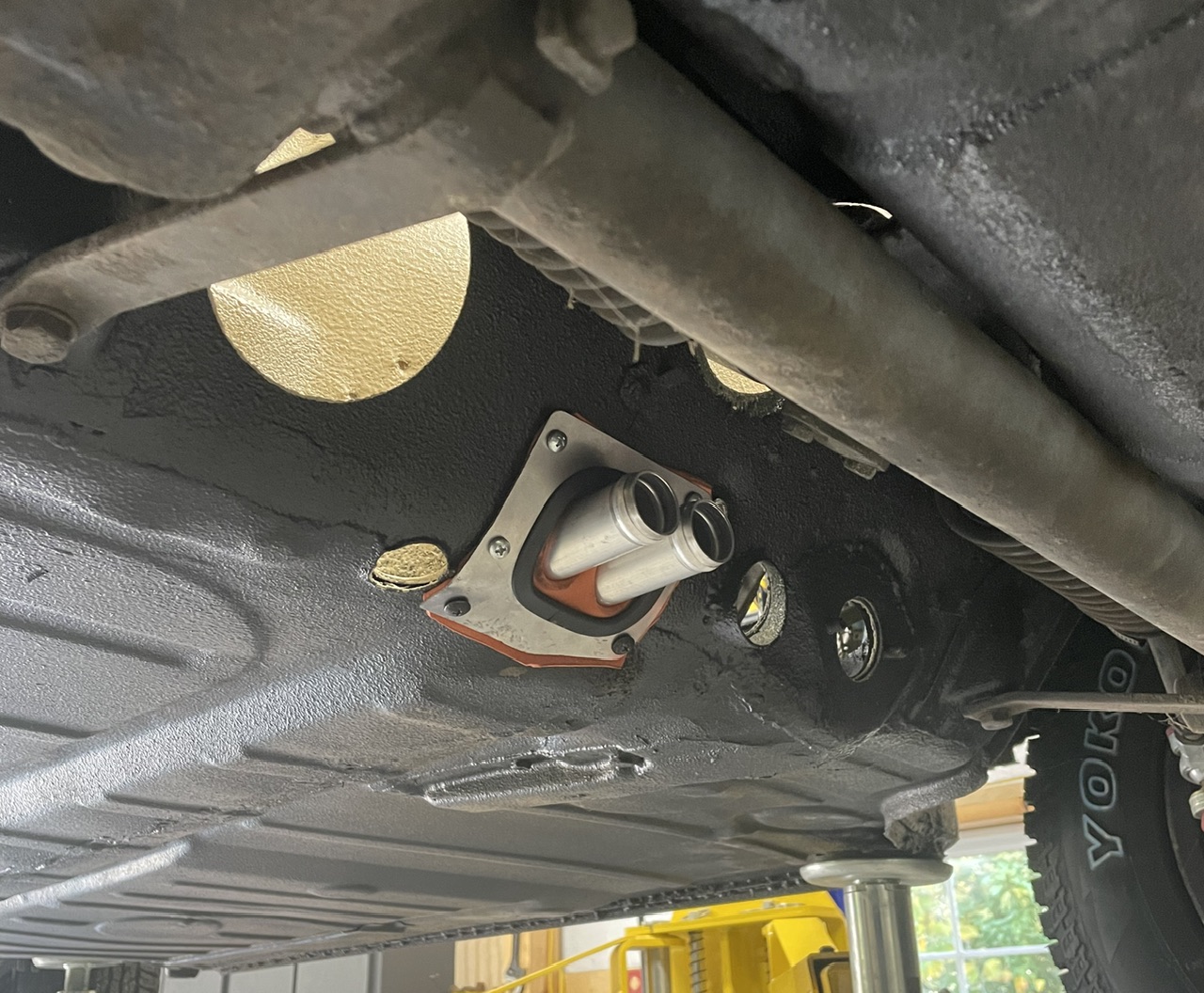

Here’s the tubes as the enter the tunnel:

That bulkhead flange looks SERIOUS!
Nicely done, but so much of that car is exquisite anyways...

Am I seeing a silicon foam gasket material there which acts not only as a seal around the tube and body, but also as an actual tube support too? idea.gif
What was the initial gasket thickness, 1/4"? I could see a similar use for oil lines going through the body or oil cooler seal to duct on front mounted cooler.

Yes, 1/4” thick silicone sheet from McMaster Carr. It does serve as both a seal and a mounting isolator for the tubes. I have a similar setup n the front where the tubes exit.
