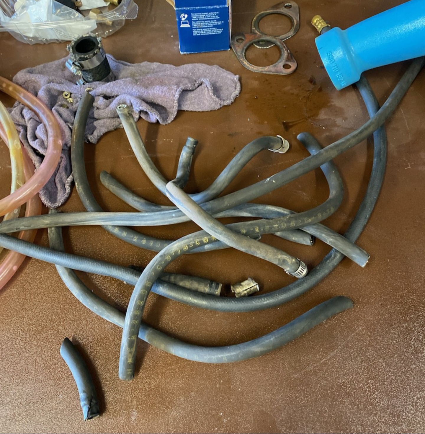

I'm going through my air cooleds' right now with new upgraded PTFE fuel lines for this very reason. Just had all these (original) fuel lines pulled out of the '79 930>> low (11,250) orig miles and all non-ferrous fuel lines were hard + cracking. Get your old fuel lines into the dumpster and keep your investment safe !
