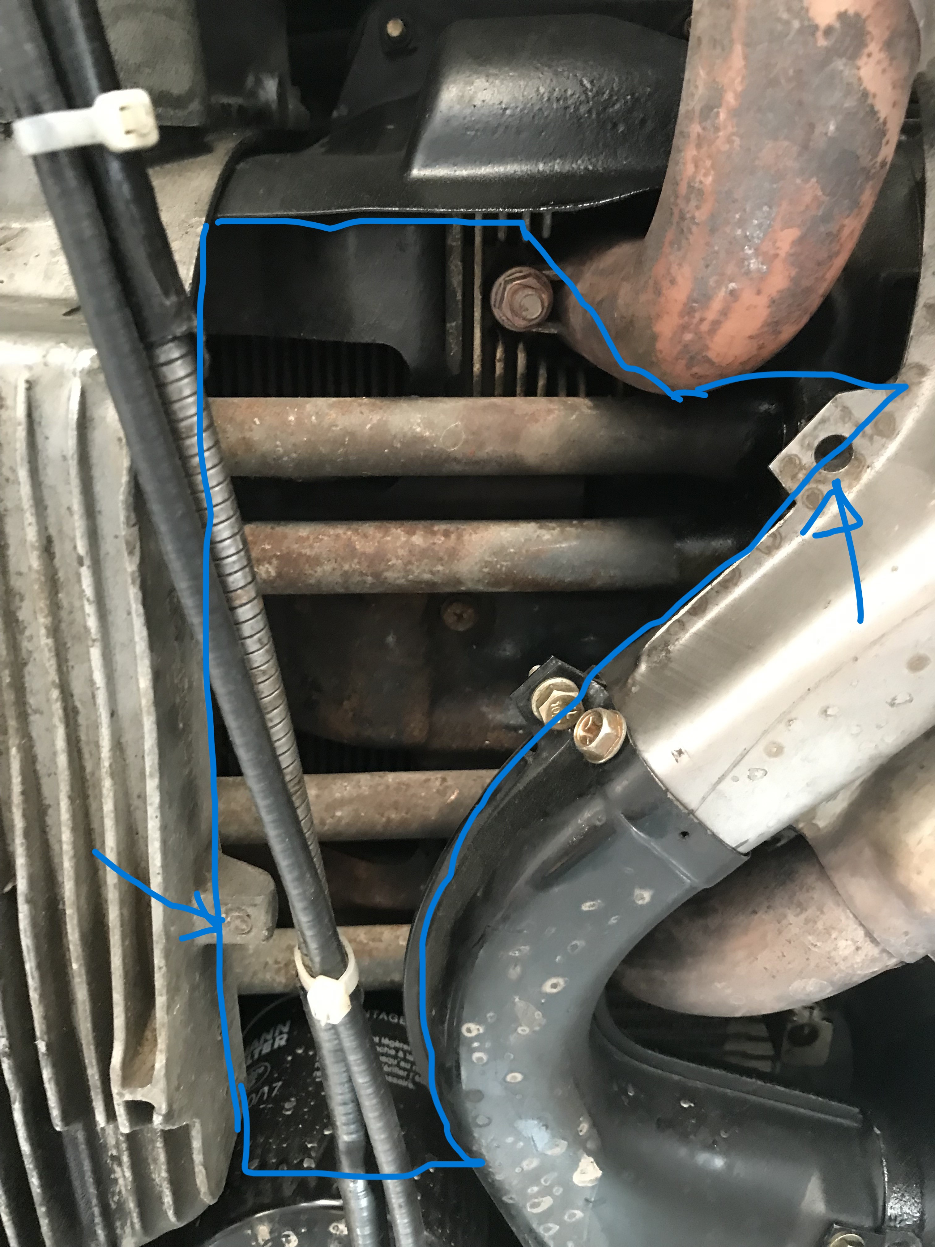

As I was under to car to look from where it was leaking, it seems to me that I am missing 2 pieces of tin on the underside of the engine. My understanding is that there are tin that goes between the heat exchanger and the case.
Looking on the web, I think that I could supply the one going on the passenger side but was not able to find out anyone capable of supplying the one on the driver side.
Anyone knows where I could get these tin pieces?
Below is an image of where I think I would be missing a tin (passenger side). Anything else missing???

we had them made and literally have HUNDREDS of new ones on the shelf. We also have used ones for the left 70-72. Here are the different ones:
left drivers 70-72
right pass 70-74
left drivers 75 76
right pass 75 76
air guide plates dependent on the shift linkage and the year of the heat exchanger

PaIsa
QUOTE(VaccaRabite @ Aug 19 2024, 09:49 AM) *
Most 914s are missing that tin. It won't slow you down.
Zach
I know it won't slow me down, but would like to have them. I like to have parts where they suppose to be. Maybe pointless, but it is the way I am!
PaIsa
For the passenger side, your part number appears to be B022119355.
For the driver side, I was not able to find the part that seemed to fit my setup.
I have a tail shifter, but not sure how to identify the heat exchanger I have.

Agreed, but some parts had more heck than others. I ran for a couple of months without these. On the right side, it seems like one purpose is to shield the clutch and speedo cables from hot air.

i think you are right. thats mostly why those lower plates are there.
to spare the cables.
