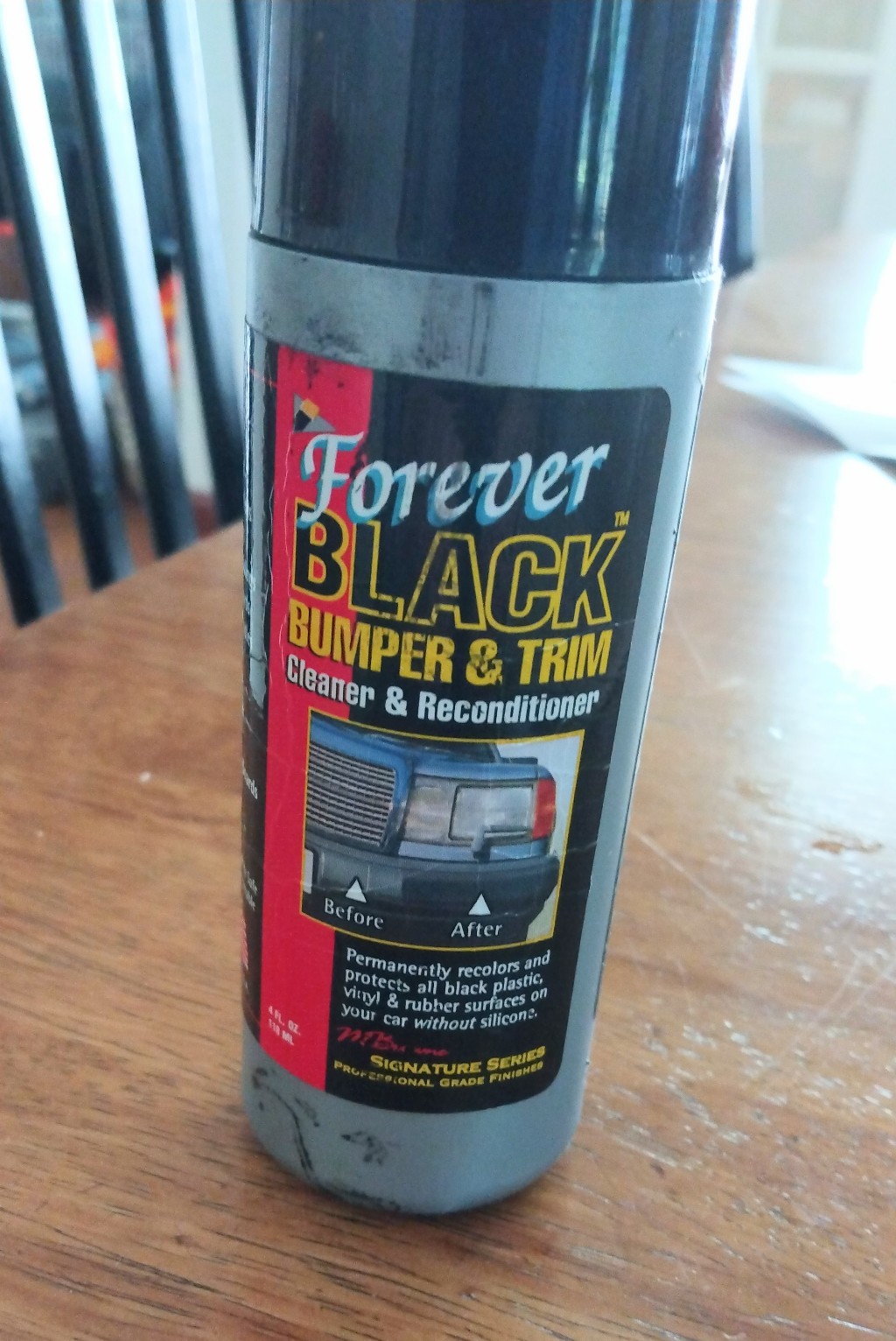

Geezer914
Aug 26 2024, 02:32 PM
Forever Black bumper and trim cleaner and reconditioner
NARP74
Aug 26 2024, 04:48 PM
I look it up but most cleaner and re-conditioners don't add black, they just fix what is already there. That says it recolors so it might, plus the black smears on the bottom are a good sign.
Geezer914
Aug 26 2024, 05:10 PM
QUOTE(NARP74 @ Aug 26 2024, 06:48 PM)
Yes, it recolors the bumper top. It has a foam applicator attached.
