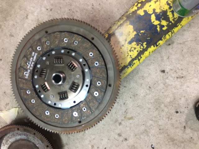

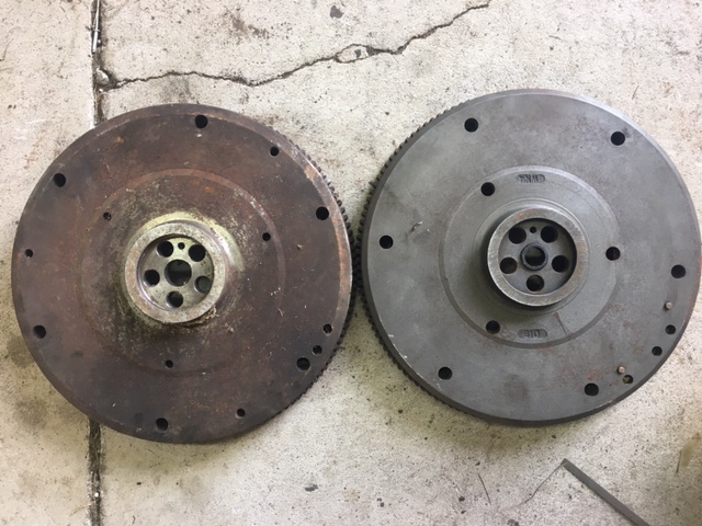

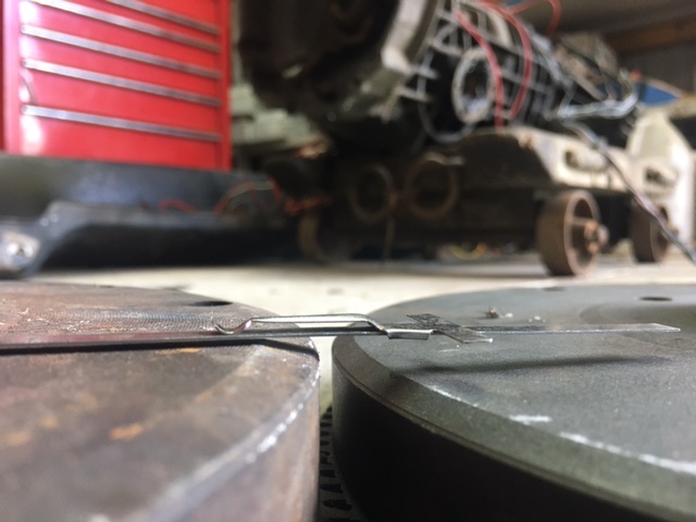

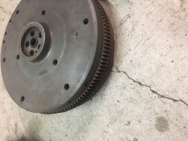

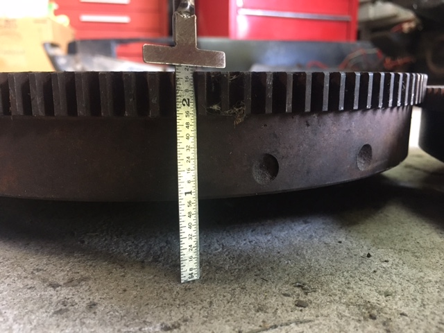

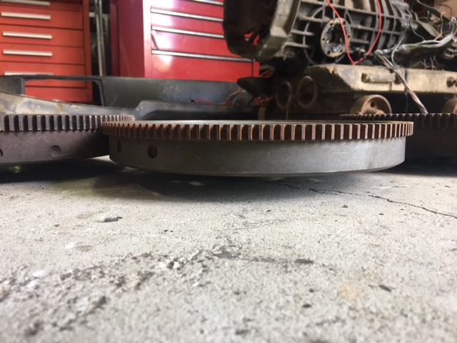

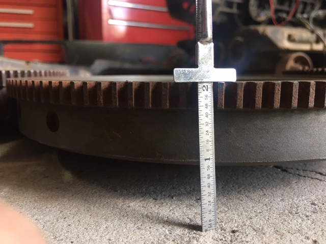

I’m trying to figure out what this flywheel would go to. In comparison to a 914 flywheel, it’s about 5/16 narrower. It does not have a TDC line on it. The teeth width seem the same, and number appear the same. Looking for some help, Thanks
Centered between two 914 wheels
914 wheel
Unknown wheel
Unknown on top

Is it the same diameter as a 914? Does it take the same size clutch disc? Might be a VW Bus flywheel.
sixnotfour
I know there is a 1 or 2yr t-4 Bus flywheel ,, type4sale
Garland
QUOTE(bdstone914 @ Aug 23 2024, 01:01 AM) *
Looks like it is a bus wheel.

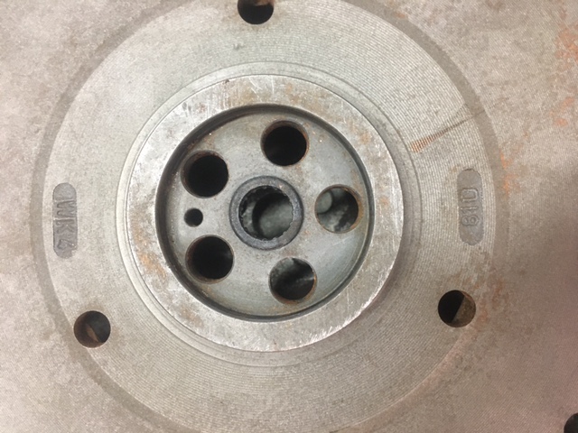

Same diameter, clutch size is smaller then 914! And see the stamping numbers. 810-WK4
