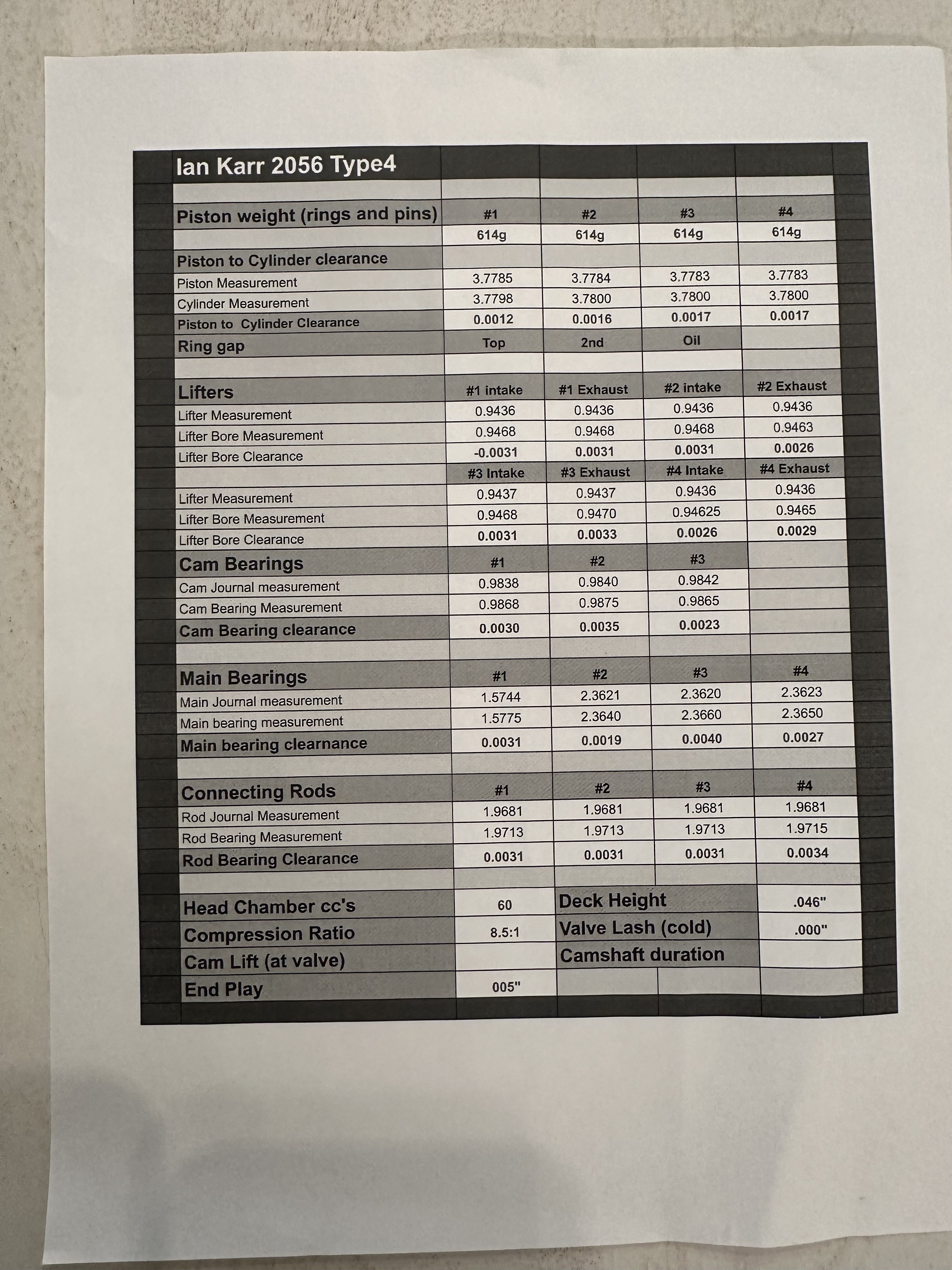

Geezer914
What were your final main bearing clearances with the second block?
iankarr
Here’s the build sheet…
