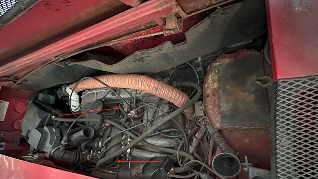

looking at the throttle body vac hose connection to dizzy advance can its a EC-B engine.
can see the emissions sticker is still there on left hand side of engine bay.
likely says EC-B on that. 49 states emission set up.

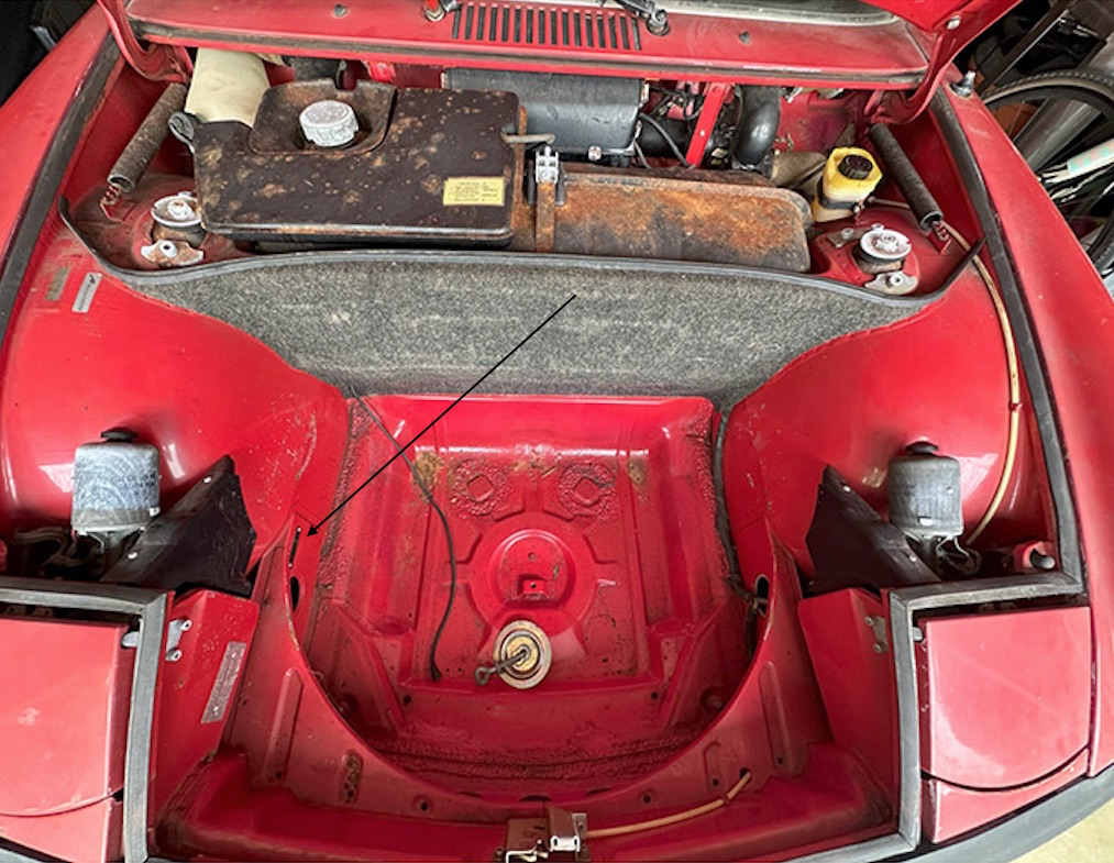

can even see its a car with the production number plate rivetted in front trunk rather than engraved in rear trunk. thats a valuable bit of data for @davep who is trying to track when that plate is introduced and pin down a day and a week of production.
there is a bit of data there if you got time to check out a few things.
good luck with the job to bring her back.
yes! all correct, my frunk no plate pic came out fuzzy but its there.
Indeed, this car is the earliest with the tag that I know of. Importantly it moves the date to week 17, and in week 16 I know of one car with the holes punched, but no tag yet. Please get a good photo for me.

hey - thanks for all the photos @_stickykitty79_
the plate @davep is talking about is the dark coloured one down on rhs of trunk (ie same side as the headlight bucket manufacturer plate. its down there in the spare wheel well area. don't really need a photo of it, can see it in the photos you already posted at start of topic. it will have the same number as the karmann plate in the lhs door you photographed. dave's now got those numbers and can date the car to when the plate first started appearing.

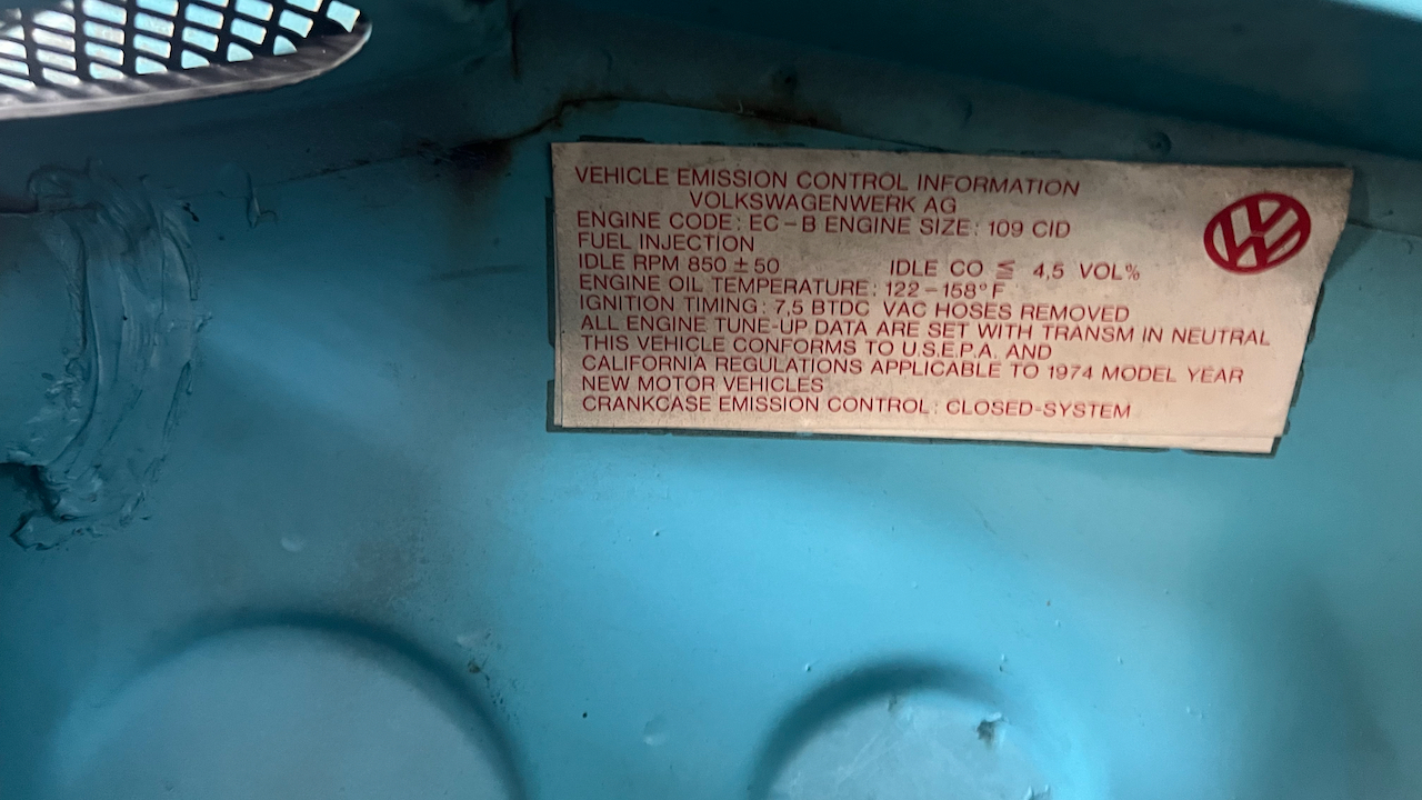

there is one other little date threshold i am chasing and its the emissions sticker.
thats the white label with red writing that is on the lhs side of the engine bay.
its hidden up there just below the side top panel where the engine lid edge is.
i can see it is there from the photo collage. if you could take a photo of that and post it - that would be pretty interesting. as going by the vin number on your car its also close to a date when that sticker got updated due to what i think was an EPA directive.

this is the plate @davep is talking about @_stickykitty79_
i see dave would like a good photo of it if possible.
congratulations - you got a car that popped some valuable data. beerchug.gif

my car is a 74: 4742913488 (40th car built Tuesday, Jan 29 1974?)
originally a 1.8 (now a 2.0)
no tag in the spare well.
and here's my emissions sticker.
To me, it looks like there is a sticker on top of a sticker. I haven't really investigated but happy to if it helps add a data point:
(apologies for the hijack...)
