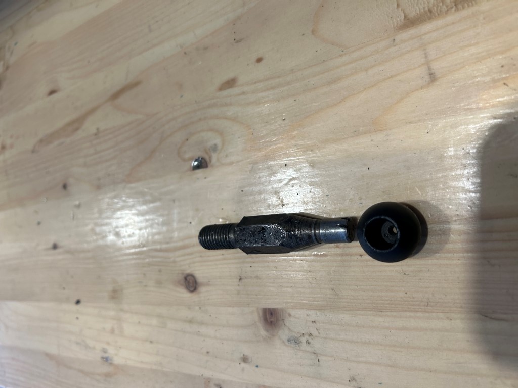

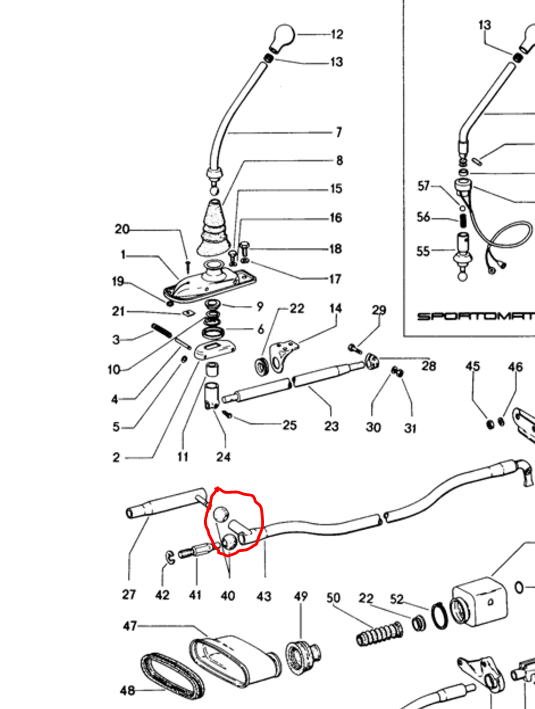

PaIsa
Jan 13 2025, 10:05 AM
QUOTE(bdstone914 @ Jan 11 2025, 10:29 PM)
Not clear as to what you are asking. Is this a tail shift or side shift? A picture will help.
Very true that it is not clear. I had a nice snap shot of the part diagram that I forgot to attach.
It is for a tail shifter. Here is the snap shot and a picture.
So I do I get the black ball on the steel ''shaft''?

Jan 13 2025, 11:02 AM
Light grease and tap it on with a plastic mallet. A very small hole drilled through the top of the ball will help reduce the effort needed and not effect performance
PaIsa
Jan 17 2025, 07:52 AM
QUOTE(mepstein @ Jan 13 2025, 12:02 PM)
The problem I have is to get a good hold/grip on the ball to keep it align while I am trying to tap it on the steel shaft. I don't want to use pliers that will damage the surface of the ball so each time I try to tap it, I loose grip on it and it goes away. Any other option to keep a good grip on this ball???
ChrisFoley
Jan 17 2025, 11:23 AM
Do them at room temperature.
I use a one ton arbor press, but it is very tricky to keep perfect alignment so the shaft goes in without pushing the ball to one side.
A bit of fixturing to keep things on center would go a long way to making short work of that task.

PaIsa
Feb 1 2025, 04:46 PM
I finally got one installed using some grease and some convincing argument.
Tried to get the other one installed using the same method but it broke. Will have to order another one and try again!
rhodyguy
Feb 1 2025, 05:34 PM
Use vise grips and a shop rag to securely hold the ball and not mar it.
