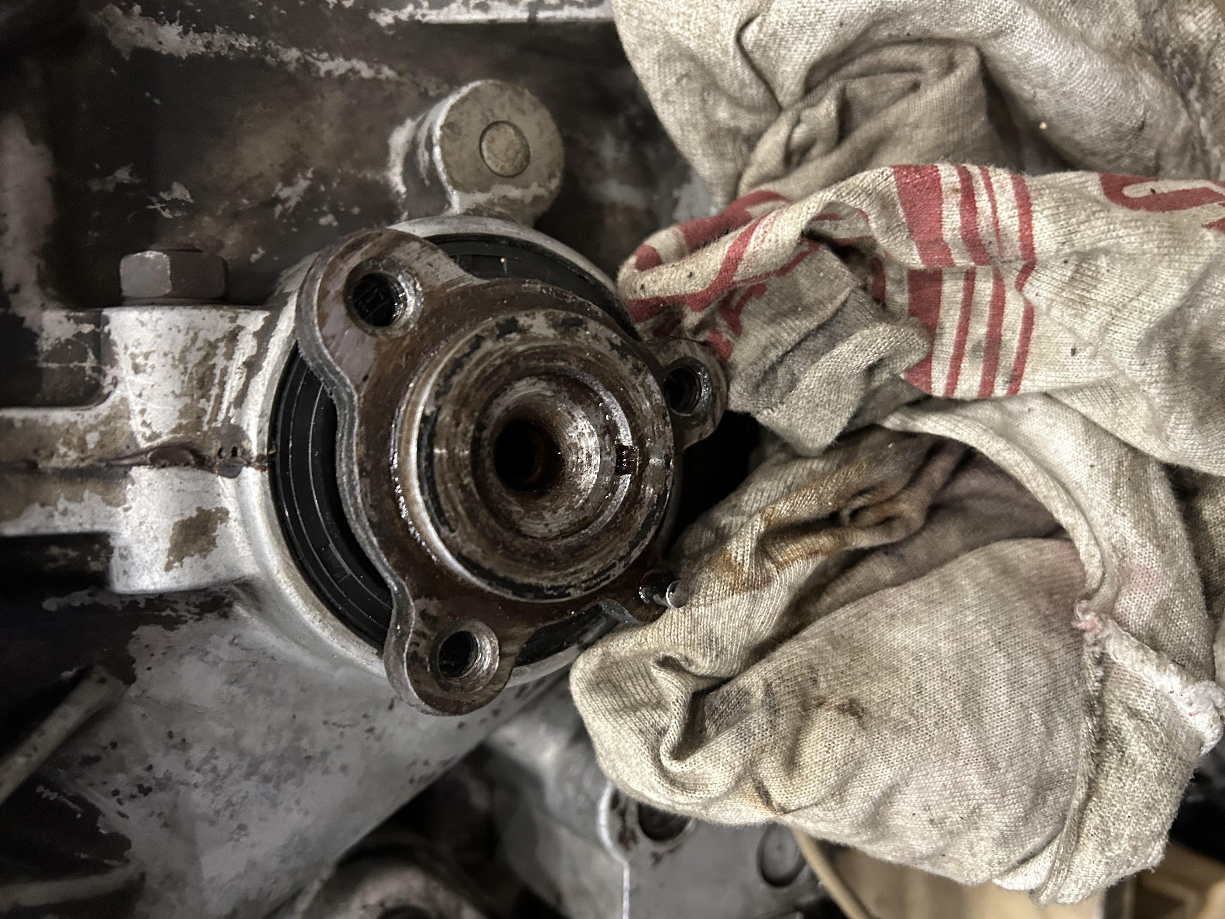

I was planning on replacing the seal on the fan side of the main shaft but I am having some trouble getting the fan hub.
For now, I have applied some penetrant liquid on it and I will let it soak some time, but then, what is the best way to get it off.
Lightly prying it off going around? I guess that a puller would be useful, but I only have a very large puller that does not fit there. Can I apply some heat in trying to get it off?
Any other tricks or advice?
Thanks

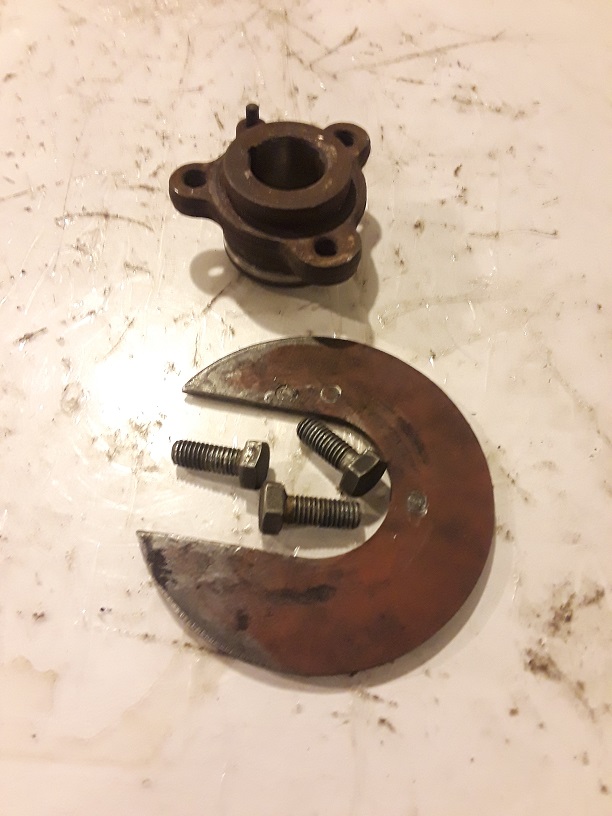

Not near the garage/workshop today, so can't take a photo of the homemade tool.
But it's a pretty simple tool to make. A piece of thick sheet metal with a slot the width of the crankshaft snout cut into it. Then harden it.

Here's the super-specialized tool that works a trick:
A "church key" bottle opener, or another thick, flat piece of metal.
The three fan mounting bolts.
Hold the church key up behind the fan hub. Thread in a fan bolt until it touches the key. Give it 1 complete turn. Loosen it a bit, move the key to behind the next hole in the hub. Thread in another bolt until it touches, then give it 1 turn.
Continue this process, going around to each of those three holes, until the hub pops off. Shouldn't take long.
For the extra-fancy version, you can use three church keys or fender washers. That way you don't have to back off the bolts to move the key.

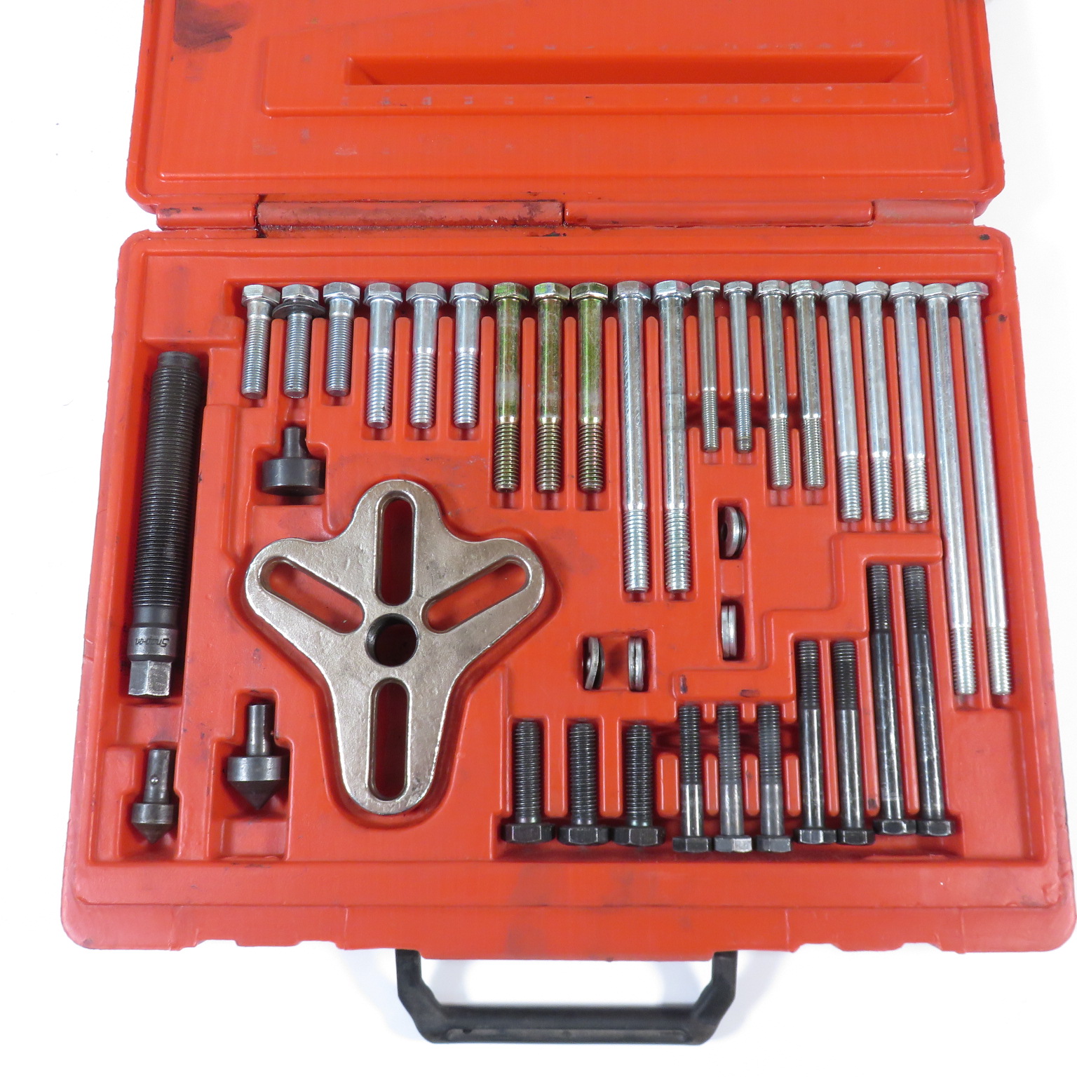

This is what I use:
IPB Image
Snap-on bolt grip puller set. Bought mine years ago. Silver bolts are SAE, black bolts are Metric. Mine has a socket on the puller that got stuck on there 30+ years ago and I never bothered to remove it.
