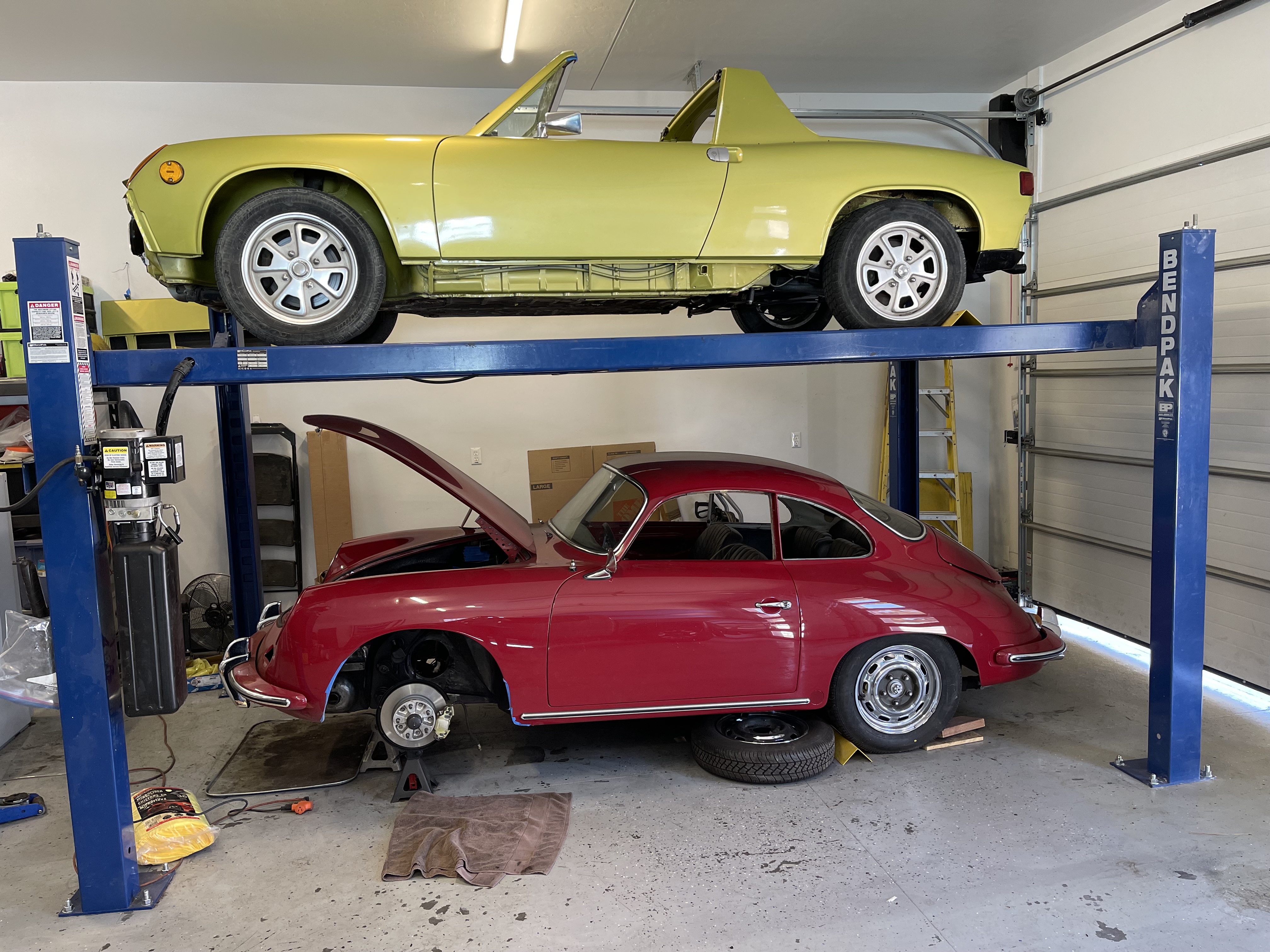

Thank for all the feedback on the idle searching problem. The searching starts as the cold idle ends. The fluctuation is back and forth every few seconds. I have not driven since rebuild. Only did the cam break in. I did clean the throttle body and distributor, but did not do any rebuilds on these items. I did just complete brake system rebuild and should be able to drive soon. Some had mentioned the rubber vacuum which is new. I also tried adjusting the ECU, but not sure of the proper techniqueClick to view attachment

Beautiful Paint Job - do you have a color number? Is it an original color?
