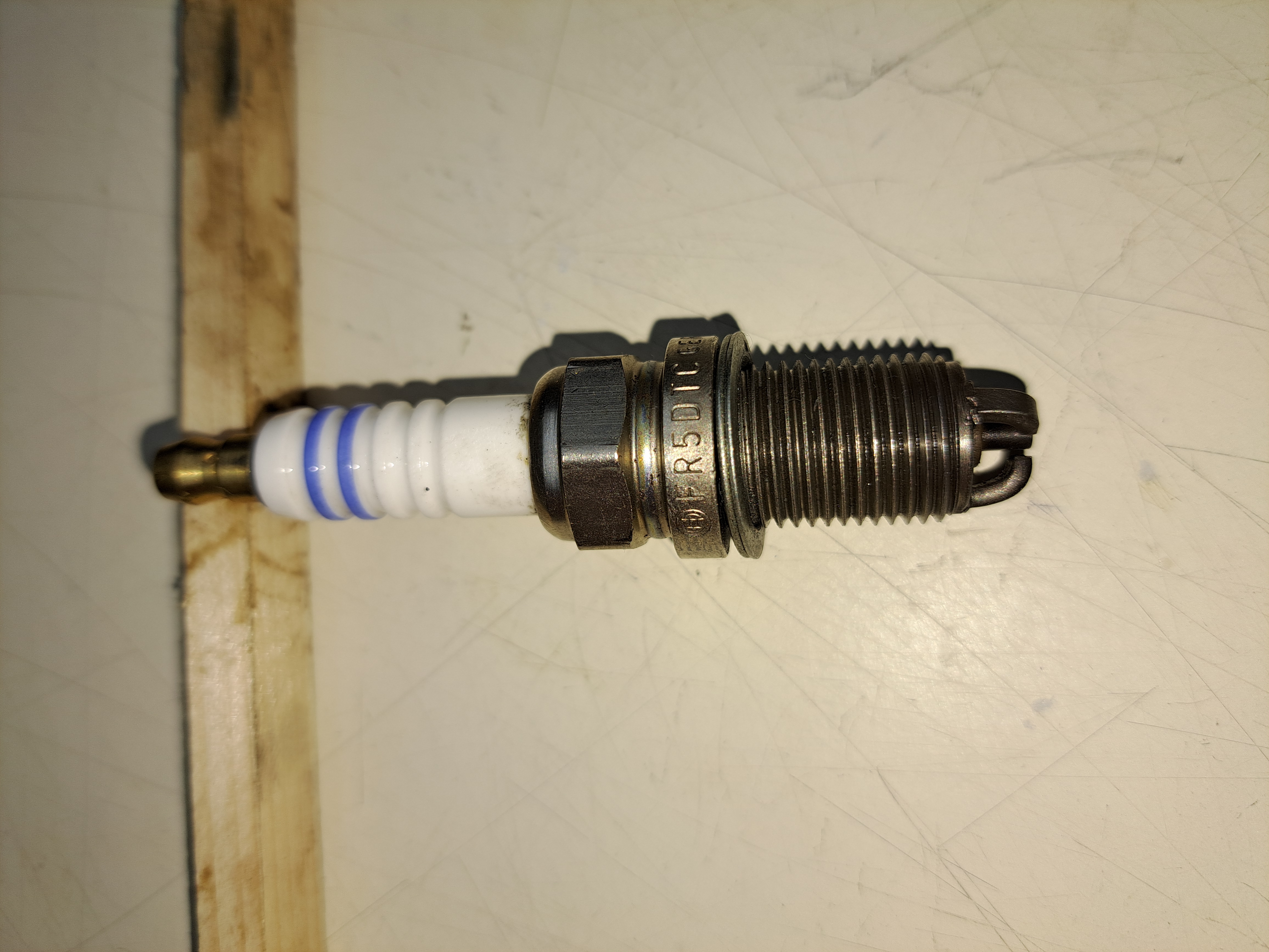

These spark plugs came with an engine I am rebuilding. What are they and is there any benefit to this type of plug?
Superhawk996
Multi electrode spark plugs impair initial flame kernel both by blocking it as well as quenching it.
It was a dumb aftermarket idea that never really panned out.

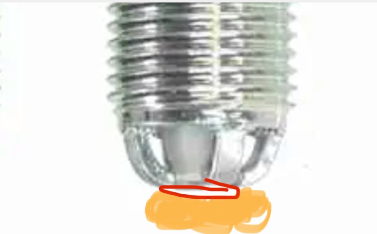

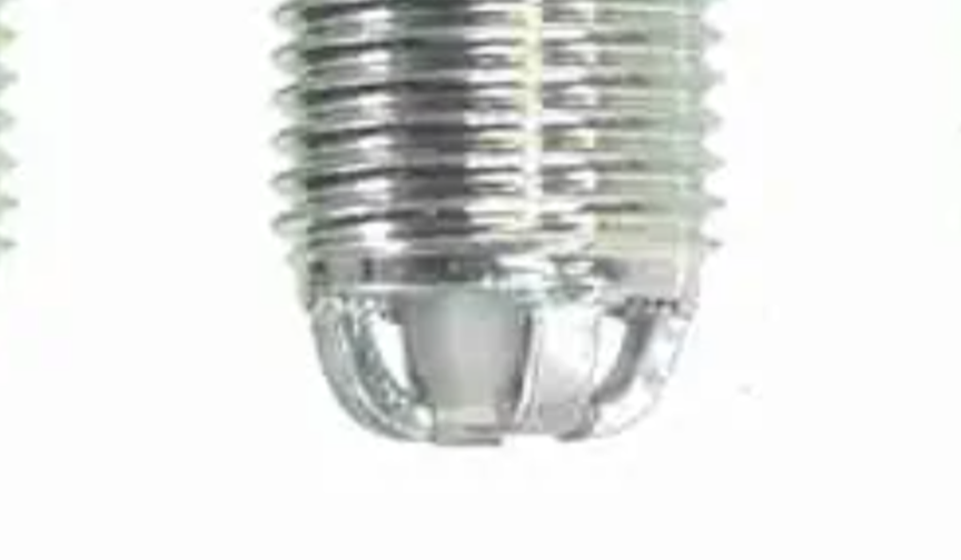

This is sort of a weird one. I didn’t look up online but it almost looks like another iridium center electrode?
emerygt350
QUOTE(Superhawk996 @ Feb 8 2025, 11:33 PM) *
I think so, it just has ceramic all the way up, very odd. maybe it keeps the spark between the very tip. I could imagine the OPs might be sparking all kinds of strange places.
I would think all of those extra surfaces inside your chamber can only lead to badness in the end.
Superhawk996
QUOTE(emerygt350 @ Feb 9 2025, 02:59 PM) *
I think you are in on right track. That design keeps the spark jumping the gap at the very tip and will largely have the flame kernel starting (orange) outside the ground to electrodes and won’t quench the flame as much as the OPs plug design will. Iridium largely shielded by the ceramic to limit where the spark can jump (red zone).
Decent link:
https://www.autolite.com/knowledge-base/pos...ode-spark-plugs
QUOTE(Superhawk996 @ Feb 8 2025, 09:58 AM) *
Wait, are you trying to tell me marketing hype is not the same as actual engineering?
