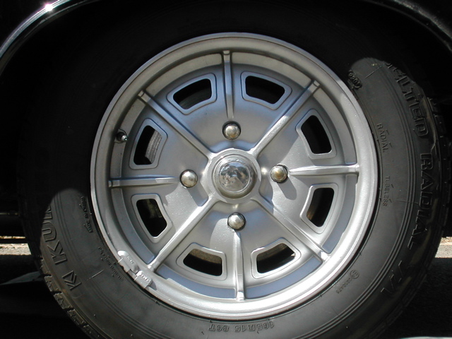

After dropping off my Fuchs to be restored it got me thinking about the Mahles sitting here in my study.
Anyone ever get a set anodized? polished lips with black centers maybe?
It would be cool i'm thinking, like the Factory fuchs finish.

oops. I was referring to the 4 bolt ones.
Those are great wheels too.
Too man calories for me though.

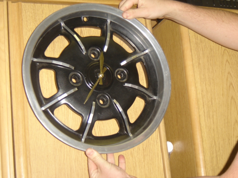

I dig those black Mahles in the picture....
the 4 luggers might look just as trick with the same concept

like my clock mike????

Did they make a 4 bolt Mahle? Could someone post a picture of a 4-bolter and possibly a Pedrini (spelling) for my comparision sake.
-Britain

Aaron's clock is a 4-bolt Mahle.

The Pedrini has spokes that line up with the bolt holes. Th mahles don't. The Pedrini has spokes that reach the center ring, the mahles don't. Pedrini has smooth spokes, Mahle has stepped spokes.
