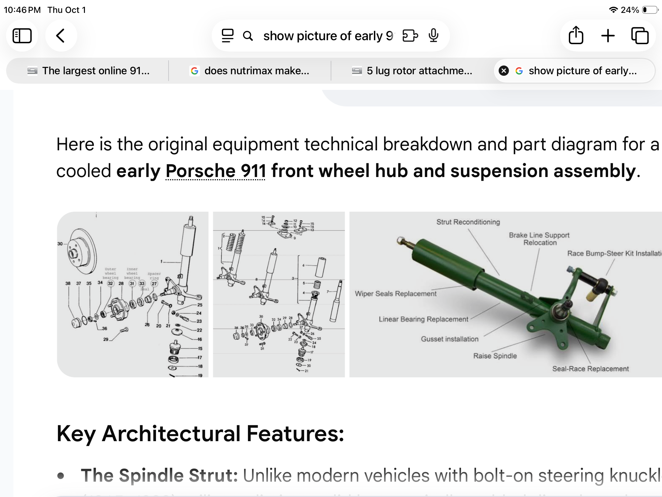

Here’s a photo with the hub. What hardware is used to attach the rotor where the screwdriver is inserted? Do I have this right?

Here we go, grade 10 with wave washer m8 x 25 since that’s what they had, fits perfectly. Needing new wedge pins to get closer to install.
