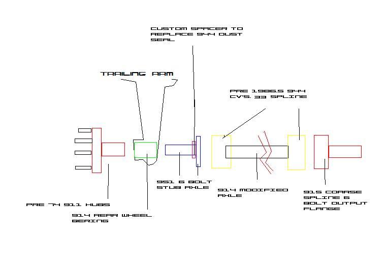

Aaron Cox
glad it came out that way ron.
i have the stub axles from a 951. thats as far as i have gotten.
Aaron Cox
and here is the drawing....
user posted image
mightyohm
And the award for "most unreadable font of the year" goes to......
nomore9one4
nomore9one4
QUOTE (jkeyzer @ Nov 8 2005, 12:43 PM)
smilie_pokal.gif But very pretty colors!
