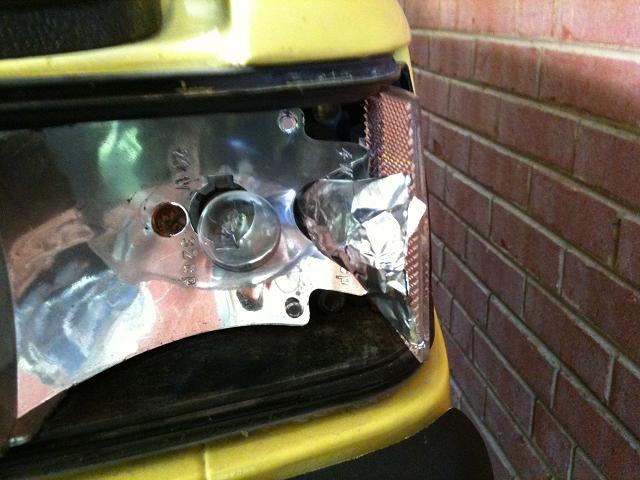

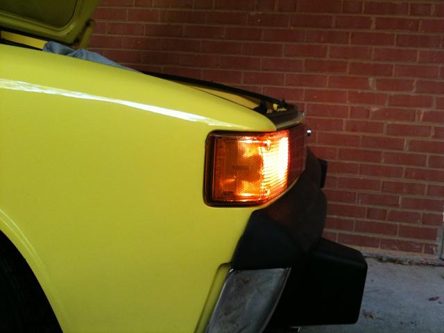

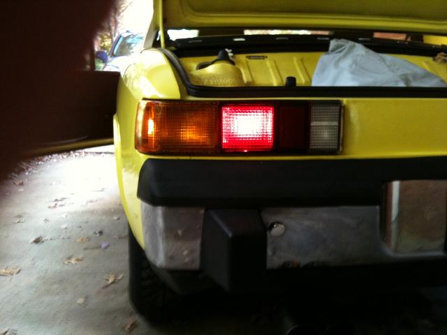

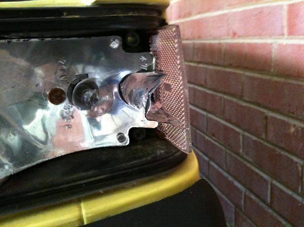

For those who are interested, I came up with a cheap fix to this problem. I took a small (doubled-over) piece of aluminum foil and shaped it around the corner marker light, so that it shines only out of the side, and doesn't illuminate the rear-facing turn signal section.
Below, illustrated via cell-phone camera.
First, curved piece of foil around the corner marker light.
Click to view attachment Then, "close" end of of foil against side-facing reflector surface.
Click to view attachmentResult: reduced glow of turn signal when tail-lights are on (although from side view, the corner marker is amber)
Click to view attachmentAnd for the curious - I made sure that the turn signal, when lights are off, isn't obstructed in side view due to the foil. This is a shot of the turn signal blinking, headlights/taillights off, from side view.
Flip, an ingenious cost effective solution. I have often wondered about the legality of running ambers at night - and the RCW provided the answer.
I modified your solution to flare out from the bulb to the end of the divider tab, so the bulb illuminates the entire side area without reflecting back into the turn signal area. Works great.
Thanks for the brilliant idea.
