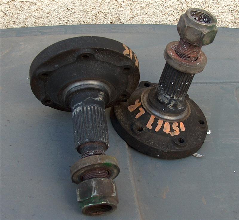

I have been readin up on the 944 CV joint threads and thought to myself... "I wonder what stub axles my car has." Right now the project car has an unfinished rear setup. There are early 911 hubs (according to P.O.), and some vented rotors, bearings, and some kind of stub axle. In addition there are some 944 drum brake parts installed.
I have no idea what kind of stub axle they are since they are installed. However, they do have 6 threaded holes. How can I tell what type of stub axles I have? Is there a measurement that I could make, for instance the diameter of the rin gon which the holes sit?

6 threaded holes.....
either 944 or a 911.
you already have 5 lug hubs?
take a pic? measure the OD of the stub. i / we can figure it out from there

Here's one of them...

The 100mm figure is for the diameter of the flange, and 86mm is the diameter of the imaginary circle on which the tapped holes sit.

Those aren't that early. I've got early big flanged hubs on mine which are 110mm. If they are 100mm you can use early '80's, iirc pre-'85 cv. '85 is when they went back to the larger 110mm.

Those may be mid '74-'75 911 stubs like I have. They should fit in a 914 trailing arm, but you'll need some spacers to make them work (Patrick Motorsports parts PMPCASPI & PMPCASPO)

tony... the stub axle has a PN on it
that LOOKS like the 944/051 stubs i have

Aaron Cox
Nov 17 2005, 02:35 PM
i call tony's set, 911 6 bolt stubs. not 4 bolt 2 pin...
so that makes it ??late 911???

It looks like Tony's set are from a 911 (just like mine). Look at the flanges. Tony's are notably thinner than the 944 Stubs shown above.
some of the spacers required with the 944 stubs take the place of a seal (i believe). This seal is not present on 911 stubs.
