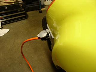

Here is a test image. I have many images to do so a short lesson (if it really is easy for idiots) would be great!
user posted image
by the way this image is in my blog with two different resolutions if that matters.

this is what that image will look like.

Here's something easily done...
How I did it:
Put the picture in Photoshop
Resize it to 320 x 240
Image > Mode > Grayscale
(Choose "Flatten Image")
Image > Mode > Bitmap
(Keep the default settings, and click "OK")
I'm sure there are different ways that can produce better results, ask them!
seanery
This is the method I used.
1. Open Image
2. Convert Image to Indexed Color with 3 colors - click "Image" "Mode" "Indexed Color" select 3 for # of colors
3. Convert Image to Grayscale - click "Image" "Mode" "Grayscale"
4. Convert Image to Bitmap - click "Image" "Mode" "Bitmap"
5. Save image as .bmp, tiff, gif, etc...
seanery
you can see the slight difference in methods, just pick the one that suits your look and have at it!
