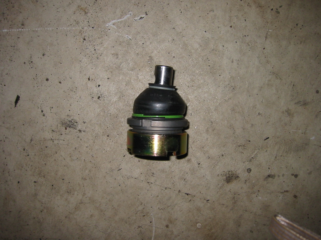

If they don't look like this....
user posted image

I have a set that came w/ the car from the PO .. I just need to be sure they are the right ones....
I guess the torgue spec is a little ominous too ...
