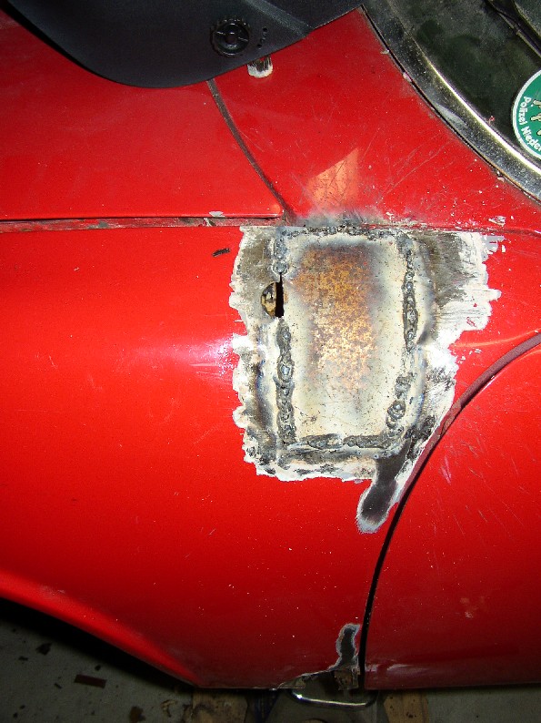

The left door handle recess was all bondo and hence pulled out. I fabbed and welded in new pieces. It did come out better than in the pictures and it now totally finished.
user posted image
door gaps are good too. if i find the before pictures i'll post them. the above picture is just at the beginning of the work. its my first metal repair so please be nice. lol.
user posted image

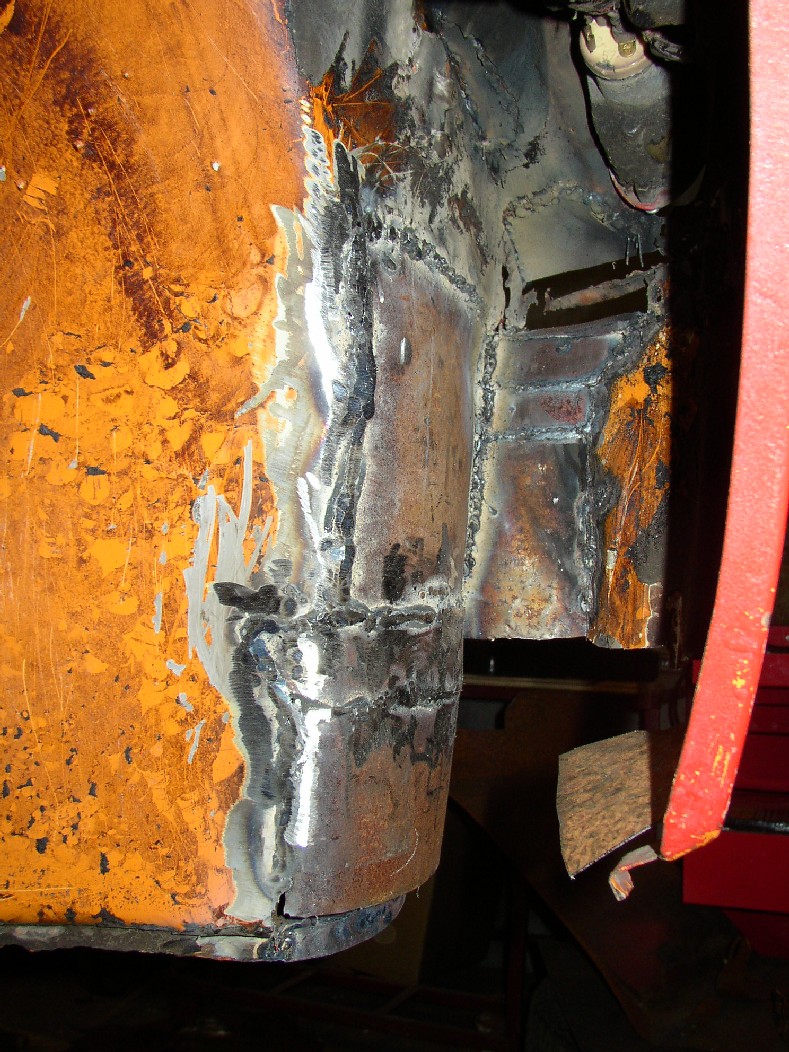

jd74914

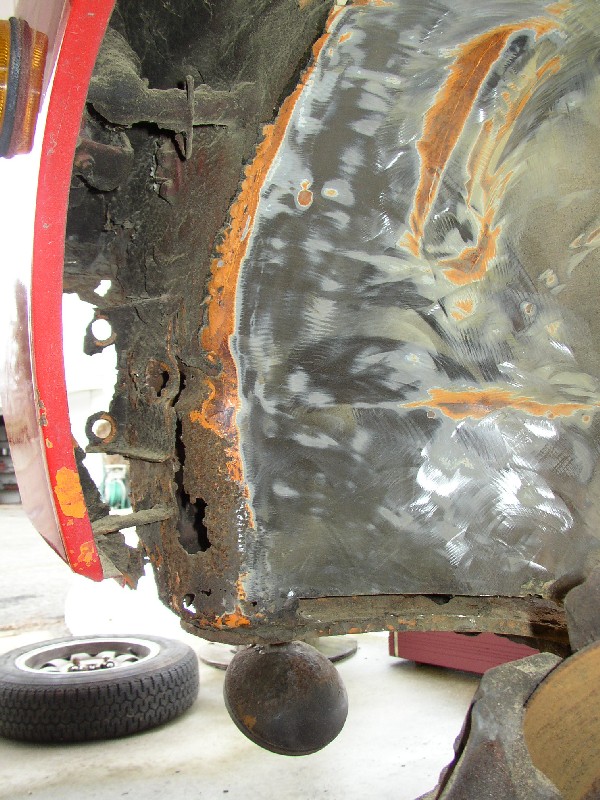

Both door sills were gone. Here's one halfway through repair. They look very close to factory now with the edges on them. Pics of that later
user posted image

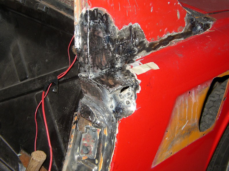

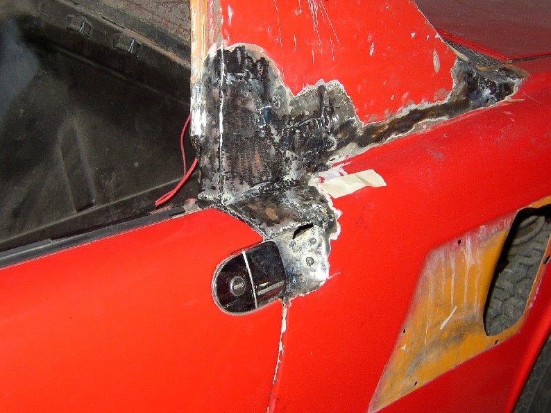

the messed up right sail panel. i fixed all of the bracing behind it too.
user posted image
I guess i don't have pictures of the finished repair. i'll post some of those soon.

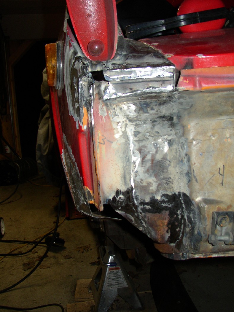

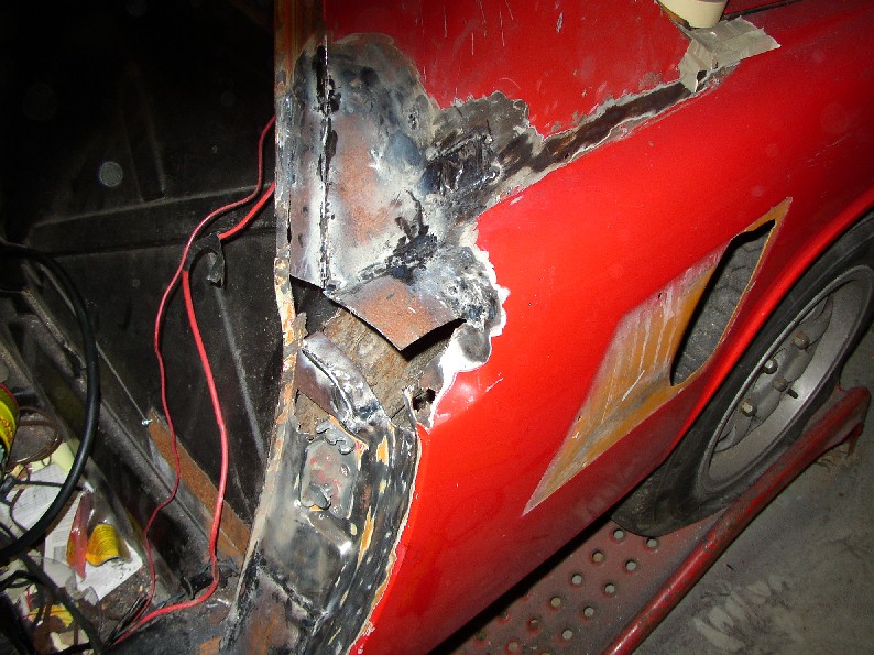

messed up left fron quarter. before.
user posted image
during cut out
user posted image
during welding. now its ground down. finish pictures soon
user posted image

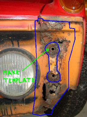

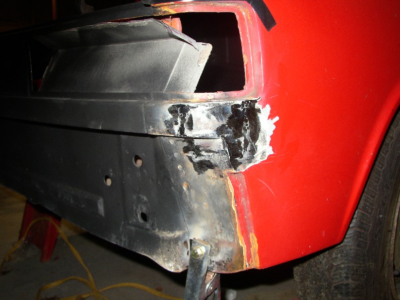

Both bumper mounts look like this. The pictures for both sides are interchangable since I did the exact same thing. I cut out everything, made templates, welded it back in again, ground the welds and painted. Hopefully I have pictures of everything. If not, as before some will come later
user posted image
user posted image
user posted image
almost there
user posted image

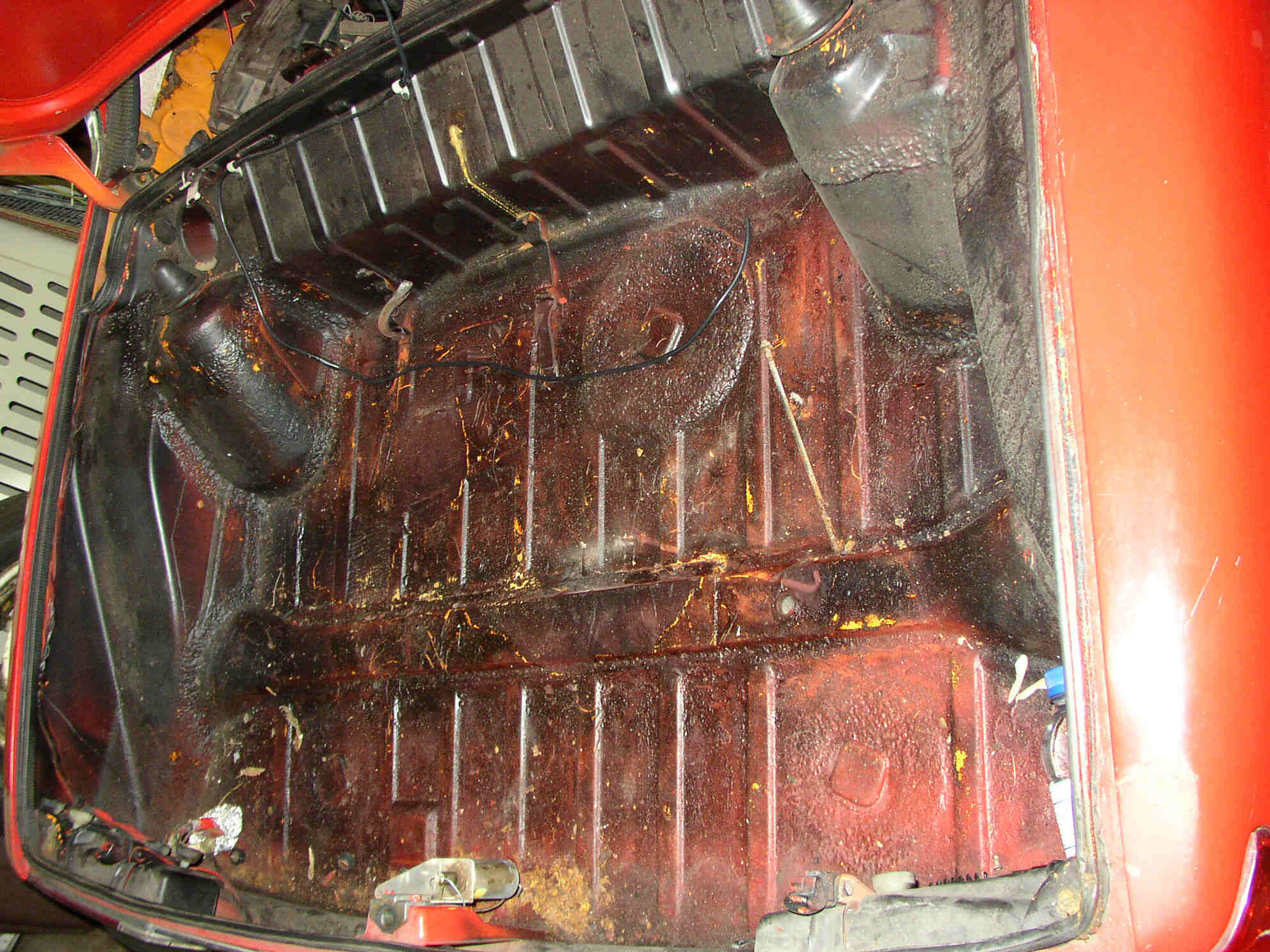

Now for a little from the trunk and rear panel.

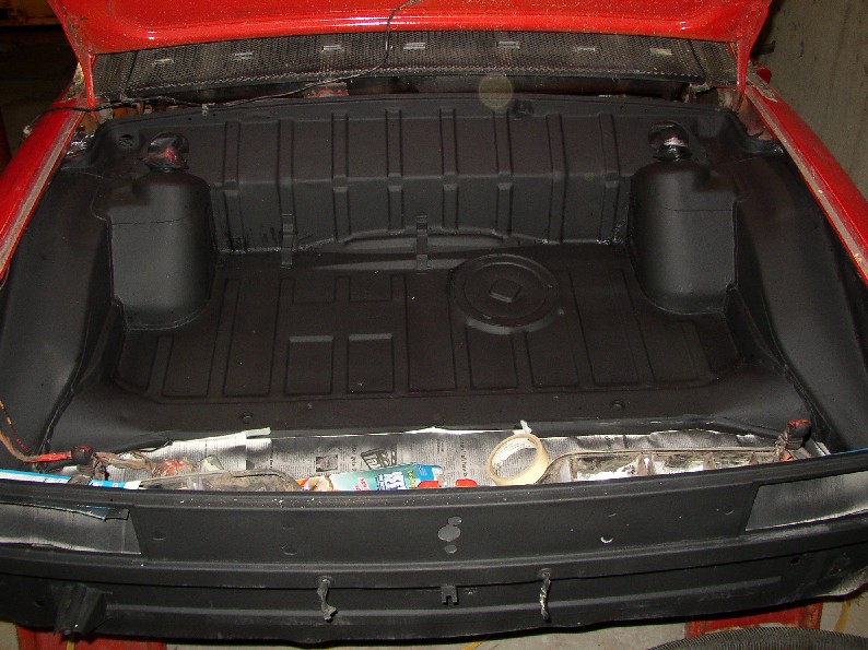

Trunk with paint... I stripped it off before welding on the bottom and repainting. No pictures stripped tho dry.gif
user posted image

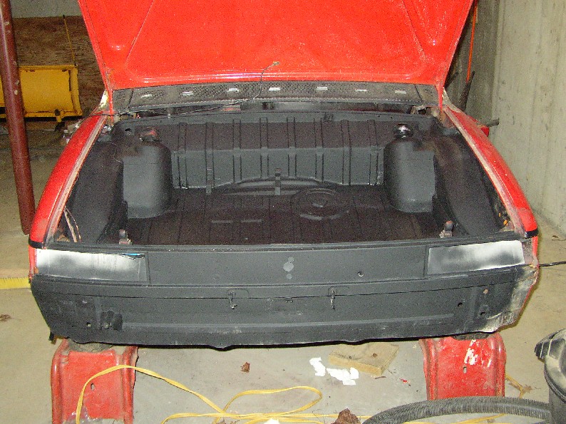

a little panel repair
user posted image
paint. . . tougher paint is going on the bottom half, thats why its masked off.
user posted image
user posted image
