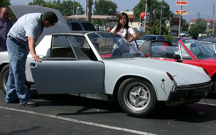

Sep 15 2003, 11:20 AM
jenny got 7" all around with 205 tires. the offset is custom (rewelded steel wheels) and it is a VERY tight fit, but looks great!
Jeff Bonanno
Sep 15 2003, 11:23 AM
gun show?
Sep 15 2003, 11:26 AM
QUOTE(Jeff Bonanno @ Sep 15 2003, 10:23 AM)
gun show?
naa, we didn't make it to the gun show.
ihop was just way too tempting
