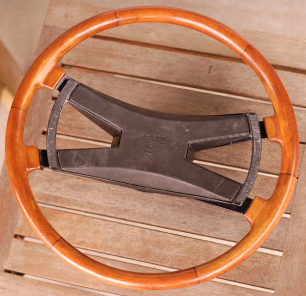

seanery
This Thread has some info and pics....including this one of mine (horn button has been replaced since pic):
IPB Image

As I understand it, wood steering wheels come in several flavours. Some of the more common ones are essentially constructed like plywood i.e. cross grain laminations that make up the wheel. I suspect that splintering would be much less an issue with these. Downside is, they don't look as good as the more traditional wheels.
The nicer wheels are made from thin laminations that are bent all around the wheel. The grain of the wood goes around the whle wheel. Those are the wheels that could splinter the worst, but they are also the best looking. I could be wrong but it looks like Garold's wheel is like that.
Finally, there's wheels that are carved from solid blocks of wood, in several pieces and joined together. Seanery's wheel is like that, I believe.
