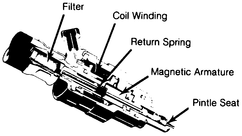

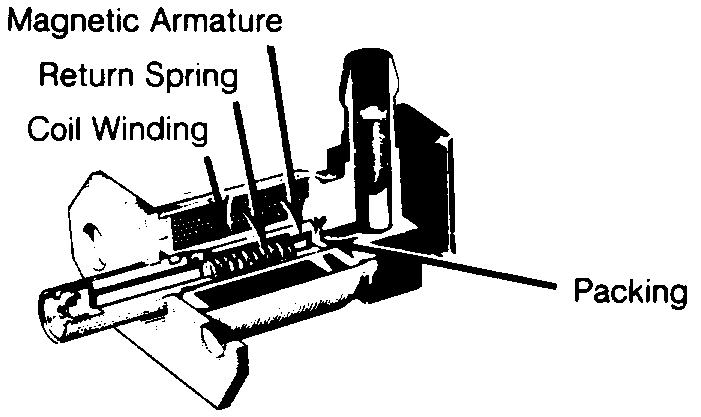

An electrically driven fuel pump forces fuel through a filter, into the main system. Main system consists of one injector for each cylinder, a cold start injector and a pressure regulator, which maintains fuel pressure at 28 psi (2.0 kg/cm2). A secondary system carries excess fuel from the pressure regulator back to fuel tank.
Fig. 1: Sectional View of Fuel Injector
Fig. 2: Sectional View of Cold Start Injector

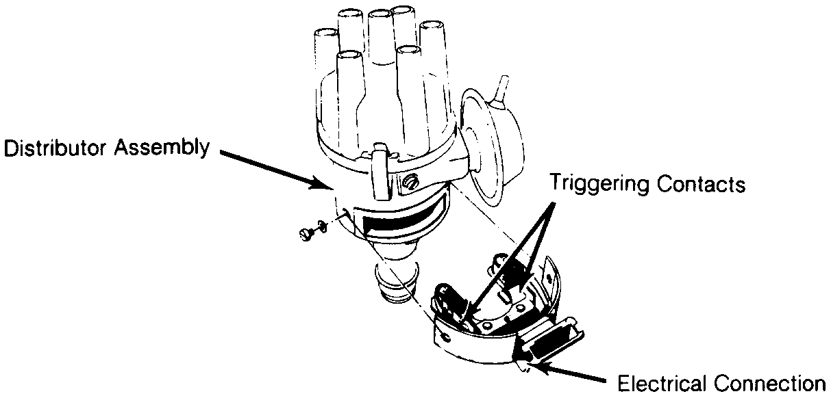

Triggering Contacts
The triggering contacts are located in the distributor. They provide signals which determine when and to which cylinder fuel is to be injected. The contacts also supply information concerning engine speed to determine the amount of fuel that needs to be injected into the engine.
Fig. 3; Triggering Contacts & Distributor

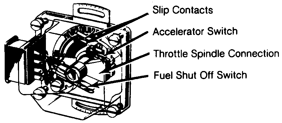

Throttle Valve Switch
The throttle valve switch is mounted on the throttle housing. This switch signals the control unit of throttle position. During deceleration, above 1500 RPM, throttle switch cuts fuel supply off and below 900 RPM, fuel supply is turned on.
Fig. 4: Throttle Valve Switch Assembly

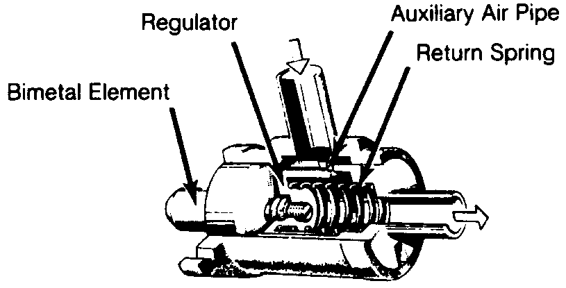

Auxiliary Air Valve
During cold starts, the auxiliary air valve opens to allow additional air into the inlet duct. As engine heats up, a bi-metallic element expands and closes valve. At approximately 140°F (80°C) the auxiliary air pipe is completely closed by the valve.

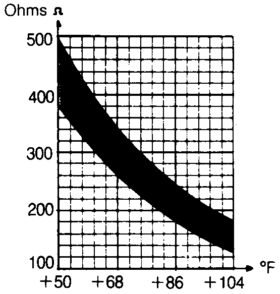

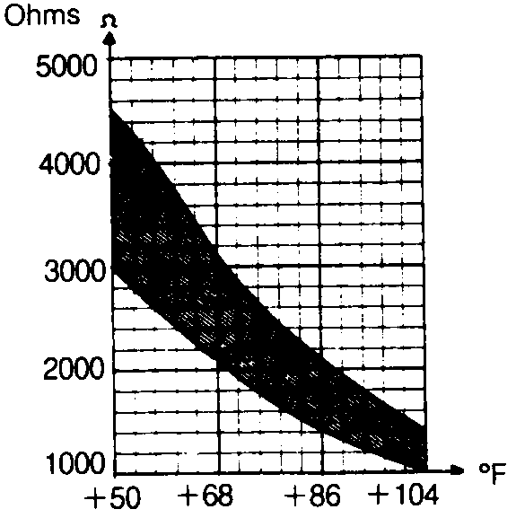

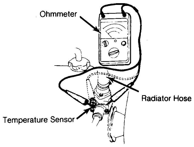

AIR & ENGINE TEMPERATURE SENSORS
Disconnect electrical connectors of each temperature sensor. Use ohmmeter across terminals of sensor. If engine temperature is 68°F (20°C), air temperature sensor should have resistance of 260-340 ohms and engine temperature sensor should have resistance of 2100-3100 ohms. Each should have infinite resistance between terminals and ground.
Fig. 6: Air Temperature Sensor Resistance
Fig. 7: Engine Temperature Sensor Resistance
Fig. 8: Test Connections of Engine Temperature Sensor

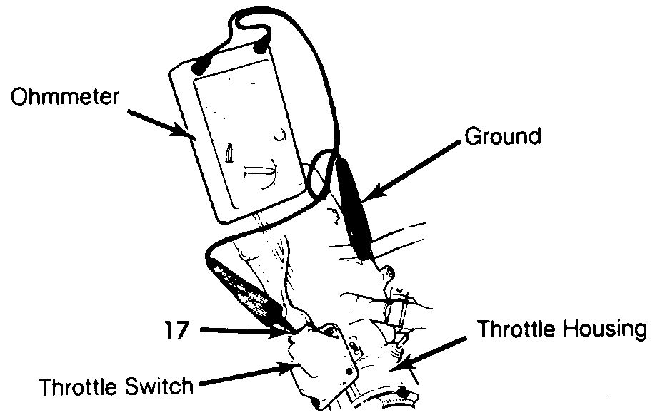

THROTTLE VALVE SWITCH
NOTE
* If throttle terminal has voltage at all times, replace switch. If switch has no voltage, either before or after adjustment, replace switch.
1) Remove air cleaner. Loosen lock nut on throttle stop screw and turn out screw until it no longer touches throttle boss. Check that throttle is completely closed and throttle bore is clean. Screw in stop screw until It just touches boss, then turn it one additional full turn. Tighten lock nut.
2) Connect ohmmeter to terminals No. 9 and 12 of ECU connector. Depress accelerator slowly. Ohmmeter should fluctuate from zero to infinity. If zero reading only, replace switch.
3) Place accelerator at idle. Connect ohmmeter between terminals No. 12 and 17 of ECU connector. Ohmmeter should show continuity (zero ohm). If infinity reading is achieved, check throttle valve adjustment and/or check for open circuit. If infinity reading is still achieved. replace switch.
Fig. 9: Test Connections of Throttle Switch
4) Slightly depress accelerator. Connect ohmmeter between terminals No. 12 and 17 of ECU connector. Ohmmeter should show infinity. If continuity (zero ohm) is achieved, check throttle valve adjustment and/or short in wires. Disconnect throttle valve switch and check ohmmeter reading. If continuity (zero ohm) is still achieved, and wires are okay, replace switch.

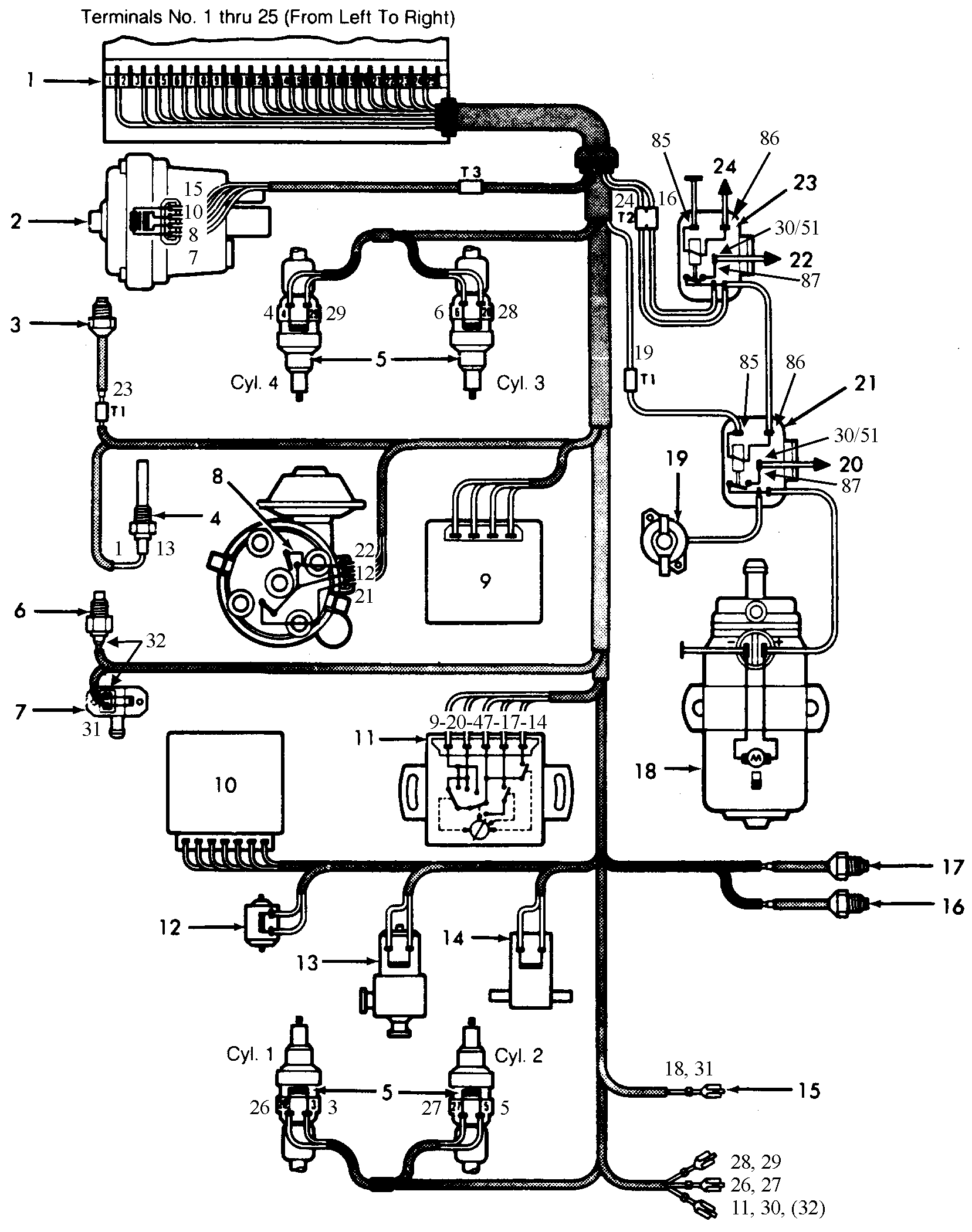

NOTES for Fig. 10: Typical 4-Cyl. Bosch D-Jetronic Fuel Injection Wiring Diagram
1. ECU Connector
2. MPC Sensor
3. Cylinder Head Temp. Sensor
4. Intake Manifold Temp. Sensor
5. Injector
6. Thermotime Switch
7. Cold Start Valve
8. Distributor/Trigger Contacts
9. Engine Speed Relay (1972 models)
10. EGR Switch Unit (Some models)
11. Throttle Valve Switch
12. Vacuum Advance Disconnection 2-Way Valve
13. EGR Valve
14. Air Valve for Auxiliary Air Supply (1972 models)
15. From Starter Terminal No. 50
16. EGR Thermoswitch
17. A/T Oil Pressure Switch (1972 models)
18. Fuel Pump
19. Auxiliary Air Valve (If Equipped)
20. To Fuse Box Terminal No. 30
21. Fuel Pump Relay
22. To Battery
23. Main Relay
24. To Ignition Switch Terminal No. 15 or Ignition Coil Terminal No. 15
Fig. 10: Typical 4-Cyl. Bosch D-Jetronic Fuel Injection Wiring Diagram (See notes on previous page)
