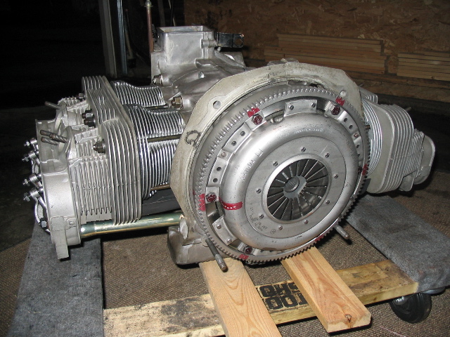

lotus_65
i just went through it, and i wouldn't wish it on my worst enemy (my old boss maybe).
if i was out on the left coast, i would do this (mcmark's $5k rat).
commit to it and don't look back.
