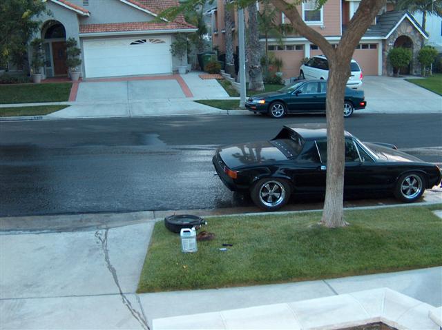

huge oil leak.....
guess where it is coming from.... between tranny and engine...
i must have knocked out the input shaft seal when i put the stack back in.
I hate life. i hate this crap. i have literally pulled this tranny 3x already sad.gif
so.... anyone local got a lift? my back is tired of the asphalt....
gratuitous pics of exxon valdez cleanup and tranny guts will be posted after dinner....

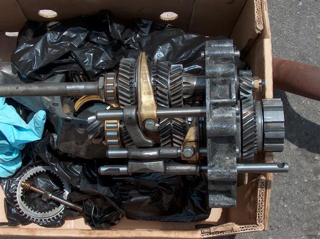

Aaron Cox
the stack!
the cleanup (water and soap)

LESSON LEARNED: DO NOT ASSEMBLE INCOMPLETE TRANNIES FROM A BOX OF PARTS smile.gif
here was the problem....
first gear had an "offset" , making it stick out too far, and had the wrong NEW dogteeth on it.... (911)....
so we swapped a first gear from a 914 and works great.
