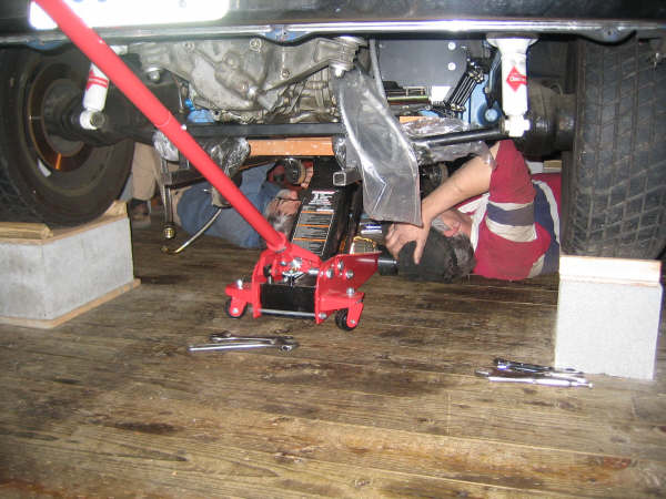

I got my MM's Quick Six "kit" in early January and tore the car apart. I installed steel fuel lines, using the Pelican technical article, and a new low-pressure fuel pump with filter (pictured) up front. I re-bushed the pedal cluster and installed a 19mm master cylinder for conversion next winter to 911 front brakes. I have most of the parts but am still looking for a pair of 6Jx15 cookie cutters. Since I don't need it the return line for carburetors, I plugged both ends. I ran the main line continuously from the firewall under the engine through the stock holes to above the tinware (pictured).
The bulkhead engine mount installed easily using MM's instructions. I spaced the brake pressure compensator out from the bulkhead about 3/8 inch to clear the mount plate and drilled a new 1-inch hole to re-route the wiring harness vertically through the sheet-metal web at the firewall where the rear wiring rises from the tunnel below the tinware to above. This was to keep the wiring harness away from the right-hand front engine mount (pictured) type.gif . I stripped the entire wiring harness from the rear of the car to pull it back through the original hole to thread it through the new hole. Is there an easier way to do this wiring work and keep the stock harness?
Porsh916 (Bill) brought a portable welder over and tack-welded the bulkhead mount in place.

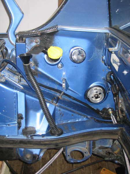

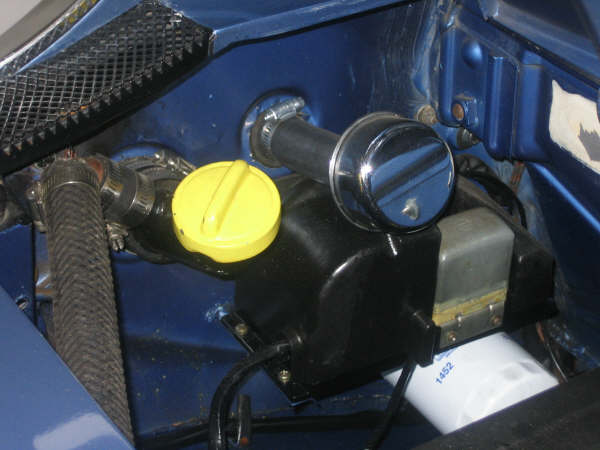

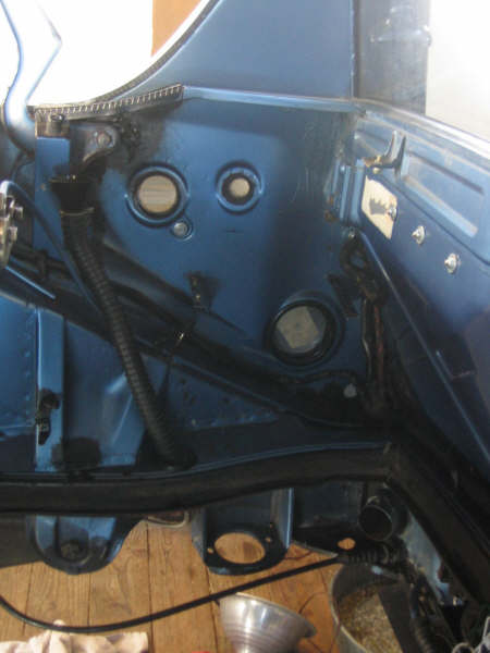

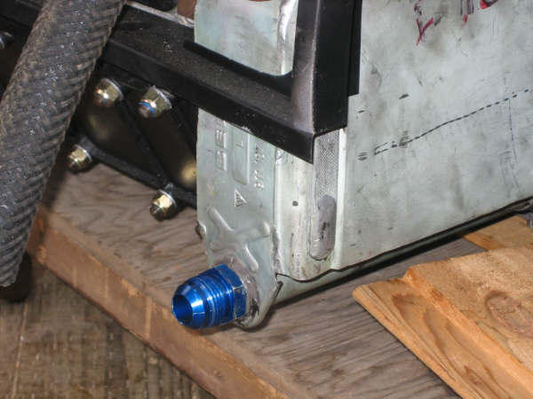

After removing the 4-cyl engine and doing some of the preparation work, came the final irreversible drilling of the holes in the left side of the engine compartment for the oil tank. Took me a couple of days to work up the courage to cut the 4-inch hole for the filter console with a 4" hole saw from the local hardware store. I replaced the saw's 1/4-inch pilot drill with the cut-off end of a 1/4-inch bolt to avoid having the pilot drill enlarge the previously drilled pilot hole while sawing the larger hole.
Motor Meister originally planned to use a Velios tank from Patrick Motor Sports, but they became unavailable by the time to ship the tank six months later. We used Don Welch's 914/6 aluminum oil tank (sold through the club and elsewhere), which came without (the stock) filter console or filler neck. Motor Meister provided some of the extra parts and some I bought from Ottos Venice and the local Porsche garage. I found it best to take all hole-drilling measurements directly from the tank, triangulating the dimensions where appropriate. The pattern in George Hussey's how-to booklet is useless, because the dimensions are distorted by the printing process, which is perhaps why he re-printed the mirror-image of what you need. My measurements landed very near the centers of the bosses in the fender liner. But there is no boss for the lower oil line connector. Don't be chicken: drill it oversize enough to turn the oil line fitting (gently) with a socket wrench.
Mel
The new tank is bigger and more rectangular than the stock tank. It does not fit well with the stock rubber collar for the filter console (Don Welch please take note). I had to trim away much of the rubber to fit. If the narrow part of the tank were carried a little further from the console area, it would work fine. Otherwise the tank seems a better than the Velios tank and easier to install.

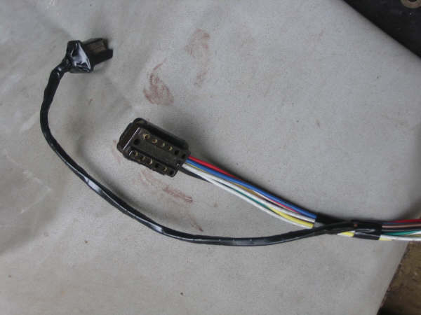

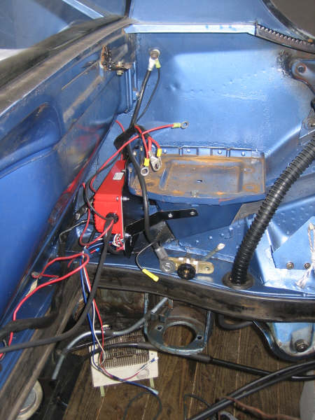

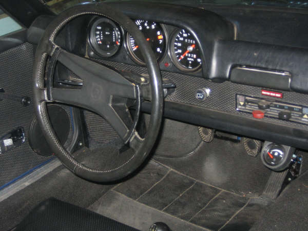

More about my Quick Six conversion: It was almost the end of January when I started on the electrics. I bought 911 gauges on eBay and tested them in my '76 911. I then replaced the 914 combination/fuel gauge with a 911 oil temperature/pressure gauge and the tachometer with a 911 tach. I used the stock engine compartment relay board and stock wiring harness, which requires separate wires to the engine wiring harness connector on the relay board for oil temperature and pressure and from the relay board front harness connector through the tunnel to the dash. The stock harnesses provide only a line for the low-oil-pressure warning light. I mounted a separate fuel gauge to a bracket tucked under the center of the dash with the low-fuel warning light in the instrument cluster in the place of the EGR light from a '75-'76 California car. The fuel pump relay was originally grounded under control of the 1.7L engine computer, not necessary with carburetors. So I ran a jumper from relay board Pin III to the socket for Pin 86 of the (unused) rear window defroster relay socket (see pic), which is grounded to the chassis through Pin #10 of the main harness connector near the front of the relay board. Is this this jumper also used when converting a 4-cyl car from fuel injection to carburetors?
With an engine harness connector and some miscellaneous wiring from Porscha916 (Bill), I wired the engine harness as follows: Pin #1, low oil pressure light sender; #2, backup light switch; #3, oil pressure sender; #4, backup light switch; #5, MSD tachometer sender; #6, starter solenoid; #7, + 12V to distributor and MSD unit; #8 – no pin; #9 – not used; #10 – oil temperature sender; #11 – not used; #12, not used. I ran the oil pressure and temperature sender lines through the chassis harness connector at Pins #6 and 11, respectively. These chassis harness pins are not used in the stock harness but connect in the relay board to the appropriate engine harness pins listed above. I wired the alternator to a stock 914-4 connector and to the stock 914-4 regulator. When I first started the engine, the alternator put out 18V and the generator/alternator dash light glowed faintly; sure signs I had mistakenly reversed two of the alternator connections. I left the original 120mph speedometer in the 914 for the engine warranty period but will swap it for a 150mph unit eventually.
I mounted the MSD unit with tach adapter on a vertical plate in place of the 1.7L engine computer just below the front of the battery.

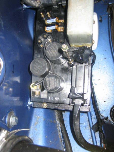

My relay board looks stock 914-4. The 90-degree bend in the breather hose from the engine is a hardware-store pipe fitting. Click to view attachment

Porsha916 and I slid the engine into the car and it started right up. As near to being a turn-key installation as I could hope for. thumb3d.gif
