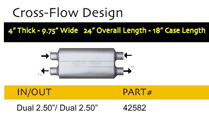

I've been trying to get the Flowmaster "Camaro muffler" that Brad mentioned awhile back to fit on my six (it's twice the flow, half the price and half the weight of an early 911 style Dansk), and it ain't, so far. The picture of the rig that was posted early in the year won't work for conventional 'six headers. The dual in, dual out FlowMaster case is 18" long, my headers are 23" apart, not enough to get decent 90's into the muffler. Am trying to work out a 270 pipe kinda like some of the Bursch (Borla?) plumbing, but not there yet.

The Flowmaster I'm wrestling with is the 80 series 42582, dual in / dual out. It's popular among the 911 track weenies in my "neighborhood".
Tim, the 42585 looks interesting, but I'm afraid the tranny would be in the way of the inlet plumbing. Do you have this one on your car? Any pix possible?
Dave, the 40 series is a single inlet design, can't use in my application.

Brad's info on the flowmaster fab
Brad:
This is what it looks like for a B+B header flange.
FYI: I had nothing to do with the pic below. I know of several companies that sell this setup for big money and slap a plate over the Flowmaster name.
ss6
Oct 16 2003, 01:27 PM
Yep, those are the pics that got me going, looks real easy to duplicate if you have a welder, some flanges, and a couple of J bends.
