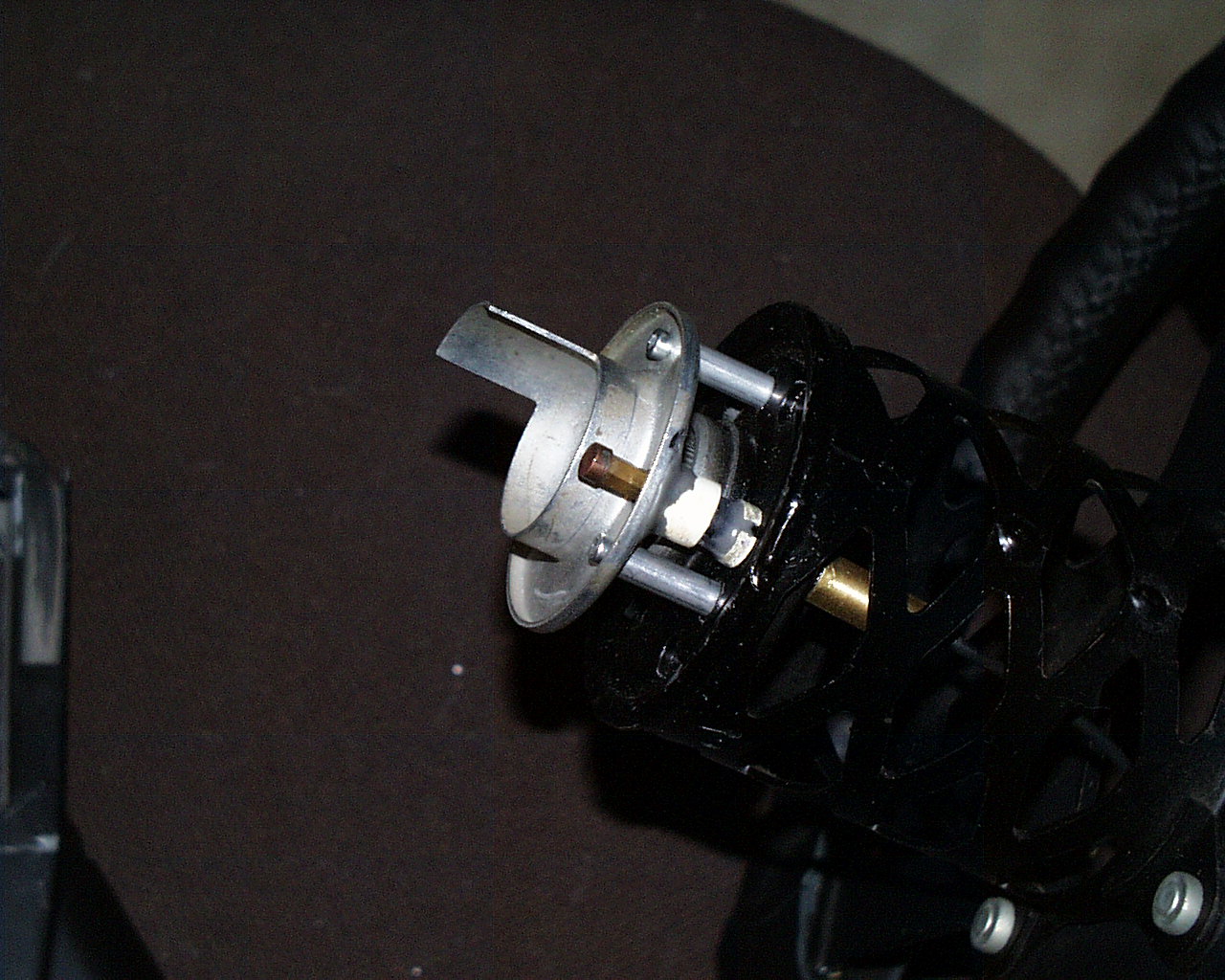

Click to view attachmentHere's a shot of a 911 Steering wheel I modified for use in my 914
jd66921
Jul 25 2006, 12:45 PM
Now I gotta go pull the wheel again to see how that relates. Not quite
what I expected!
Thanks!

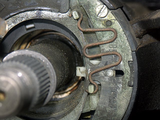

Okay, here is the column picture. The left directional is ON in the picture.
Can you tell if I am broken?? And, HOW does it cancel?
Click to view attachmentThanks,
Jeff
Air_Cooled_Nut
Jul 25 2006, 02:35 PM
You're not broken!! Typically, it's one of the plastic hooks for that squiggly spring that break. The semi-circular tab sticking out of the pictured steering wheel is located next to the steering column shaft and travels very close to that white tab you see sticking out at the 3 o'clock position (pointing to the column). You can take your finger or screwdriver and follow the inner circumference and push the white tab (it see-saws, you don't push it towards the 3 o'clock direction) to cancel your turn. In your case as pictured (turning left), you would sweep in a clockwise direction as that's the same way you'd be turning the steering wheel once you made your turn and were straightening your wheels.

Jul 25 2006, 02:37 PM
The piece (I don't have a pic) that attaches to my hub adapter catches the white plastic part when the wheel comes back to center.
Mine is only self canceling on one side so I will have to play with mine some more to get it working right.
Yours looks ok to me, but I am by no means an expert.

Looks like it could use some cleaning in there
If you have to remove it, whether to replace or better clean, it's pretty easy. The four screws you see there easily remove, then you pull the signal assembly out. Oh, under the steering column you need to remove the electrical plug as well. Very similar operation to that of an air-cooled VW (just did this to my VW on Saturday). A shop manual should give additional help...I'm probably missing something since I'm going by memory, but it is really easy to remove/replace.

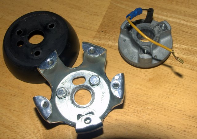

Also, to end this, I hope, here are the pieces of the adapter:
Click to view attachmentThe piece on the right goes under the black piece. Is that an original Porsche
piece?

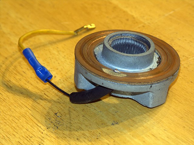

The other side of it looks like:
Click to view attachmentAs you can see, there is no cancelling thingie! Can I possibly buy another part
to replace it? The wheel is a Grant's aftermarket steering wheel, and I like it!
Thanks,
Jeff
John
Jul 25 2006, 11:42 PM
It looks as if someone had modified your adapter. It appears that they epoxied a fabricated horn ring to the splined aluminum part. I can see from the pictures that it has 3 threaded holes in it.
Those holes were to be used to mount the late model horn ring/cancelation tab from the original late model steering wheel.
You may be able to fabricate a cancelation tab from some sheet metal and epoxy or otherwise mount it to the aluminum splined part.
All the cancelation tab does is pivot the small white protrusion that you took a picture of earlier in this thread.
You may try to find a late model, broken but otherwise complete (with horn ring and cancelation tab) original steering wheel. I would be surprised if an old ratty one would bring much $.
Post a WTB add in the classified section. It would be by far the easiest solution.
Good luck with it.

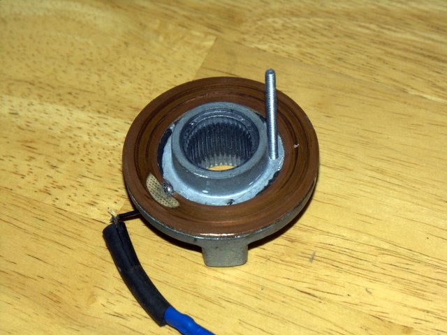

Jul 26 2006, 12:32 PM
I decided to try a fix on my own. I found a long 6-32 screw from a sheet rock
anchor. I drilled a hole in the inner mount, and inserted the screw:
Click to view attachmentThis works, but is not quite right yet. I put it in so it would align with the
part I need to hit to cancel the signal. But it does not align quite right As
one of the others showed, it is better to have a piece of sheet metal in there
todo the cancelling. Since I don't have that, I may just add another screw
spaced a little way away from this one to cancel in the other direction!
Anyway, it was a fun project, cheap for once, and may keep me from
wearing out the battery if I forget the lights are on!
Thanks for all the help and pictures!!
