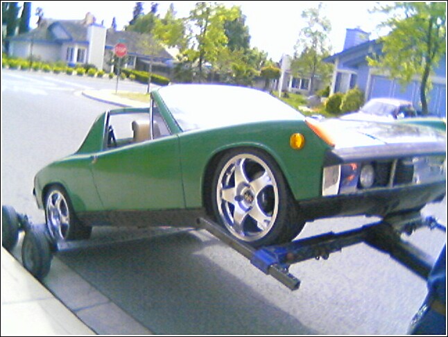

Lost a cooling hose today....
and all the coolant.....
Turns out it's REALLY hard to get the air bubbles out of the system on the side of the road.....

Yup.... have AAA. Thu guy was cool - a former 914 owner in fact.... He's working on putting a Corvette engine in an El Camino, and also a 300+ci engine in a baracuda or something - (I don't know american cars well at all...).
QUESTION:
When you V8 or other wassercooled people need to put a sharpish bend in a 1 1/4" hose... where do you go for fittings that have the bump on the end to keep the hose on....?

You can buy or even make a flanging tool to put a dimple in the end of a piece of tubing. Look in the Eastwood catalog, or search here for some pics of heavily modified vice grips.

I think the hose has just been working it's way off for a while... sucky but true - I need to flare the fittings so it doesn't happen again.

Like James says, modified vice grips work well. I modified a pair for my fuel line install (see my thread) and they worked great on the fairly thick stainless steel. Real beading tools are pretty expensive. Vice grips are cheap

Fiid, go to the hardware store and get a 3/4 brass ell and two 3/4mipx3/4barb fittings and sin no more....also please give Greg 5 bux for me for my NARP racing sticker...I'' pay you back...I promise....I know I'll see you before Greg...I won't be at the bkfst because of Lyn's surgery. JIm

You can get a 90 degree aluminum 1 1/4" elbow from Renegade. It's welded at 45.
A few of us watercoolers just bought an Earls 1.5" beading tool for ~$75. The smaller dia tools are cheaper...

I double clamped the hoses. Two clamps at the ends.

yep, the ol' vise grip trick is what i used too. copper pipe.
the hose i did have come off was at the bottom of renegades aluminum barbed filler unit.
barbed or flared? i'd go flared IMHO.
