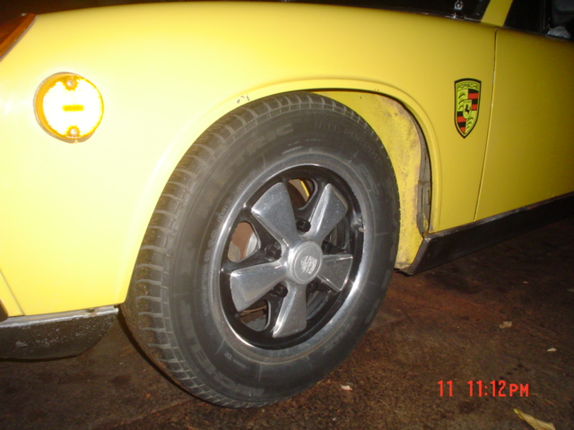

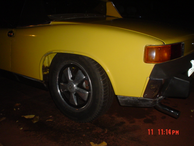

I went the easiest and cheapest route and bought some wheel adapters.
Cost me about $200.00 with the empi repro lug nuts. 14x5.5 Fuch's with 1 inch wheel adapters. Better pic's in the morning.
Click to view attachmentClick to view attachment

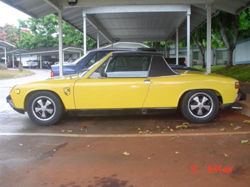

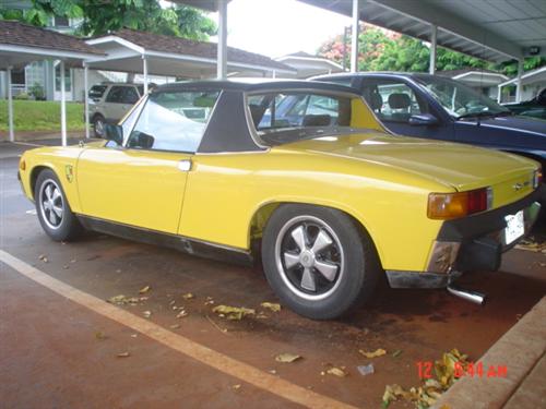

Click to view attachmentClick to view attachmentClick to view attachmentI have a friend that has a yellow turbo charged Meyers Manx that has run 10 second quarter mile times. He is running adapters going from VW wide 5 to porsche 5x 130mm. Been that way for 15 years. His buggy is scary fast and feels more like flying than driving. I'm pretty sure I'm safe in my 90 horsepower 914.
Adapters never looked so good....IMO. I also have the option of going back to my 4 lug Fuchs when the mood strikes, Options are wonderful!

Aug 12 2006, 01:08 PM
QUOTE(Flycut @ Aug 12 2006, 12:03 PM)
HUGE differance between a 5 to 5 adapter and a 4 to 5 adapter...no comparison, don;t even go there
that being said, the cheesy 4 to 5 adapters do "work" just as long as you don;t have any plans to auto-x or track your car...they are not allowed by most organizations...........
