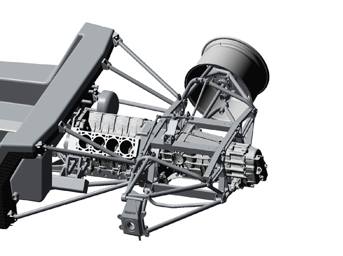

Chris, the subframe would have to go further back to attach/support the transmission...similar to this:
John
