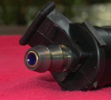

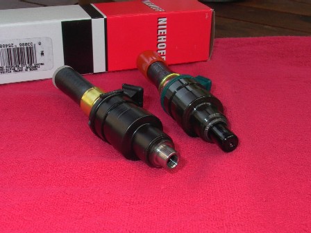

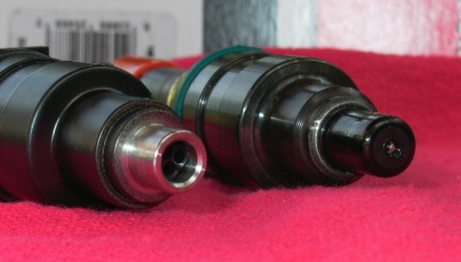

So I ordered them, and they came yesterday. They have a different type nozzle, or at least 3 of them do. It's a stainless steel chimney, with a triple nozzle, below which sits a single valve. I poked around on the internet, and the closest thing I could find was a GM-Rochester (I guess that's Delphi now) ball design valve that came out in about '96. Supposedly to reduce deposits.

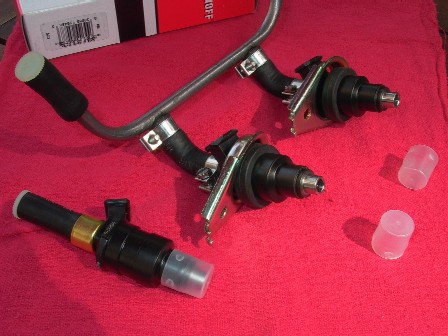

So I was cutting off the crimped-on straight hose to install my elbow hoses, and when I got to the the last one, I found it was the same old style pintle I'm used to. Same part number, different design squirty-end. So I called Niehoff. Their tech guy confirmed a running change to an improved valve design to improve atomization and reduce deposits.
I've gone this far, so they're going in the car. I called PartsAmerica, and they went through the warehouse and found both types. They're sending me another one of the new type, so I'll have 4 that match. The Niehoff guy said that it's not necessary since they all flow the same, but I want all 4 of the same type....
