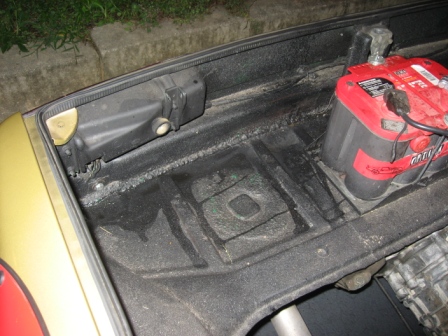

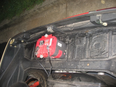

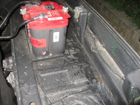

Well, I disagree and here are the pics to prove it...
--Jason

Are you positively certain that came from inside the battery?
If so, what voltage are you feeding that battery? Are you sure?

Could the muffler underneath have raised the temp of the battery excessively? Is the muffler heat shield still installed?
D1A3
The car is actually ShadyGrady's here on the board. I broke two motor mounts Friday night on my car during the SEC2006 drive and he let me continue with his track car...
The pics were taken that night when we arrived in Helen, GA (1.5 hour drive). We suspected an overcharge, but it is still being investigated. Fortunately Lewis Broyles brought a spare battery with him when he brought my car up the next morning, so Grady was able to run his car on the SEC drive.
I always here "Optima Batteries DO NOT leak." Well, in some cases they do...
BTW: Battery acid was all over the trunk lid too. We know it was acid becuase the battery was soaked and the fumes were horrible.

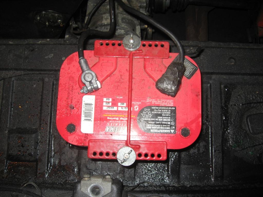

Top view. You can really see where the leakage occurred through the vents. Also, the battery had a sticker on the side that says "Non Spillable."
