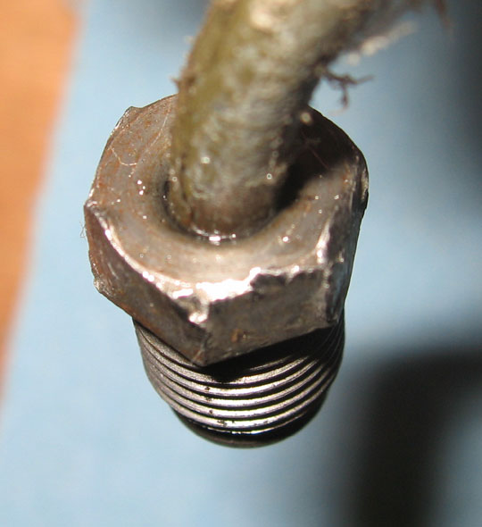

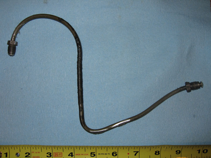

Here's a picture of the old line
And here's a close up showing the crack

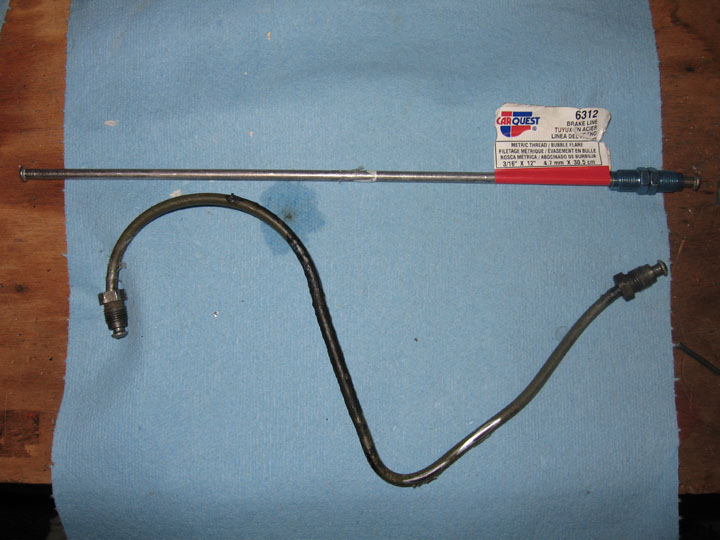

I called 6 auto parts stores in Palo Alto and none had metric brake line in stock. Carquest, however, said they had it in Sacramento and could have it here by 3PM.
My old line was 15in long, so I bought a 12in and a 20in length from Carquest. Here's a picture of the new 12in line. The barrels on the ends have 12mm rather than 11mm nuts and are a bit longer.

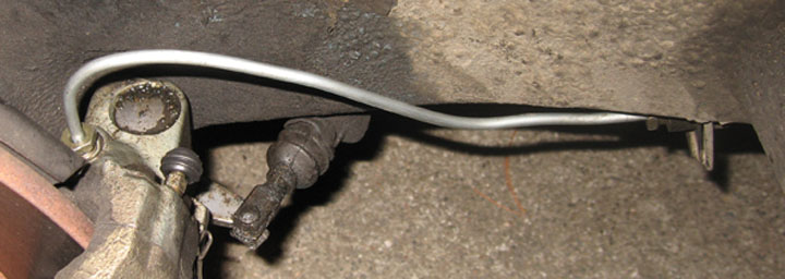

After a bit of bending the 12" line fits perfectly. Here's a picture of the finished line on the car. Bleed the brakes, put the wheel back on, and its ready to autocross on Sunday.

Looking at the picture, part of the line is shiny. I wonder if it wasn't rubbing a bit on the tire (perhaps under hard cornering) causing vibration which in turn lead to a cyclic stress concentration where the tube contacted the top of the barrel which in turn lead to a fatigue failure.
