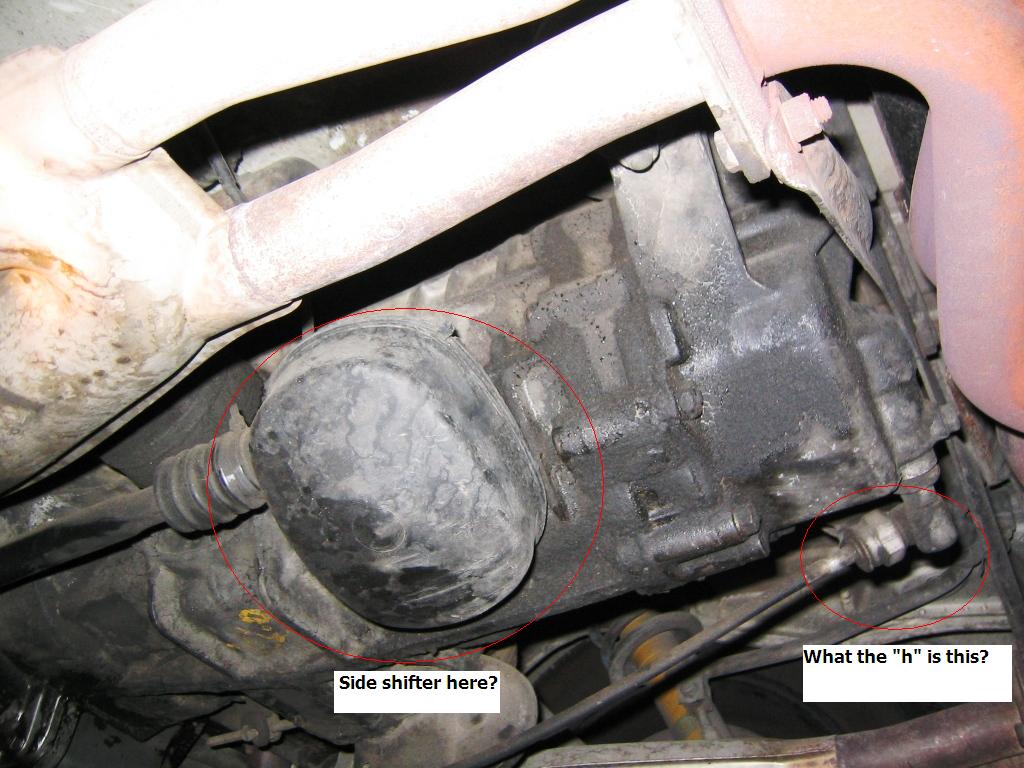

so, i hiked up the skirt of my 914 and shot a couple pix. looks like a side shift to me, but what do i know?? please tell me if i'm right on, or if i should lay off the crack pipe. if it is a side shift, what is the secondary set of cabling to the rear of the tranny?

Side shifter indeed.
Other do hickey is your speedo connector. Don't loose it its a spendy chap to replace.

QUOTE(knilfer @ Sep 14 2006, 10:52 PM) *
Yep, side-shifter, and that is your speedometer cable.

Actually it's nice to see the stock cover and boot still there for the shift rod. Most cars are not so lucky sad.gif

IanStott
I need that plastic cover and holding strap. I thought doo hickey has 2 o's.

Yes and speedo cable and you need a Haynes manual.
Dr Evil
Yup, you need a Haynes manual. If you have all of the original stuff on the tranny it may mean that no one has attended to the upkeep of said tranny ever. Sooo, check all the usual things for condition: oil, bushings, cone screws, etc.
