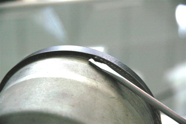

The bezels and glass come off by gently prying the folded edge open with a small scewdriver.

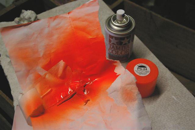

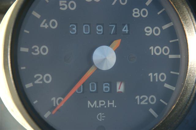

I used Tamiya Colour PS24 Flourescent Orange, the paint they used for RC car bodies. It has a nice matte finish.

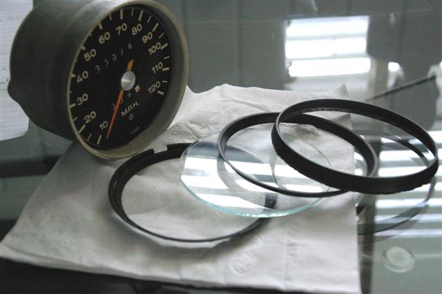

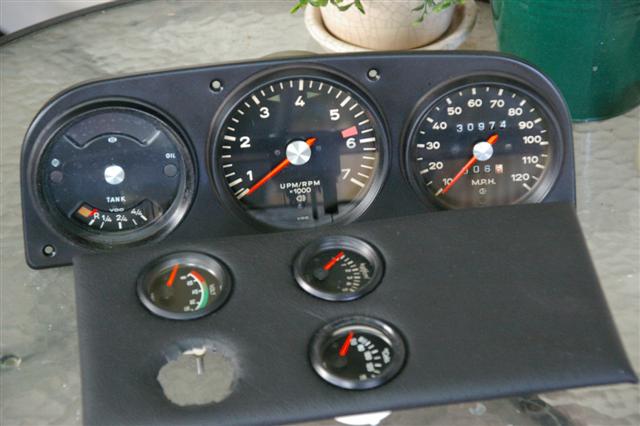

Use a good streak-free glass cleaner, and watch for fingerprints on the black gauge faces - they're a bitch to get off evenly. The Bezels come apart on the dash gauges - one piece under the glass, and two (or three) pieces above. I used a satin black for those - and the dash panel too. Put it all back together and gently bend the bezel back around the gauge body.
