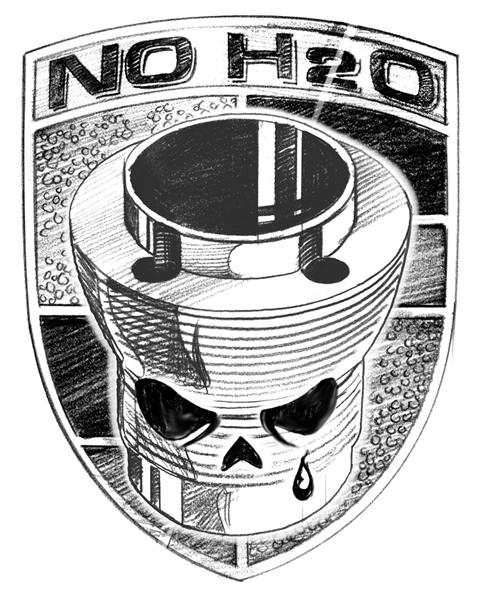

Jake Raby
Nov 9 2006, 02:35 PM
This is a perfect place to unveil the prototype for my new registered trademark...
It pretty much says it all... The full color version is almost completed.. It'll make awesone T shirt...
Jake Raby
Nov 9 2006, 02:36 PM
Click to view attachmentClick to view attachmentThis is a perfect place to unveil the prototype for my new registered trademark...
Brad Roberts
Nov 9 2006, 02:54 PM
Ha ha.. you where a Marine huh ??LOL
Lose the eyes with tears and you have a winner!
B
Brad Roberts
Nov 9 2006, 02:55 PM
Now I see the skull!
thomasotten
Nov 9 2006, 02:58 PM
It looks like he's got a tear drop of water coming out of his eye.... lamenting the extinction of air cooled engines? Reminds me of that Indian in those pollution commercials.

that's not water.....it's OIL

Like the man said, "I'd buy that for a dollar!" Lookin' good...

Jake that logo needs to be put on a bowling (or mechanic's) shirt. That'd be worth at least a couple of dollars.
