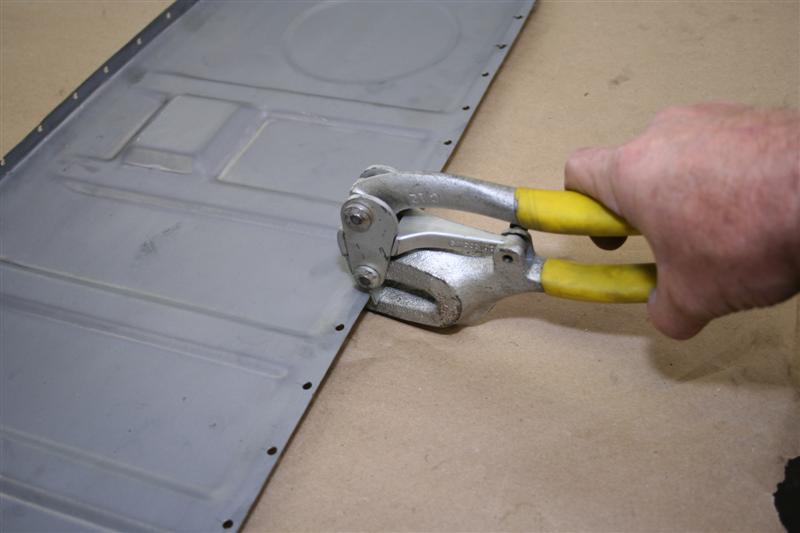

The method I used to replace my floor pan and longs was to use a hand metal hole punch (available cheap at Harbor Freight ) and punch holes around the edge about 1" apart, plug weld with mig welder and seamseal the edge. Worked well for me.

Rear trunk replacement......Holes punched, plug welded in place
Click to view attachmentClick to view attachment

QUOTE(PRS914-6 @ Dec 4 2006, 08:29 PM)
Click to view attachmentClick to view attachmentAKA whitney punch.
