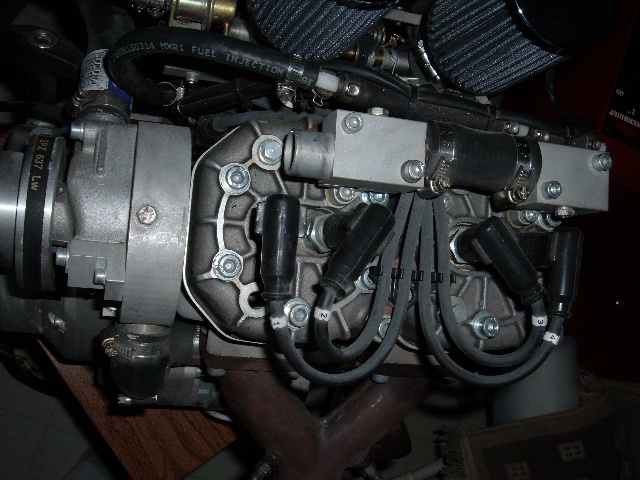

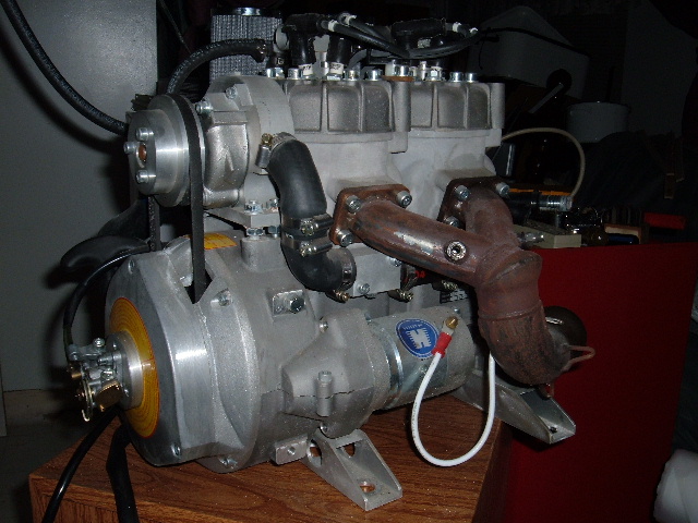

I thought I would share with you all my airplane's engine. This is the German Hirth Motoren model 3503 aircraft engine. Forged 4130 chromemoly crankshaft, AlNicasil lined cylinders, Forged slipper pistons, and sand-cast case, cylinders, and heads. Electronic FI with manual mixture adjustment override, and mechanical oil injection.
This engine in carbureted form is a 70+ HP engine (650 cc's)
My engine with all the bells and whistle is around 95 HP....

Click to view attachmentHere is the twin plug per cylinder ignition:

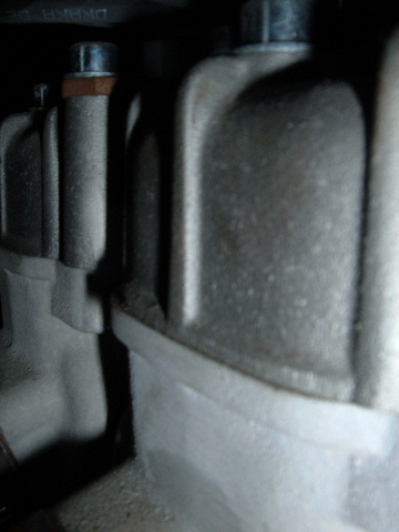

'nuther side ---
The castings......

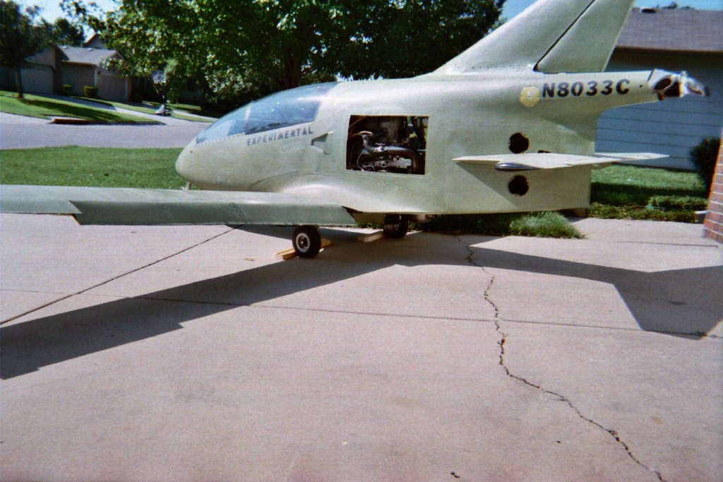

URY914
What kind of bird does this go in?

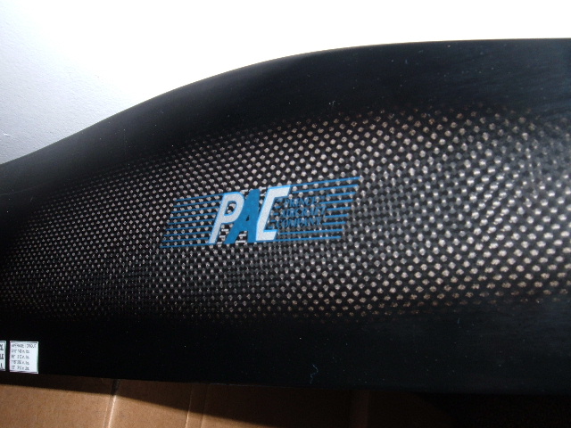

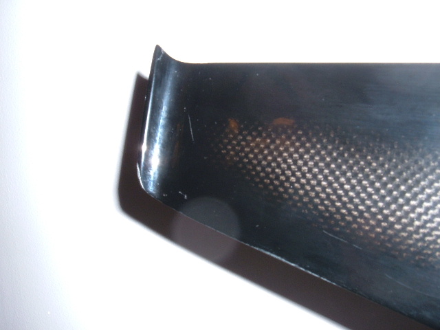

For you carbon fiber addicts: wub.gif
Here is carbon fiber at its finest level of quality:
Solid Hard Rock Maple coring, 8 layers of silky carbon fiber, anti vortex droop tips ----

It goes in this:
This is my BD-5 - I am still building it, hope to fly it one day...

A 2 cycle engine in an airplane? Do you have any way to change the plugs in flight when they foul? biggrin.gif
