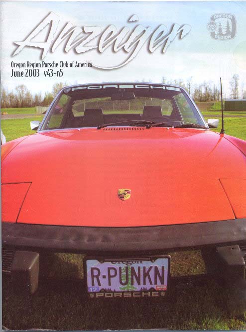

When I installed mine I measured on my friends assdragger, its a 74. From
the nose of the rubber top to the bottem of the crest is 8-3/8". I couldn't
remember so I went out and measured it. Sorry no pic of mine so heres a
generic.

Mine's an inch and a half to an inch and three quarters from the edge of the hood on the rust bucket. Can't get a pic since the hood ain't on it.

I lined mine up with the top of the inner edge of the eyebrows. It seemed to be the only place wher it looked right.
I 100% agree - tape it on.

Honestly,
I think the location is dictated by the location of the underhood reinforcement.
If you try to mount it close to the front edge, you have to not only drill the hood but you have to drill two larger holes in the inner hood reinforcement to attach the speed nuts.
Lazy man says, move it up so you avoid the reinforced boxed area and...
Voila, you are at the location where 90% of the people place theirs.
Ken
