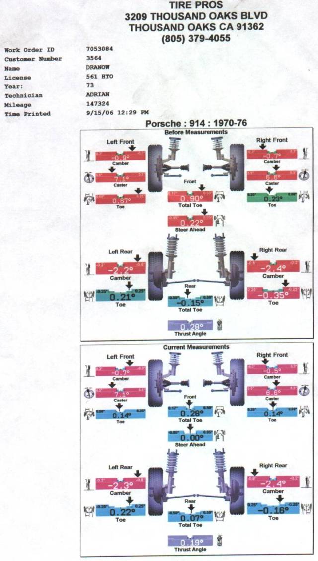

Tony, there's a guy out here who charged me $75 for a complete 4 wheel including thrust. Really fancy equipment. Neato printout.
