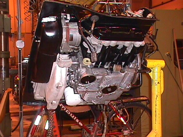

Small round plate at the corner of the case at the bottom of the engine. Dosen't
take much to strip those bolts that hold it in place, careful when reinstalling.

Your '72 will not have one unless a PO put one there. Yours will be a solid plate.

Your right I have a solid plate with two bolts holding it in place. Should there be a place to thread the sender in or do you remove the plate and there will be a place to thread the sender in under that.

you need one that has a nut welded onto it, and has a different shape to run an oil temp sender.....
