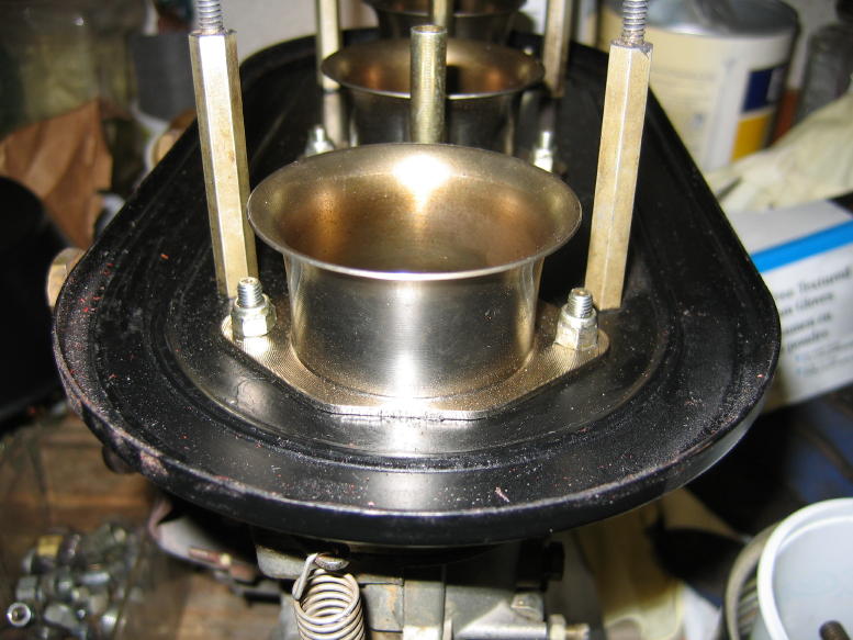

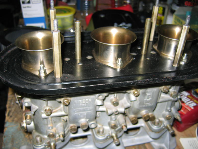

I noticed that that air filters on the 46mm carbs for the 3.0 are shorter that the ones I had on the 40mm carbs on the 2.0. While investigating I also found that the velocity stacks are shorter. What, if anything does this do? should I look into replacing them with taller ones?
Click to view attachmentanother shot, don't have pic of the other for comparison...

It all depends on the VE of the motor.
Overall, taller stacks = more low end torque
Shorter = more HP in the higher rev range.
Again...this depends alot on the Volumetric Efficiency of your motor, the cam, the heads, blah blah blah...
So, I would suggest that you dont change them if they came with the motor.
Rich
Phoenix-MN
Mar 21 2007, 02:32 PM
I think the shorter stacks and filters were made for 911's with A/C. It may not make much of a difference if you are using them on a street engine.
Others chime in if I have it wrong
Paul
drgchapman
Mar 21 2007, 02:35 PM
Jake Raby did the definitive study on this issue a couple of years ago. Check the archives.
