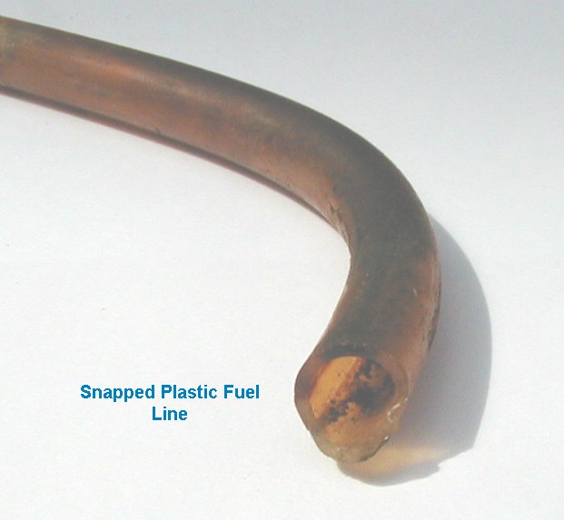

So I get everything loose and get ready to pull the lines and had to pop
the plastic lines out of the plastic keepers on the firewall, and CRACK,
the return line shattered and cracked right where the line starts to go up
towards the engine shelf.

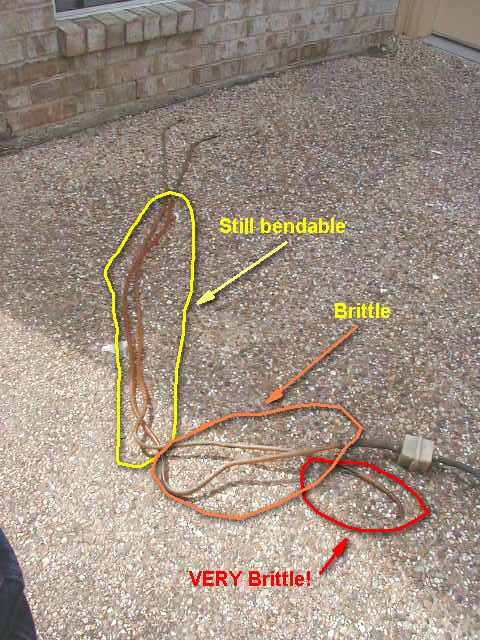

After I pulled the lines, I carefully examined them and noticed that the plastic
inside the tunnel seemed to still be soft and bendable; however, the plastic
beyond the firewall in the engine compartment was very hard and the closer
you get towards the corner were the heater tube is, the more brittle the lines
get.
In my situation, the more brittle line was actually the return line which would
be the absolute worse line to break since the pump would continue to pump
fuel even after the line broke.
Anyway, I have attached some photos showing what I noticed.
